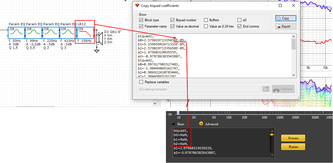

Maybe I asking for something, what is solved yet but... I have problem with copying/exporting biquads to miniDSP interface from VituixCAD 2.0.85.6
Problem is with formatting the number when exporting biquads for LRx filters - to frequency 307 Hz is copied text (via button in VTX, also CTRL+C) like prt src below:
When I change frequency of filter to 308 Hz (doesn't matter on slope) is everything OK. Do have this kind of problem anyone else?
It can rally move your woofer cone, if you miss this "mismatch" and paste it to miniDSP (at least in my case).
