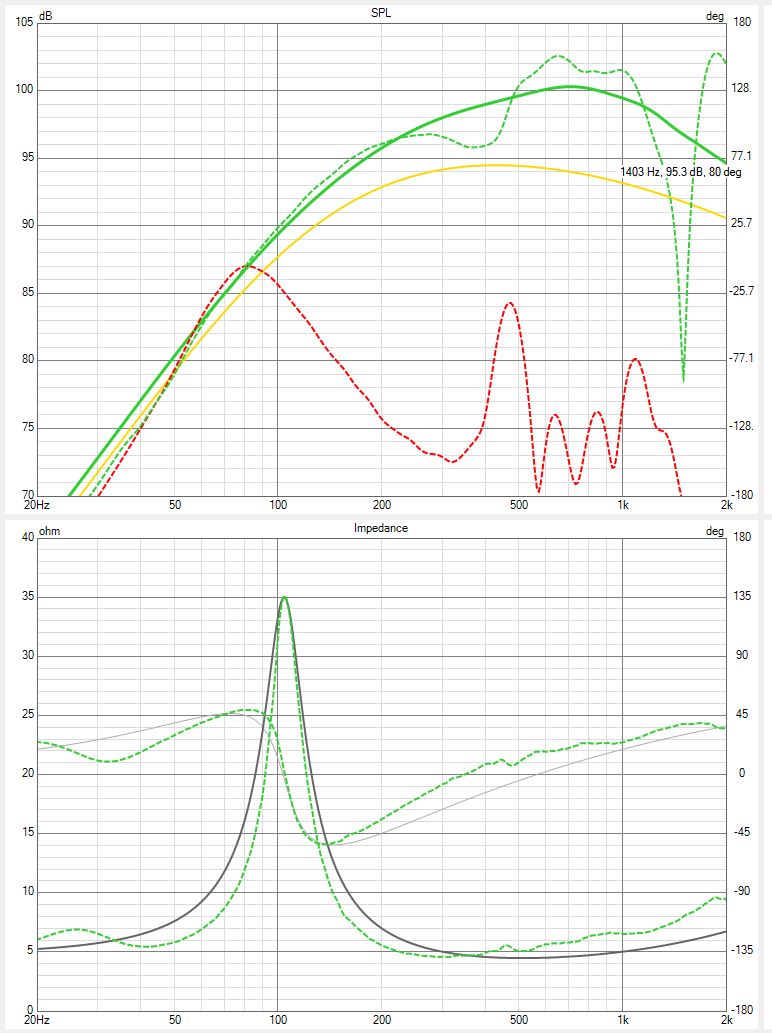

Hi Kimmo,
While trying to match bas reflex simulations to measurements I encounter a problem;
I cannot match the sims with the measurements because the ports are on the rear of a large cabinet.
I have performed farfield @4 meter (outdoor) and nearfield measurements of the cabinet.
When I add the nearfield measurements together I get a good match with the farfield measurement if I account for the time-of-flight delay in REW.
I can get a perfect impedance and cone respone / port response match in Vituixcad in the enclusure tool, but not a good matched total SPL response. The simulated total response is the same as when I add the port and cone measurement in REW without accounting for the time-of-flight.
Do have have a solution or workaround for this?
Thanks,
Kees
..and sime screenshots to show results wirth ports closed and ports open

In calculator tool, function A+B (port +bass nearfield) do you fill number for time delay for port? If you play with delay number for port, you can see how different total spl could be.
Thanks for your reply, I know about that functionality (I did it in REW but is the same).
The nearfield, corrected, measurements line up perfectly with the freefield distance measurements, but I cant get the sims to line up.
I would be nice to also have the option in the enclosure tool (or a workaround)
the reason I want the sim to line up with the measurements is that I would like to be able to get insight in maximum excursion and port velocity and power
At the moment Merger tool does not have delay parameter for individual LF responses. That would work okay to listening window, but effect is opposite to rear sector so it's not the best approach for merged off-axis responses. The same problem exists if summing is done with Calculator and simple delay. Z mm parameter with 3D geometry calculation is needed to improve whole 360 deg sector.
Unchecking BS checkbox of individual LF response in Merger excludes baffle effect response so that's another cheap thick to reduce excessive level at high bass if port is not in front panel.
The best workaround VituixCAD supports at the moment is using main program to sum acoustic signals of separate cones and ports located around the box because it's the only tool able to sum responses in 3D space using geometry calculation and response interpolation.
1) Create separate response sets to full space (in hor and ver planes) for cone(s) and port(s). This is done with Diffraction tool: near field measurement of the cone/port is loaded to Half space response text box, and off-axis responses are exported with Directivity option. Each radiator must have own on-axis i.e. mic is located in the center point of each cone/port.
2) Driver is created to main program for each cone/port radiator. Response sets are loaded to drivers. Vent responses should be scaled with radiating area compared to cone.
3) Separate radiators are added to crossover as driver instances in parallel. Driver instances are located with X,Y,Z,R,T parameters how they are in real cabinet. Cone is at the origin XYZ=0,0,0 mm, and vent(s) for example XYZ=0,-300,400 mm, RT=180,0 deg.
4) Total response is exported. This is new total LF response to far field which is merged (with Far field option) with actual far field measurements or responses already merger with standard procedure. Blending frequency should be quite low and range wide e.g. 2 octs. to merge phase and directivity smoothly.
BUT all this is not really mandatory. Power response plot is okay no matter delay and location of the port. So designing flat power within and below predicted transition range works fine no matter small error within listening window. On-axis may show minor bump where cone and port signals are crossing. Ignoring that and looking power will give proper result.

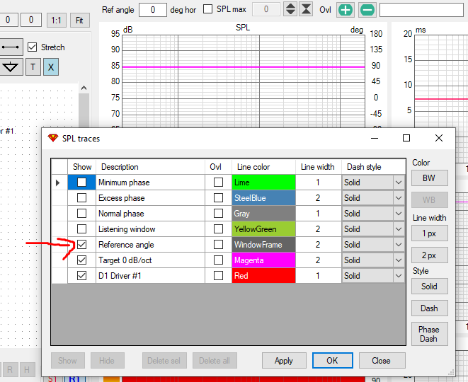

A very simple question, probably already asked before, but: is it possible to deselect the summed response function, while using two or more drivers in the x/o schematic?
I would like to make overlays of various individual active response shaping circuits in order to compare those. Having to deala with summed responses mucks up the whole idea.
