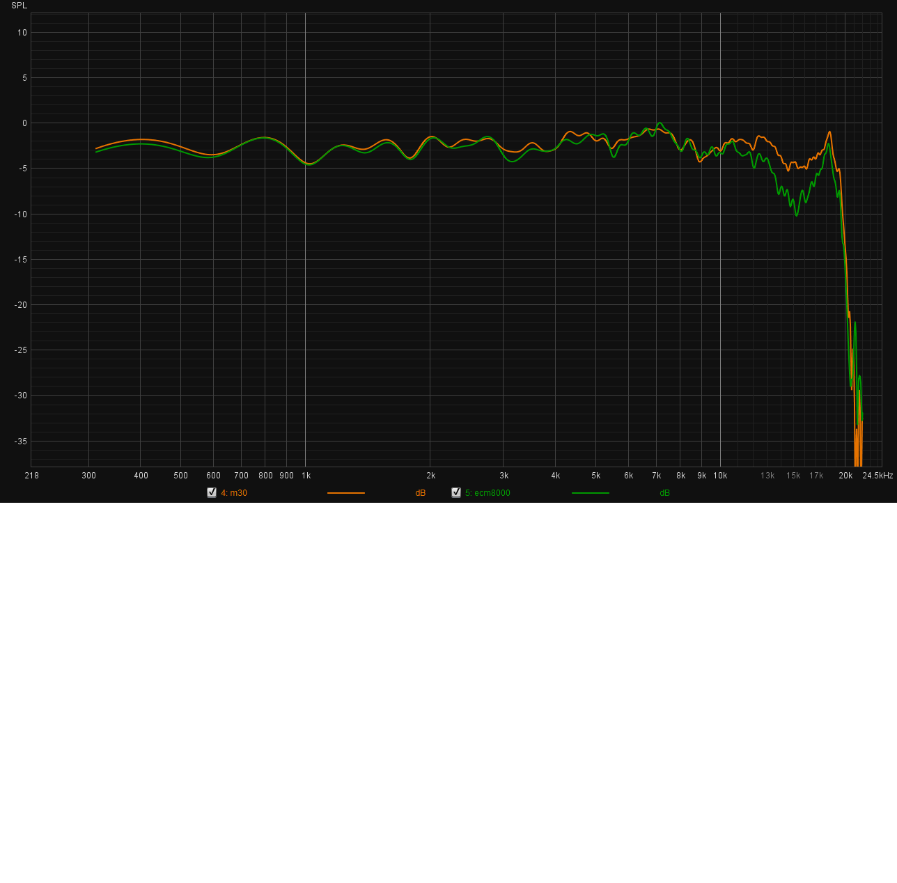

here's a comparison of the earthworks m30 and emc8000 that I bought in 2012. both with no cal.Thank you for your input!
I created a new thread here to sumarize the information i got in this thread, and to avoid polluting this one.
I decided that i'll go with the ECM8000 and will use the CSL Umik-1 to calibrate it for now.
there is some difference in the very low end Aswell .
