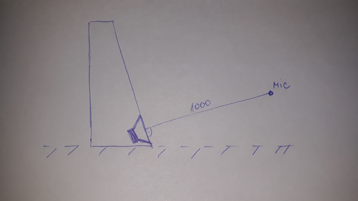

what should the procedure be for the bass driver?
Excellent questions.
Some simplified theory: Due to very low position of woofer, shape of woofer's frequency response is maintained to about 1 kHz without floor dip at normal listening distances. There will be quite normal baffle step at far field due to horizontal baffle loss, but sensitivity of radiator is probably 4-5 dB higher than in free field because of floor reflection.
There are couple of possibilities to measure and process the data. This one is probably the simplest, but I don't design that kind of concepts due to experiences from some diy designs few decades ago so I can't say is it the best and most accurate for sure.
Far field: Keep mic at elevation where axial response (hor 0, ver 0) of woofer is captured while measuring hor 0 deg response. If woofer is tilted up, mic will be a bit higher from the floor than center point of woofer. This captures possible cone break-up which should be included in measurement data to enable compensation with XO.
Measure 0-180 deg in horizontal plane only. You can measure also positive verticals +10...+170 deg if mic is possible to rotate over the speaker so that distance stays constant.
Near field: Standard method.
Diffraction simulation: Create baffle effect response so that virtual mic is at normal listening elevation e.g. Y=900 mm, and axis distance is 3000-5000 mm. Add virtual floor reflection below the speaker. Leave some gap to spikes if speaker has spikes. Attenuate virtual floor reflection by 2-3 dB. Export baffle effect response for Merger tool.
Merger: Standard method is okay because both far field measurements and simulated baffle effect response include floor gain.
Balancing with XO simulation: Axial response should be flat from mid bass to mid-range (without tilting up) because response data includes floor reflection. So anechoic response (without floor) in real life would have 4-5 dB lower SPL at low...mid-bass than simulation shows. This means that also power response in the simulation shows some tilt down from mid-bass to lower mid-range. (There should be clear tilt/step at crossover range if simulation has anechoic data for woofer).

Mic position like this on the sketch? And no gating, to floor bounce be included?
Yes.
Also this setup has floor dip which could prevent measuring cone break-up accurately. For example if center point of woofer is 130 mm and mic 300 mm above the floor, dip will be at ca. 2.2 kHz.
If dip ruins measurement goals, you can tilt speaker with "something" below rear spikes so that front baffle is vertical. Mic at woofer's elevation moves floor dip to higher frequency. Mic on the floor would be pure ground plane which is probably the best for measuring cone break-up though vertical angle is not exactly 0 deg. Anyway, tilting of speaker is not the easier method but might be needed.
Gating is needed for wall and ceiling reflections also with ground plane measurement. 6-10 ms depending on how far the nearest side wall is.

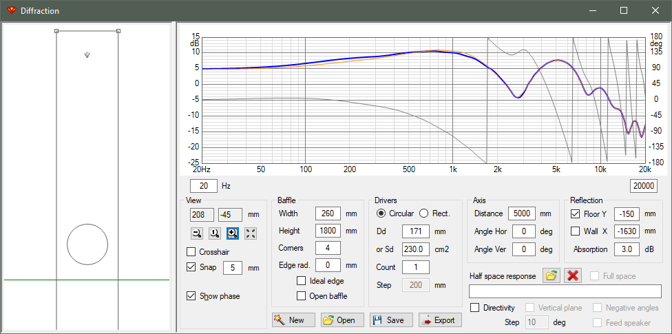

One trick how to create baffle effect response for speaker with single woofer very close to floor. Simulated baffle is about 2x higher than actual. If floor Y=0, woofer Y=150, mic Y=950 mm. Axis distance=5000 mm. Purpose is just to prevent baffle loss below the woofer because simulator does not automatically remove or invert diffraction of the bottom edge on the floor. Sunken edges are kinda mirror sources of diffraction.
Orange trace is normal with baffle loss below woofer. Difference is not radical.
