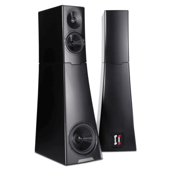

Dear Colleagues, I have a question about measuring YG Acoustics Hailey 2 style floorstanding speakers where the bass driver is located right at the floor. While the measurement of the tweeter and midrange is clear (measurements on the axis of each speaker), what should the procedure be for the bass driver? Should the speaker be raised to a height of about 1 m to take the measurement on the axis of the bass driver? What ideas do you have for the crossover design to "account" for the bass boost from the floor surface in typical listening? Maybe for the bass measurement the microphone should be on the axis of the tweeter, midrange, or maybe make an additional measurement of the pseudo ground plane with the microphone at the floor?
