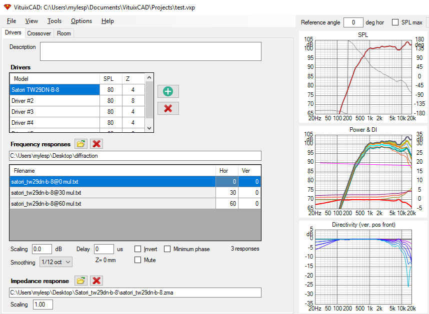

DI curve is perfectly flat
Hi Kimmo--
My DI curve (red) is perfectly flat. As much as I wish that were true, I doubt it 🙂. Can you tell me what I have done to seemingly disable DI calculation?
Thanks!
--Myles
Hi Kimmo--
Thanks!
--Myles
^Problem is somewhere else than in XO (though you have unnecessary wires between active blocks, PEQ at 39.6 Hz for tweeter and tweeter is not in the origin of speaker).
Most common mistakes are:
- File naming is not valid at all or was not compatible with settings in Options:Angle parsing from filename when files were loaded.
- All drivers listed in Drivers tab do not have response files for full 0-180 deg off-axis sector (or 0-90 deg for half space application).
- Response interpolation is on and drivers don't have adequate off-axis responses (and drivers are not at the origin 0,0,0).
- Driver instance in XO is not linked to response data in Drivers tab (this is probably okay is your case).

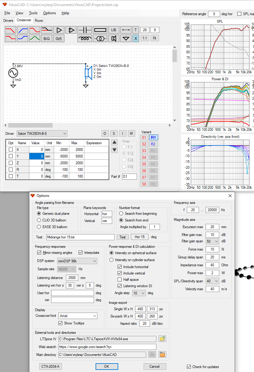

I think more helpful screenshots are lists of frequency response files:
and Options window:
Measurement instructions should help with file naming.
and Options window:

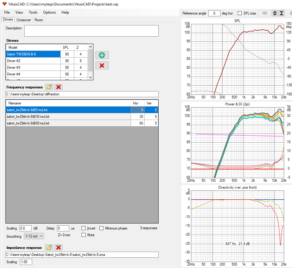

Hi Kimmo--
I cut down my schematic for debug, to just the tweeter. Here is what I found.
- When I uncheck "Listening window DI", the DI curve goes flat. I don't think this should happen. (I do think that I want to have that option checked going forward though)
- I did have a bug, but I don't think it was of my own making. My subwoofer FRD imported as -4* horizontal. I created the FRD by exporting it from the Enclosure Tool. So I have now set that to 0* manually in the Drivers tab.
With frequency responses to three directions only (0, 30, 60 deg) accuracy is probably better with Options:
- Interpolate unchecked
- Listening window DI unchecked
- Angle step 0 deg (measured directions only)
- Half space checked though it does not matter with previous settings.
These settings do not try to compose anything from close to nothing. Just use loaded data which is very poor in this case.

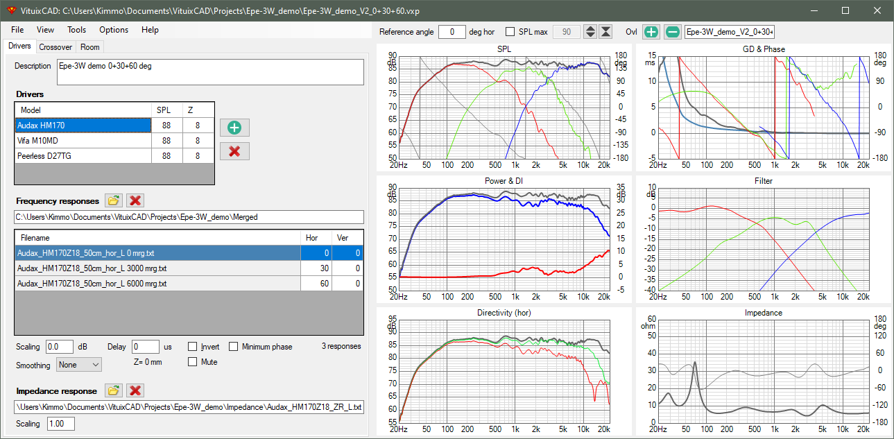

Software is functional with 0,30,60 deg off-axis, but those three responses should be loaded for ALL DRIVERS listed in Drivers tab in order to get power and DI results. Not just for middle and tweeter or whatever added to crossover schematic. I think this is also mentioned in measurement instructions or user manual.
In theory I could handle single response as omni, but it's not implemented that way for power & DI response calculation.
Here is one of my sample projects with 0+30+60 deg only.
I think it is important to assume that people will do simulations from data sheet... I can't buy all the drivers I'm considering, mount to IB and measure. I like to simulate from the data I can find, which is not always complete.
I have traced manufacturer's measurements for preliminary design just once within last 35 years. That was one the most unsuccessful projects in my history. Drivers were purchased and cabinets manufactured believing that traced data, woofer simulation and preliminary XO design tell something that I could trust. But manufacturer's measurement from compression driver and horn was total B.S. Almost anything is possible as active with DSP - with or without tracing, but passive filter was selected for that project.
Typically compatibility of drivers; USPL with baffle loss and directivity is possible to estimate without tracing. Just by looking data assuming that it's reliable. Some verification from multiple information sources is needed e.g. measurements available in the internet.
Accurate diffraction simulation would need traced response to 90 deg off-axis which is not available. Diffraction simulation with simulated piston directivity is not accurate enough for power & DI calculation. Simulated baffle loss to 0-90 deg or 0-180 deg could be okay, but it's not adequate for crossover design without measurements in final cabinet. Accurate timing differences are also not available with traced responses. Summary is that tracing is not needed, and it's too unreliable and inaccurate.
Very quick change to handing of single response loaded for driver. Hopefully this will not cause any trouble.

I'm still sorta new at this, so please don't hesitate to educate me when needed!
I'm trying to use pre-purchase simulation to answer questions like: Do I need a tweeter with a bit of horn loading to best match the off-axis response of this 5" midrange. Or should I be using a 4" midrange instead? Should I really go 5-way?? (4-way + SW) Etc, etc. I'm trying to squeeze as much juice out of the pre-purchase lemon as I can. I can't just order up 8 $150 drivers and measure them all and start experimenting (would be nice, but...). So I'm getting as much as I can out of HifiCompass, AudioXpress (some of Vance's tweeter measurements are suspect IMO), AudioExcite, etc. And spec sheets if all else fails. So I'm trying to figure out the best way to use the incredibly good VCAD to chase the various Spinorama DI waves.
What about the display of horizontal dispersion when I selected vertical, and there were no vertical inputs to the driver, except 0*?
Thanks Kimmo!
--Myles
Thanks Kimmo!
--Myles
- Do I need a tweeter with a bit of horn loading to best match the off-axis response of this 5" midrange.
- Should I be using a 4" midrange instead?
- Should I really go 5-way?? (4-way + SW)
One answer to all questions (without knowing details) is 'not necessarily'. World is full of 5"+1" and 6"+1" without wave guide or horn. Some are very good and some are not. Wave guide/horn can also ruin axial sound regardless of better measured off-axis.
Proper methods and tools enable very good result also with slightly oversized mid-woofer. Worth to remember that ideal directivity visible in spinorama does not define total quality: is speaker "just good" or very good and enjoyable to listen. Some drivers sound better and some worse, and better driver with slightly worse directivity and power balance could be significantly better. So buying and listening is also possibility to find an excellent product.
I don't prefer subwoofers so 4-way is maximum for me.
Basic guidelines for skipping vertical measurements is explained in measurement instructions, but finally this depends on motivation (laziness) of designer. I usually mirror measurement data from horizontal to vertical with circular radiators located to vertical center line of cabinet. Rectangular, elliptical and non-centered should be measured in both planes.
