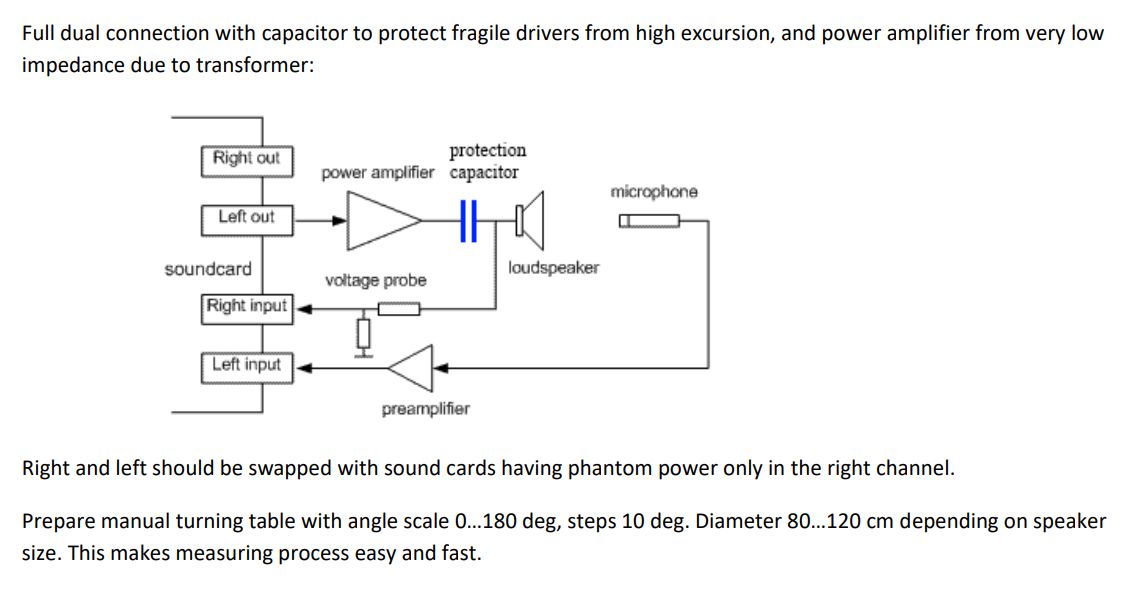

Thank you for your reply! I will follow your advice and re-read the manual and the instructions you linked. One question, when you say 'measure near field', you mean I have to measure the T/S parameters myself, right? In what condition should I measure it, i.e. do I put the drivers in the enclosure, or lay it on a table, etc?
I definitely have to dabble more with Vituix, this is a very powerful program! Thank you for your effort.
^No. Near field response is measured at 5-7 mm from the center of dust cap. Low supply voltage (-20...-30 dB compared to far field measurements) to avoid clipping of microphone and mechanical hitting.
Nothing is needed from driver manufacturer to produce measurement data for crossover design. Sd or Dd is needed for scaling in Merger tool and Diffraction simulation, but Dd can be measured with tape or ruler.

Class-D amp is a poor choise for measurements. In Canada for example this would be a good alternative
LM3886 Done Right: Best DIY implementation of the LM3886 80W gainclone – Neurochrome
Class-D amps do filter the RF they create in output, but generally not enough for this purpose and there is lots of it remaining to "confuse" the AD converter in your soundcard. In best case you get an almost accurate frequency response, but I would not trust the THD measurements for sure.
