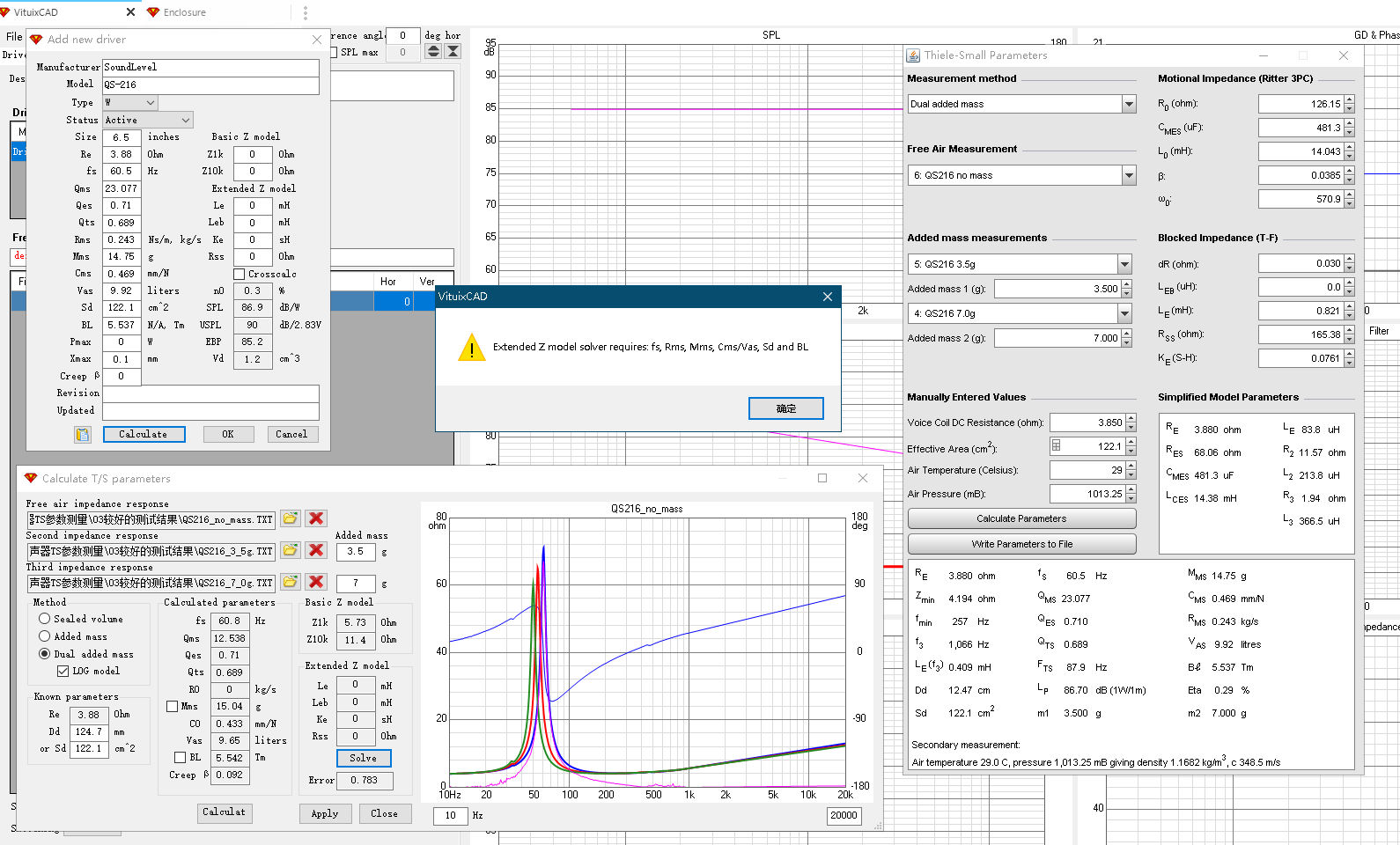

I tried to use the calculate T/S parameter function, I just copied and pasted T/S parameter values from REW, and calculate, and provided impedance data exported from REW, the software poped up an warning message, even after I input BL information.
Do you know why?
Is the current error value O.K.?
^R0=0 is not right and the reason why extended Z model solver refuses to start. Dual added mass method with sparse 1/48 oct. frequency steps is not necessarily very stable with very high Qms drivers. In that case I would use single added mass of 7 g if dual added mass fails.
I can try to get rid of R0=0 error if you send all three impedance responses by e-mail or attach to forum.

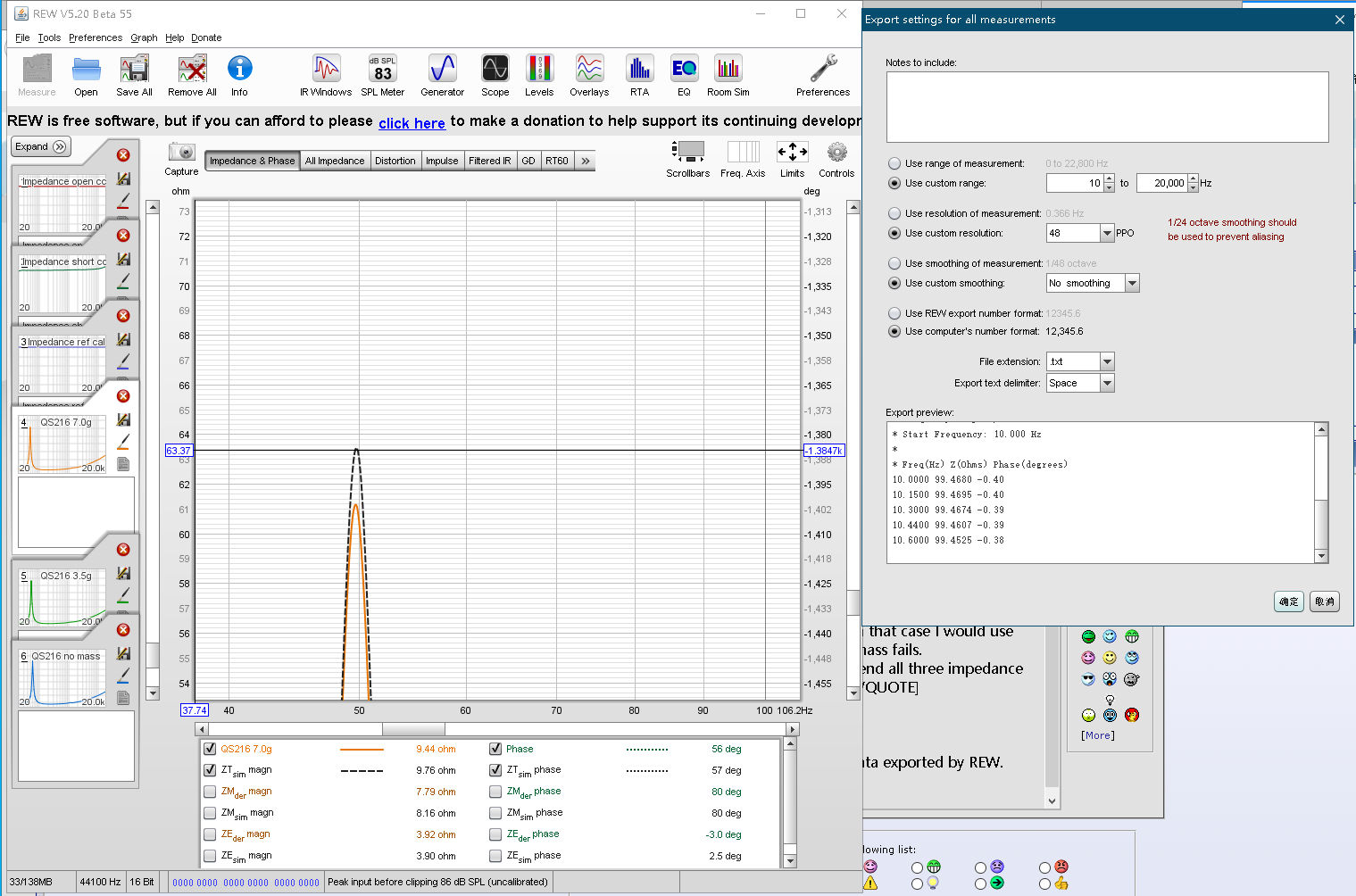

Hi Kimmo
I've attached the impedance response data exported by REW. Are thses what you need?
Export settings:

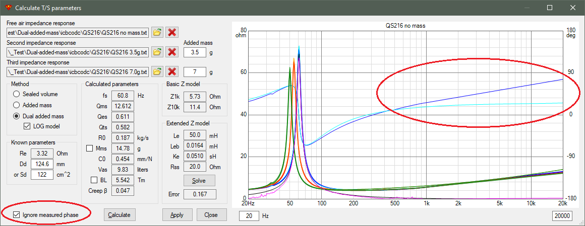

^Problem found. Magnitude and phase responses in impedance measurements do not match i.e. responses are not close enough to minimum phase which leads parameter solver to impossible situation.
See thin blue curve in attached file: measured free air phase response cannot rise towards 90 deg with that flat & shallow magnitude response. Or magnitude response cannot be flat & shallow at HF if phase response rises towards 90 deg. Phase response should be quite close to simulated cyan curve assuming that measured magnitude is more accurate than measured phase.
I added Ignore measured phase checkbox to program to get result, assuming that measured magnitude responses are okay. Parameters are solved by impedance magnitude responses only. Click 'LOG model' or 'Added mass' option few times if extended model solver does not give immediate result with error less than 0.200.
^Ignore my previous post please 🙂 Actual problem was comma as thousand separator in impedance response files. Thousand separator is not allowed with VituixCAD. For example 20000 Hz must be either 20000.000 or 20000,000. Not 20,000.000.
So this new 'Ignore measured phase' is not needed to get result, but I will not remove the feature:

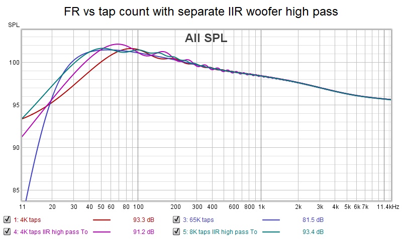

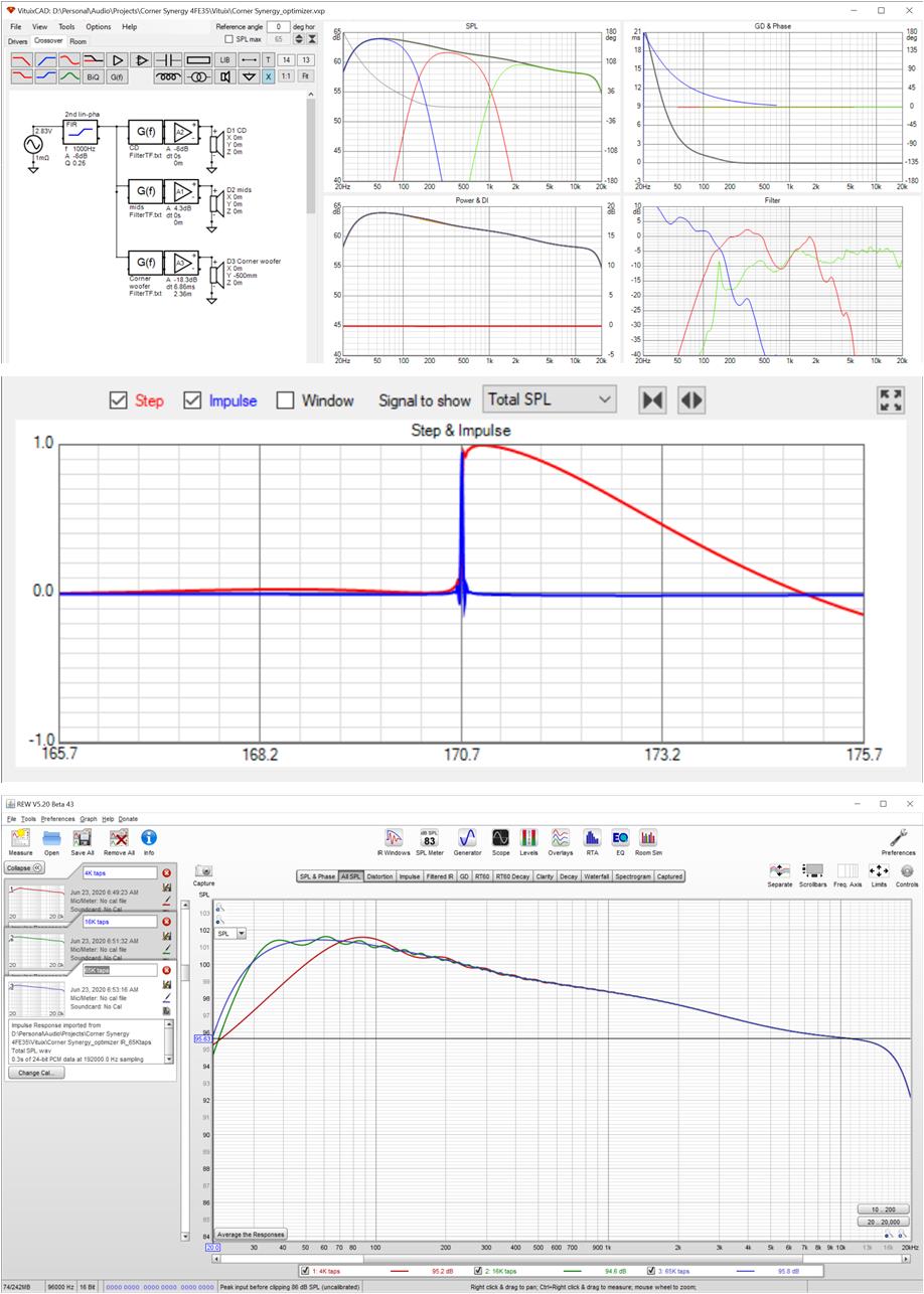

After I got the hang of it, I was able to get better results using TF mostly from working on woofer time alignment but it didn't help with tap requirements.
I imported IR(taps) into REW to evaluate. Doing this, I couldn't help but think how nice it would be if there were an (Save as Overlay) button right above the export button on the IR screen. The finite tap count FRs are plotted at 2 db per division so the error is not as bad as it looks
Taking the woofer high pass filter out of the G(f) and into a separate IIR block brought me about 1 db closer to the 65K tap curve in the 20-40 Hz region with 4K taps. 4K taps aren't quite enough; 8K looks great.

One possible trick is using Pre-delay instead of Center IR in Impulse response window. Program does not have as many time base options as rePhase, but pre-delay could be better option if IR does not have much pre-ringing i.e. phase linearisation is done at mid...high only.
Build of 2.0.51.6 with workaround for comma as thousand separator uploaded few minutes ago: If data row contains one comma (assumed in frequency value >= 1000 Hz) and three dots, comma is removed to avoid error in frequency value.
This is really quick and dirty trick, but almost only way to support automatically also comma-separated files in addition to space, tab and semi-colon separated files.
I might have mentioned that localized exports are very unfortunate because txt, frd and zma files are data files in this scene and should have invariant culture formatting - just like values in xml files. Programmers should take care that their program does not export localized value formats in data files no matter settings in control panel of operating system. Otherwise this format mess will never end.

This kind of settings (Use computer's number format in REW export menu) is optional in REW, but I don't know which one is better just follow the sample picture settings in REW help file.

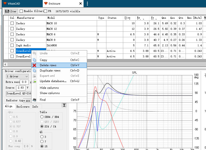

I encouter another problem, the "Delete rows" function is not working when I delete a speaker row in Enclosure window.
BTW, how can I estimate the value of Error in calculate T/S parameter window?
That could be good or bad. Better to select fixed global setting to make files interchangeable overseas i.e. 'REW export number format'.
Select full row(s) with row headers (gray squares on the left) to delete rows. Whole row in blue and then delete. Finally save local driver database.

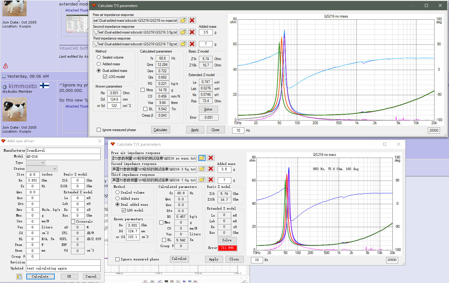

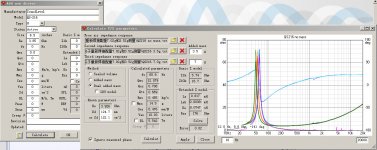

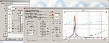

I see your simulation plot and T/S parameters calculation value, the Error is only 0.05, looks very good.

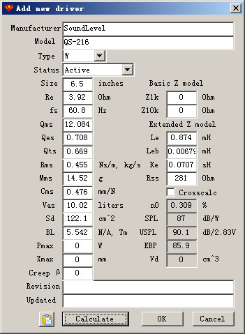

I looks like you are using my uploaded impedance data,but I can't get the same result like you.
Sorry for my poor English, is there anything I didn't understand clearly?
Please check the process below, I just input Known parameters, and press calculate, Error value is 711.996 too high.
Re value in "Know parameters" should be input as the same one as voice coil DC resistance measured by me?
Thanks a lot for this software. I did design in the same procedure even without this information. It means, that it is quite intuitive and that is perfect.Simulate box & driver with Enclosure tool, export Total SPL, start Diffraction tool, design box and locate driver, select previously exported Total SPL to Half space response text box, check Full space, export and feed polar responses to main program with Directivity and Feed speaker checked. Abracadabra!
It's not direct but doable.
But next steps are not so clear, please explain...
Solving of parameters is very close to lottery especially with Dual added mass + LOG model. Solver could find good result if initial values are good. That is not always the case so calculating initial parameters with (single) Added mass method or without LOG model or ignoring measured phase could help significantly.
Possible methods to restart solver with Dual added mass + LOG model:
a) click Added mass option and then click Dual added mass option
b) uncheck LOG model and then check LOG model
c) check Ignore measured phase and uncheck Ignore measured phase
Repeat until simulated responses match with measured.
Note! You don't have to use Dual added mass with LOG model if target is just to simulate box. Fancy T/S models have some significance in R&D, but common diyer does not need very accurate parameters for purchasing drivers and designing box.
Parameters of Extended impedance model i.e. Le, Leb, Ke and Rss must be solved or entered to get small Error. Zeros give always high error.
Yes. Dual added mass method solves also Re, but it's good to know before parameter calculation.
Please download and install 2.0.51.6 again. The latest build has some improvements: Solver for dual added mass method starts with Qms=8.0, R0=0.3 and Re=4.0 when new driver is added. In addition, max. 9 automatic restarts added if error is greater than maximum (1.5). Should give acceptable result by entering Sd only - without manual restart tricks.

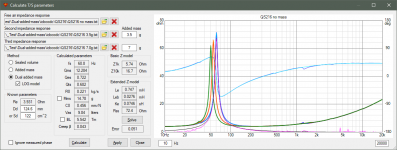

Thank you Kimmo.
in step a , I just click Dual added mass option , and the values changing.
Follow your instructions, I get a good Error value like this. It's tricky, deep and interesting.
Do all these mean my measurement is good enough? and the T/S parameters are also good enough?

Shouldn't be tricky at all with the latest build. Result at once by entering Sd. Also with LOG model and measured phase.
Do all these mean my measurement is good enough? and the T/S parameters are also good enough?.
I just want to make a good box for QS-216 speaker.
Evaluation of accuracy of measurements is impossible from here, but looks good enough. I'm also saying that designing "good box" producing good sound reproduction is usually something else than knowing exact T/S parameters and getting some textbook response in the simulation.
