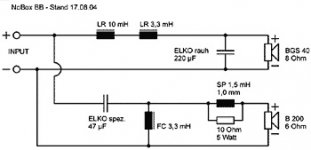

I am firstly planning to upgrade nobox kit cables with dh labs t-14 . And later i will upgrade the capacitors and resistors.How about the quality of this kit's crossover ?
I didn't buy the kit, I came upon these drivers separately and picked them up secondhand. The 15" were new and the B200's were slightly used. The schematic was given on The review site and the dimensions of the cabinet were freely available as well. I just cobbled together my own XO using some oil filled can type poly caps I had laying around (like Klipsch uses in their XO's) and unwound some inductors I had to match what was needed. The big ones in series used in the low pass network required that I buy the larger of the two. I think I used a steel laminate from PE but don't remember for sure. I don't know what the kit sells for but if you haven't bought it yet you might consider just building your own XO's if it's cheaper to. They are simple and the 47uF oiled can poly can be had for less than $6-7 in many surplus outlets. Then you can easily tweak things if needed, much easier than when they are glued to a board. I also wondered if it would sound better to use a single large inductor for the 13nH instead of two in series. FWICR there is some issues you can have with series inductors that make then inferior to a single inductor of the same value. Whether or not those issues come into play on this particular network in an audible way I don't know. Maybe someone here could expound on the use of series inductors. It's been a while since I've thought about this stuff and cannot remember what they were. Maybe some resonances between the two or something similar.
Another thing was the shaping network for the HF on this XO. I tried it without the BSC and tweaked it around some and in the end I think I had the best sound using a simple 2R-3R resistor in place of the 1.5mh and 10R in parallel or even just using nothing there. Again, it's been a while but I do remember playing with this part of the network yielded the most impressionable changes.

Is this calculator :
mh-audio.nl - Home
Anywhere's near accurate ?
