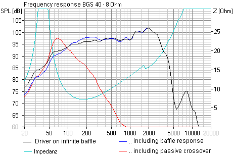

I modeled the speaker, standing on a floor. With a measuring point at 1 M on axis with the LF driver, max SPL at 40 Hz is about 93 dB. This is excursion limited. No amount of EQ will improve this. Real room bass performance will not be significantly better, because it is a dipole designed to be placed away from the walls.

I have a Beringher 2way stereo electronic XO I will use here with a Parasound HCA800 hooked to the Visatons and one of my tube amps to the top end. Will cross around 250hz and fiddle from there.
You are aware that you will need the passive components for the BGS 40 crossover to achieve the bass response as advertised?

I'm not sure....how would the added Qts of the series inductor change the problem with excursion limitation? The HCA should have no problem driving this speaker to excursion. If the added Qts is really that big of a factor I could add a series inductor....comments?
The problem with the limited excursion can't be solved. You would have to live with it. But Visaton uses the falling slope of the BGS 40 impedance curve to raise the bass level around 70 Hz. Sort of EQ by crossover design. Look at the red curve in the attached diagram. You will not be able to do that trick with a simple active Xover.
