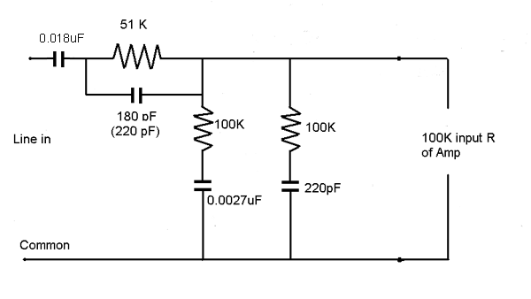

Impedance scaling. For a 50 K ohm input amp, halve the Rs, and double the Cs. 20K, 1/5 the Rs, 5x Cs.
There are several advantages in LL eq. The amp, be it tube or SS is in direct connection with the VC. There is less chance of ringing and other issues. Reactive components reflect back through transformers, placing strange load conditions on the plates.
Another advantage, the slew rate requirements of the amp are reduced if we are shelving the top end. That may not be a problem with a good amp, but why amplify something and then attenuate it? For too many years, I ran my Wharfedales in a 100w pc system, with 10db l-pads to pull them back to 93dB/W. EL84s would have been a better solution.
Slew rate is a measure of how fast an amp can respond to a signals rise time, usually in Volts per Millisecond. Exceed that, then the feedback circuit can't keep up, resulting in transient intermod distortion.

Impedance scaling.
Thanks Geoff,
I thought it was that simple, the main requirement being a correspondingly low source impedance.
If I were to use this ciruit, housed with the amp, and also have a CR to roll off the low frequency (around 100 Hz or so) it would go something like: 1M to terminate the interconnect, your LL eq. filter, then the appropriate CR to roll off the lows(this R is also setting the input impedance for the amp)? Just wondering if the CR would be interacting with the eq. filter.
Scott
Hi Scott. I would have the bass roll off first. Use lower values, so that the following network doesn't load it too much. ie the shunt R = 10K, Xc=10K, and I would try to stick with 6dB/oct.

Speaking of afterthoughts: My network has an input Z of 84K at low freqs. A series C with XL of 84K at the desired freq and your done at 6dB/oct. ie 0.018uf for 100 Hz.
Now for a bonus. An additional pot with a series R shunting after the input C, will give you an adjustable bass roll off freq. 80 to 240 Hz could be very useful in setting it up.
Geoff.

Geoff, could you give a example on a schematic on how to implement a 6db HP with this circuit..I am bieng slow as ususal..I usually use TUBECAD for the math on 6db HP when I use them, but don't have a clue how to use it with this circuit..I might not need it now, but would like to try it..since I am active 4th plate's @ 150hz anyway.
scottw, I also am using a TVC with this circuit & also want to try a 6db HP with it. The posted circuit works fine w/TVC on any source I have tried, but I am going active 27/26's pre shortly. My PLL circuit is cobbled together w/Styrene's from old Saba radio & SM's from who knows where. it is very nice..
Hi Guys,
This includes the low cut filter. 6dB /octave, -3dB at 100 Hz. This points out another advantage of doing things at line level. Low pass at 8ohm requires a huge cap, which wouldn't work due to the rising Z at resonance. It could have a reverse effect.
Any preamp worthy of the name should be capable of driving this, otherwise interconnect cables would swallow all the treble.
Geoff.
edit: I can read it.
Hi JeffB1,
Everything. All resistors in proportion, all capacitors inversely proportional, to the change in load Z, or input resistance of the following amp.
It should be fine to stay with preferred values in the 5% tolerance range.
Geoff.

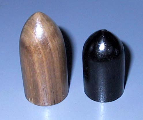

MisterTwister asked "it's a bit off topic, but how does one design a phase plug?"
I don't think so. We are talking about improvements, not methods.
I don't know how to design phase plugs yet, but working on it. Of the ones I have shaped so far, the shorter ones appear to be better, so I need to try even shorter ones.
I am using the classic bullet shape. I think in the "design", too many factors come into it, ie the shape and angle of the apex, and the rate of curve if curvilinear. I want to devise a better way of shaping too. Did the first lot on a grinding wheel, then sandpaper.
I do know that I will shape dowel before fitting tweeters and/or eq. Somehow they bring out a lot of clarity and spread the beam . No filter will do that.
Geoff
