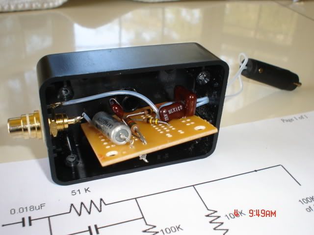

Hi John, no apologies needed, I shouldn't assume you can read my mind.
"On the line in side - common is negative
- the leg at 0.018uf - positive"
That is correct.
"Input R of amp- top + and bottom - (does this go into the input of the amp? on just the right channel?"
Should read "Input resistance of amp" And yes, the top is +, the lower, common, ground, or -.
A filter is required for each channel.
HTH
Geoff

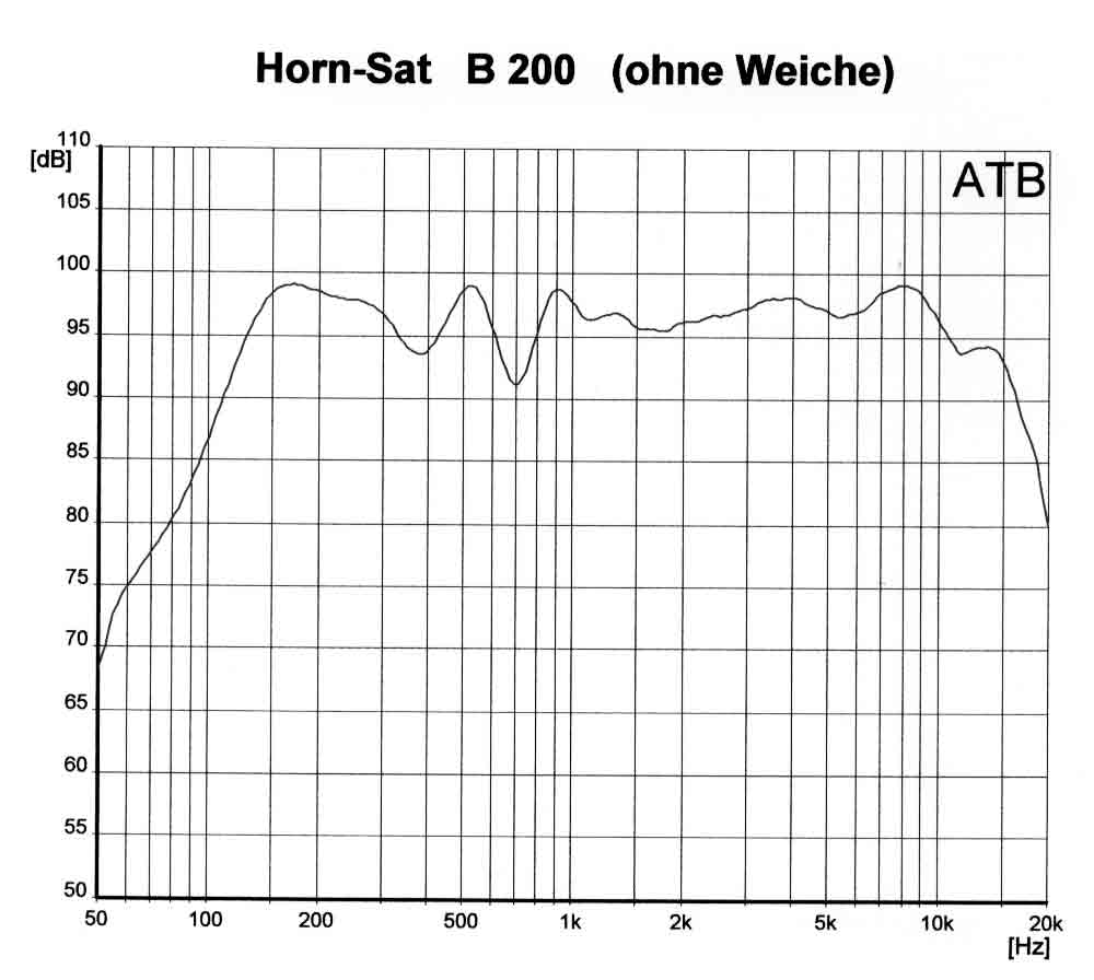

B200 no xo 98 dB
Hello,

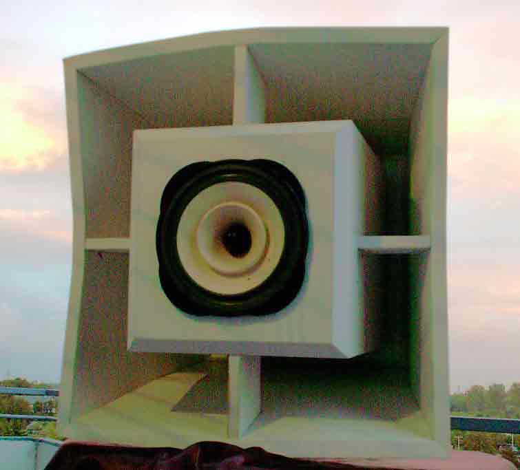

no one thought over a sat HORN
Geoff H
the measurement is made by Visaton,
no XO, pur direct 0° 1 m,
you didn´t notice the construction,
which delay, do you know the HAAS effect,
first wave ... look my site ABOUT WHAT,
every OB has more delay,
you kiding me or don´t understand.

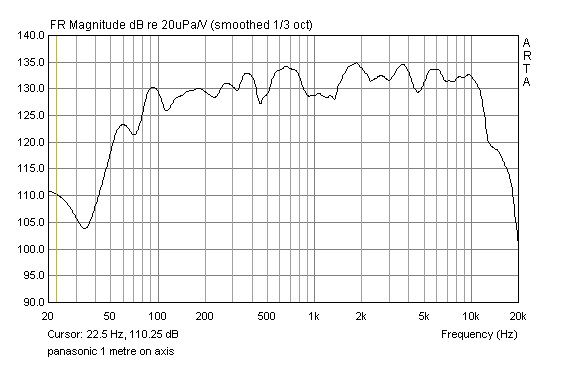

The attached is the result of an OB under development. The SPL meter has a 18 dB/oct slope above 10K.

Hello,
"On an OB, the delayed rear wave attenuates much more than that from a BLH."
sorry this is wrong!!
change the time of your csd, this doesn´t help.
Your fre. response is what: 1 W 1m 0° ?? XO ? B200??
Do you can change something of waterfall by a FR? No!!
so look the producer data.
Until 1994 i didn´t measure, I let measure by the
driver producer or the DIY journals where i publish,
and my joiner take measurements, sorry I listen only ;-)

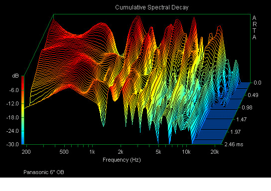

Hi Dave, you mean like this. Arta comes with good documentation, if you read it. Note to self, RTFM.
HM, if the rear wave is not enhanced by the BLH, I dont see the point in it, yet the design has a strong following. Some of us like the sound of a full ranger on an OB.
The waterfall will be changed by cabinet materials and type. That is audible. And yes, I do understand about the first wave. So much so my other full rangers are undergoing surgery. That's another story.
The FR is at 1 metre, about one watt. No xo. No, it's not a B200, and there is no producer data - I'm working on it. Yet to fix the dip at 1K now that I have extended the top to 18K. Then attack the stored energy.

Hello,
this threat is about the B200, what helps another driver
fre. response??
Show us the B200 OB fre. response, nothing else,
compair it with my solution, specially the SPL.
no dought about listening to OB´s, that not the point.
Yes of cause a bad box is listenable.
Your CSD shows more than 40 ms at 2 kHz,
that is worse as can be.
I didn´t say that my solution is the only way,
it is only a puristic solution, without XO and a never realised
soundstage with ~96 dB 1 W with one of the best sat
8" FR the B200.

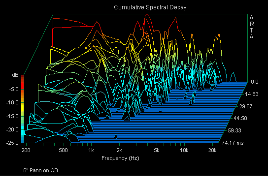

HM you are correct. This thread is about the 200B. My CSD and FR was to prove the point there is a lot more than just FR.
So have you a CSD for the SAT Horn? (which I think is a nice solution) so it can be compared to one on an OB with 200B.
Geoff.

the key of this solution is first:
the horn works only up to~600 hz with a warm roll of !!
2.
koaxial horn throat and mouth.
3.
extrem small wall distance the last 45 cm of the horn.
if you listen in 4-8 m distance and take enough sub´s,
its one of my best, in normal distances 2,5-4m the smaller one´s
better, specially WAF ;-)
regards Horst

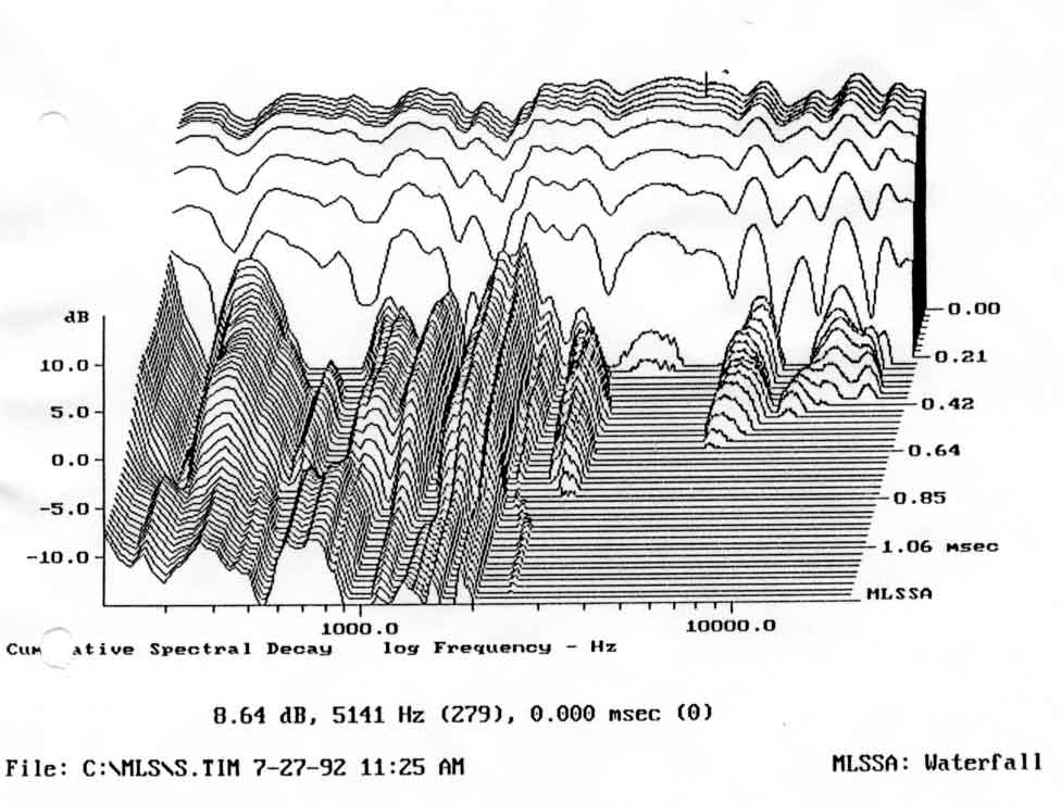

This is from the Visaton site. I can only assume the driver was mounted on a standard baffle.
www.visaton.com/bilder/ausschwing/gross/b200_zd.gif

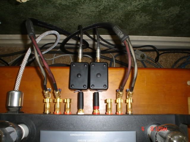

Joe's system retains the 96dB/w, as the filter is placed in front of the amp.
The CSD I posted was measured when placing the baffle on a upturned plastic tub. The time at 2K is about 20ms when on the floor.
Perhaps some one else has a CSD of the B200 in a cab.
