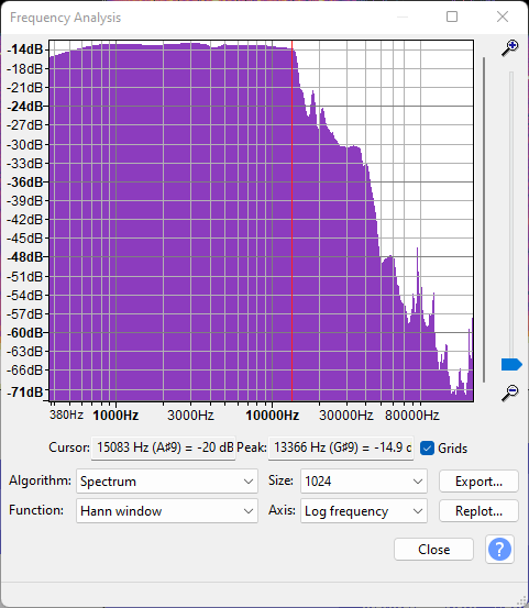

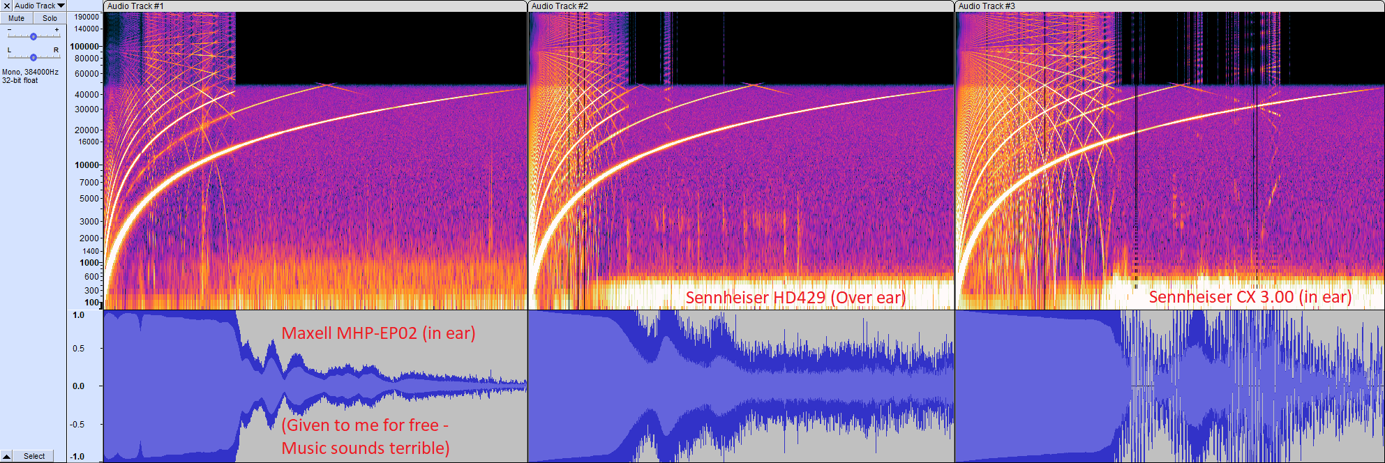

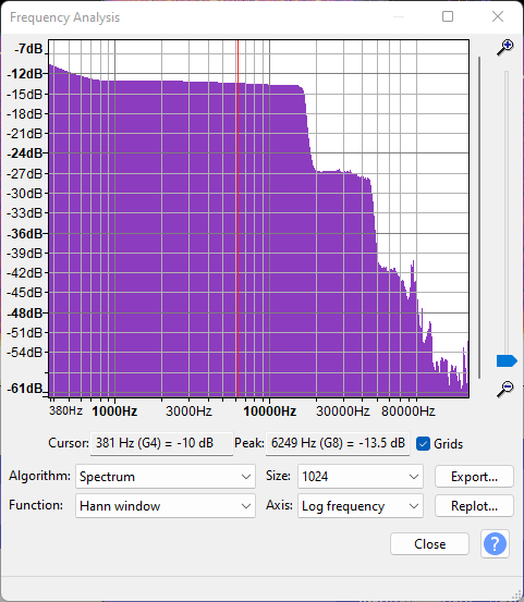

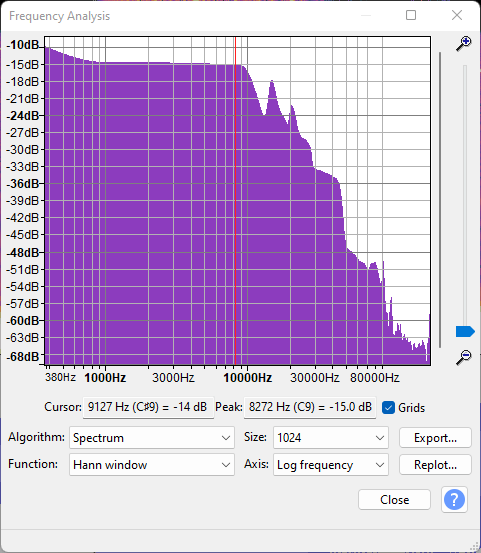

So i received a free set of headphones with a parcel today. On the back I noticed its frequency response spec on the back (20-10kHz) So I thought i'd try to see if i could test and confirm those specs, which i could. Though I was a little bit surprised with what I found.
Maxell MHP-EP02 (in ear) (10kHz spec, 13 to 10kHz measured)
Sennheiser HD429 (over ear) (22kHz spec, 9kHz measured)
Sennheiser CX 3.00 (in ear) (21kHz spec, 16kHz measured)
Thoughts?

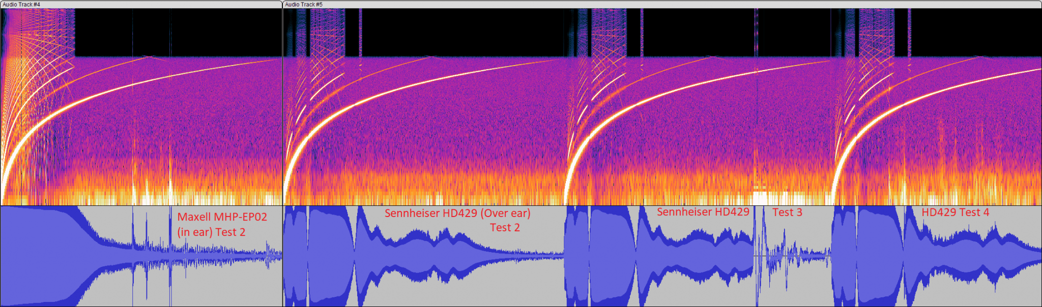

- First, it turned out that I had the wrong settings on my computer which limited the output to 23kHz, so that was rectified.
- It turns out that even if its frequency response was only up to 10kHz, I could still measure output up to 40kHz.
- Understanding that the 10kHz earphone spec is where output volume begins to drops, not where it fades to zero. (Measured as 13.3kHz first try and dropped to 10kHz on subsequent tests)
- After testing the over ear sennheisers a few more times, it seems i'm getting drop outs. I wonder if doing these tests is damaging my DAC, headphones and/or mic....
- So it may still be possible that I haven't lost my precious young high frequency hearing just yet, and perhaps maybe it's just the limit of my old headphones or is the limit of my old DAC?
