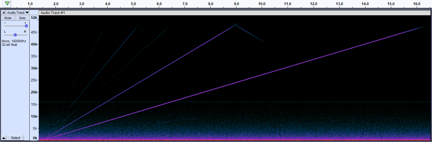

But first I tried to do a more scientific test using ahigh quality sweeping sine wave (from audiocheck.net)... My first test to see what my natural hearing ability cut out. At first I thought I was losing my hearing as it seemed like I couldn't hear above 16~18kHz. (I've been medically tested to have perfect hearing maybe 10 years ago).
I then decided to test the limit of my current hardware. So I sticky taped my in-ear headphone directly on the mic, and recorded its output. Turns out the output level tanks at 14kHz. Bottoms to -21dB at 16kHz. It then climbs a tiny bit to -16dB at 20kHz. It then tapers to nothing an no signal is detectable after 23kHz. But looking at the spectrums, it looks like its a complete mess of overlapping reflections. And after 4.5 seconds, that large black area above 22kHz tells me that I've hit the hardware limitation, be it my external sound card, my headphones, my mic or all three.
Having said this, I think I can safely say that I won't be able to tell the difference in quality from CD flac rips to hi-res captures and super duper TT setups. And since I can easily tell that my vinyl setup sounds worse than the CD rips, then I have a feeling that spending $3K on super high end equipment would just be a waste of money. Well, until I hear TonyEE's recordings that is... Feel free to send any time 😉

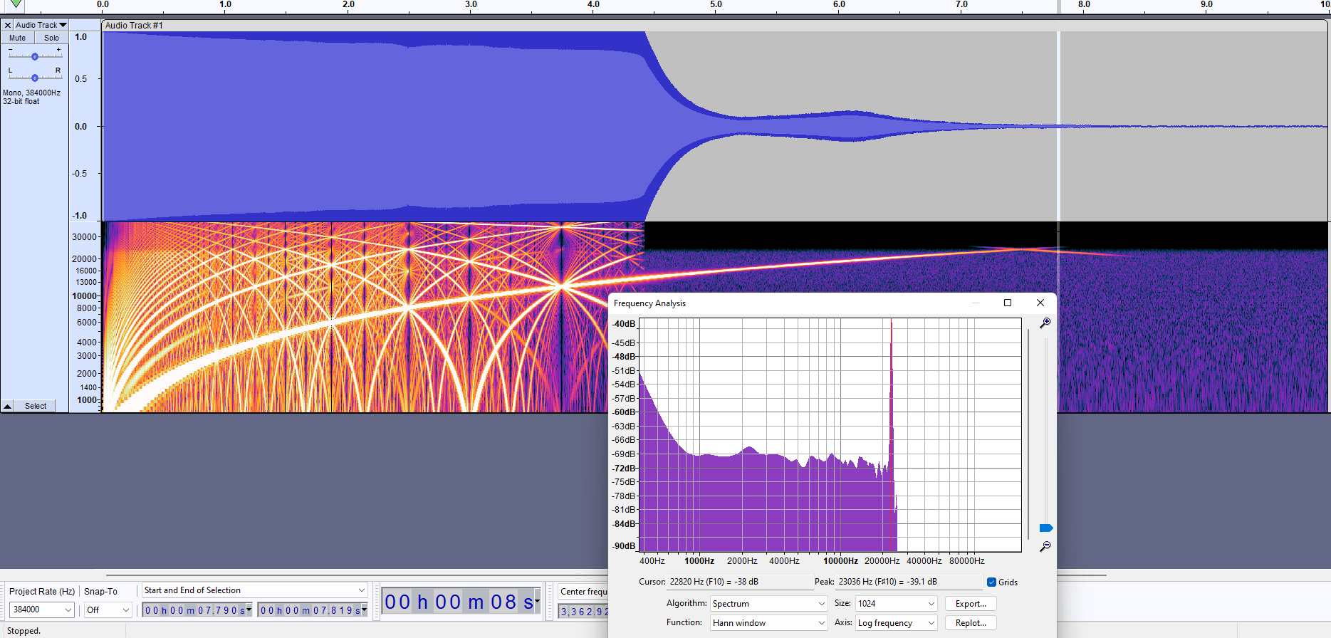

So after a bit of digging around, I pulled out what I thought was worse headphones and microphone. I then repeated the test. It looks like my DAC and ADC can output and detect up to 47kHz.
But the bad news is, my hearing really is topping out at 16kHz... Which is disappointing as I'm only 35 yrs old, and I thought I had taken pretty good care of my hearing... :'( I definitely can't "feel" it either, so I honestly fail to see how i could possibly experience Hi-res, vinyl or even CD; to their true sonic potential. Here's to hoping that my testing is wrong and that I haven't lost my hearing just yet :/
