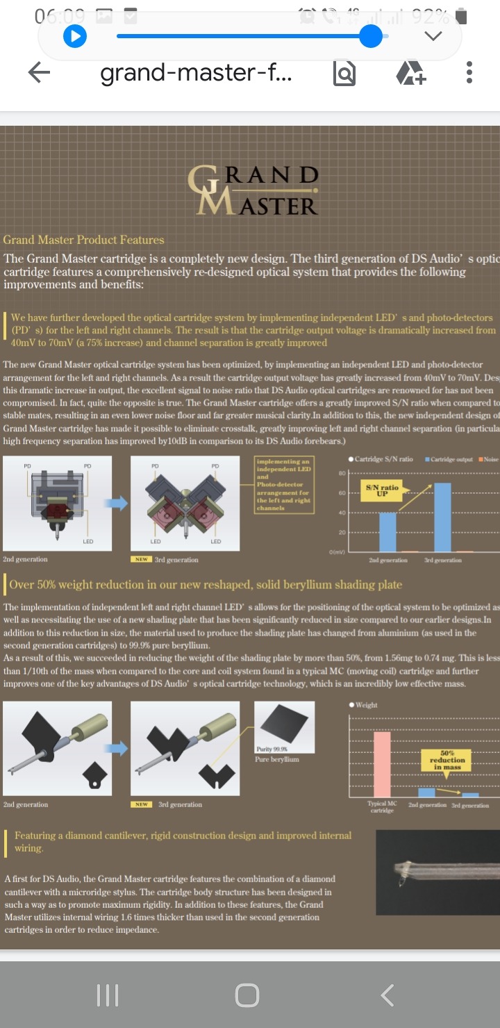

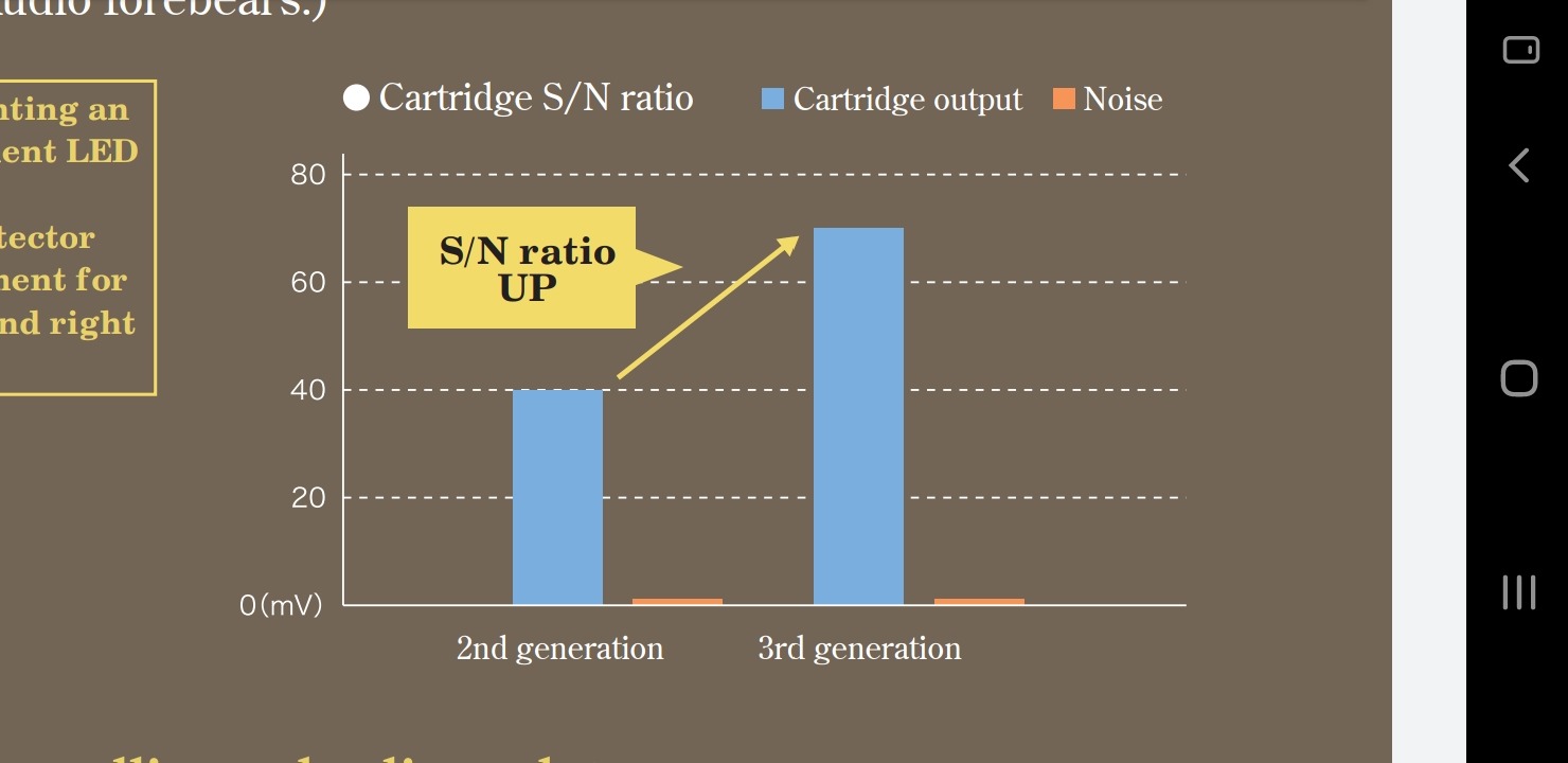

Actually DS claims about electric cartridge snr are widely false and, as any guy who knows the true max dynamic range of an analogue optical setup the optical catridges are basically in the cassette tape + dolby B snr range just that the dynamic is actually the true limiting factor here...Reducing the reading area as DS claims to reduce cart weight reduces the dynamic range to the snr area also. The signal looks more quiet, but also has reduced dynamic range compared to traditional electrical pickup.LED+ photovoltaic detector noise are usually higher than any mm electrical cartridge noise and even if you remove the electronics attached to it.These guys preffer to fool themselves and pay even more money for nothing because they have no ideea what thermal background radiation means....

Optical film used to use photocell receptors. Optical cartridges use electrically buffered, optically focused phototransistor receptors. Not the same things at all. Also, optical cart electrical output signals are much larger than the very low level signals produced by MC transducers. Stray pickup of hum and noise due to the very low signal levels is one problem with MC. Another problem is that magnetic hysteresis affects the sound, so they sound something more or less like a iron-core transformer does. Optical doesn't have that type of coloration and distortion. Seems quite a stretch from someone who has never heard good optical phono to speculate about how it can't possibly work all that well based on erroneous modeling assumptions.
