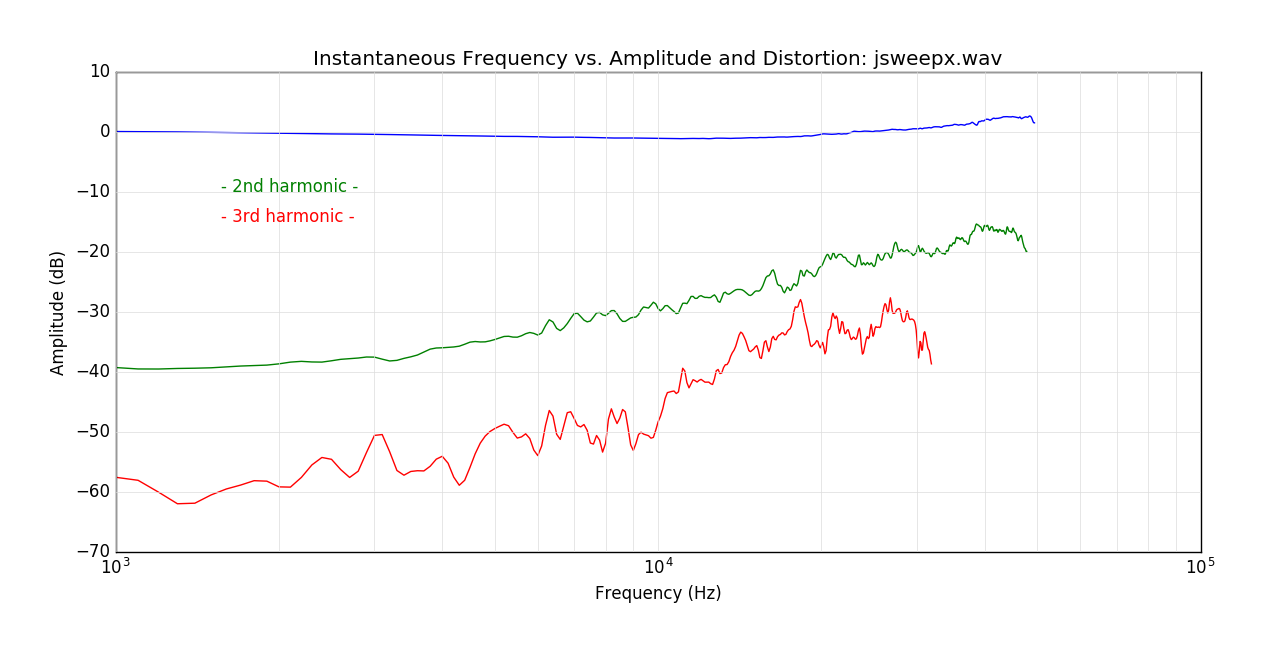

I repeat here a constant velocity sweep from JP's setup, IMO a constant velocity sweep with no RIAA is the best test because it directly pits the ideal transducer responses against each other.

Your\JP's constant velocity sweep without RIAA is interesting, but at the moment I'm missing the intention. Note the center of the X-axis is 10kHz, the 2nd harmonic 20kHz, and the 3rd harmonic 30kHz, so from middle to right of the chart distortion is ultrasonic and thus inaudible. Within the audible range, the distortion might appear reasonable - on the order of 1% or less - but would be significantly higher after RIAA HF emphasis. (Is any of this what you mean for me to see?) Of course any non-linearity produces HD and IM, the difference products of which could fall within the audible range. And I'm sure you know that non-linear distortion from groove mistracing is due mostly to the stylus tip shape, and far less the cartridge mechanics.

I was more interested in the low frequency asymptotes on the THD plots. One would think the distortion would keep going down with frequency from stylus geometry arguments, the small signal power law behavior with increasing frequency seems to be a decent fit (similar to 2nd and 3rd order intercept in RF).
