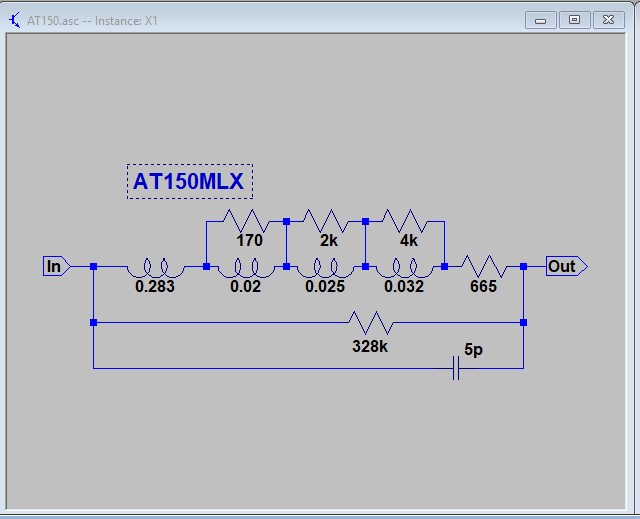

And most MM\MI pickups suffer poor frequency response (aka tone color) error if capacitance loading is not within ~20% of mfgr's specs, ranging from none to 675pF, so in addition to the cabling, "100 or 200pF" may not be fine enough.
Based on some research done on here I am not sure I believe manufacturers loading specs. The MM generator is a relatively complex impedance. I honestly think Barney Oliver was onto something 50 years ago which was widely ignored on a better way to do things.
MM\MI pickups loaded incorrectly by users-supplied load resistance and capacitance dramatically affects frequency response, with too low capacitance causing a broad dip in mid frequencies and a troublesome ultrasonic peak. Too high a load capacitance does the opposite, a broad rise in mid frequencies and rapid falloff in highs. This could explain magazine reviewers' erroneous criticisms of a cartridge sounding either "too dull" or "too bright." If a user's C-loading is correct, the cartridge will meet its frequency response spec and sound as good as it can.
Reputable manufacturers implies they publish meaningful specs. For recommended load capacitance, specs can range from 100 to 675pF. On the low end, and using 5ft of good 20~25pF/ft coax resulting in 100~125pF, the preamp should add none. For higher, it's easier to add capacitance than to reduce it. For many pickups, a reasonable value of 275pF is typical, so preamp's often have a 150pF capacitor at their input jacks, adding to the cable's 100~125 to get within the required 10~20% of spec.
Have you ever actually measured generator performance over frequency? The inductance varies over frequency. Getting a decent electrical model of the generator (done by some members here) shows some very interesting things.

I would put forward that you are the rude one by not looking at work done on here. Scott for instance has actually compared pink noise sweeps across different test records. The CBS does not come out top! Attached is cartridge equivalent circuit Hans Polak generated from a sweep up to 1MHz. That is more accurate than anything I have seen published to date. There has been a lot of research done on here. As you are keeping your cards close to your chest you maybe can add to this, or are possibly some years behind where DIYAudio is.
I am not sure if you are here to lecture or to learn. Hopefully the latter...
