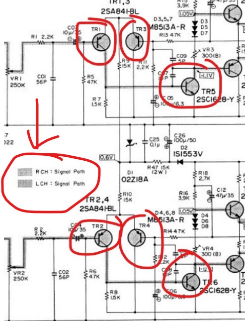

Hi Mooly,
Hope you're well.
I had a question I was hoping you could help me with.
The chap I sold my system to has called and said the amp is cracking and popping on the left channel. My question is as per your post I quoted would I need to replace Tr1 and Tr2 only or Tr3 & Tr4 also?
I've got 4 a970 GR transistors here to do the job that I bought from cricklewood. If I was to replace all 4 would the same a970 gr transistor work in place of the 4 that I will be replacing?
Thank you
Regards
Taz
The odd numbered parts are for one channel and the even numbered the other, so its either TR1 and TR3 or TR2 and TR4 depending which channel it is.
The image in post #42 is supposed to show which channel is which but tbh both look almost the same to me on the scan.
The 2SA970's should be fine as replacement but always double check the pin outs to be sure they match the originals.

Sorry I wasn't clear in the previous post. I am going to replace both channels and wanted to know if I would need to replace all 4 transistors or just the ones in TR1 & TR2?
Replacing both channels while I'm in there seems the logical thing to do, wouldn't want the other channel blowing out and having to do it all over again in 6 months time.

From the reference sheet they look the same but will double check in the morning before I give it a go. I will then be following your other posts about setting DC offset and bias.

I always say to make both channels the same when changing parts but remember... although these are a known failure item it doesn't automatically follow that they are the cause of your fault.
The VAS stage that runs hot would also be a possible suspect, as would dries around that stage.

I will change the transistors and hope it fixes the problem. Will look for weak solder joints around the VAS and re-solder any that need it.

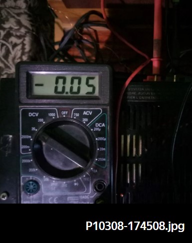

P10308-174508.jpg — Яндекс.Диск
hi, advise where to dig? some kind of rephasing ... maybe the wires from the transformer are incorrectly soldered?
