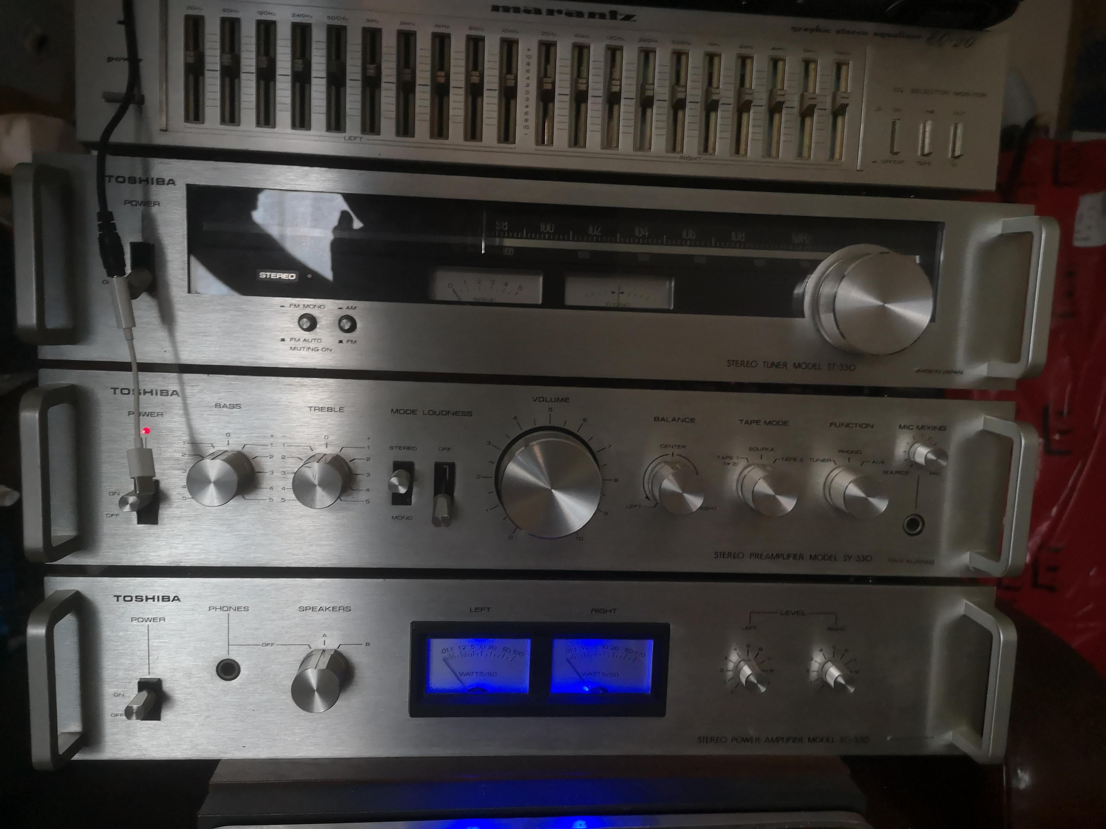

If I can find a diffused blue diode that's rated for 14v could I use that without a resistor?
Sorry for all the questions I'm not too savvy when it comes to leds and the sort. My first time trying, normally I would just replace it with like for like but with this I believe the blue would suit it well.

You would have to study the circuit but if the 8V AC is from a winding on the transformer then the simple answer is no, it wont work.
LED's are current driven ultimately and always from a DC source.
That said it is easy to connect an LED to an AC voltage using a diode to produce DC and a resistor to limit current.
Flicker can be an issue because LED's have no 'thermal inertia' like a filament bulb. This means that you might notice flicker, particularly as you move your eyes or look out of the corner of your eye... a bit like old CRT TV's of years ago.
Again easy to fix with the addition of a capacitor...
Or...
LED's use so little current that you could run them off the DC rails in the amplifier with only the addition of one series resistor. Super easy and no flicker.

Thank you very much for your detailed explanation.
Think I'm going to leave it as standard for now and fit a new original bulb and look into the led conversion in the future.

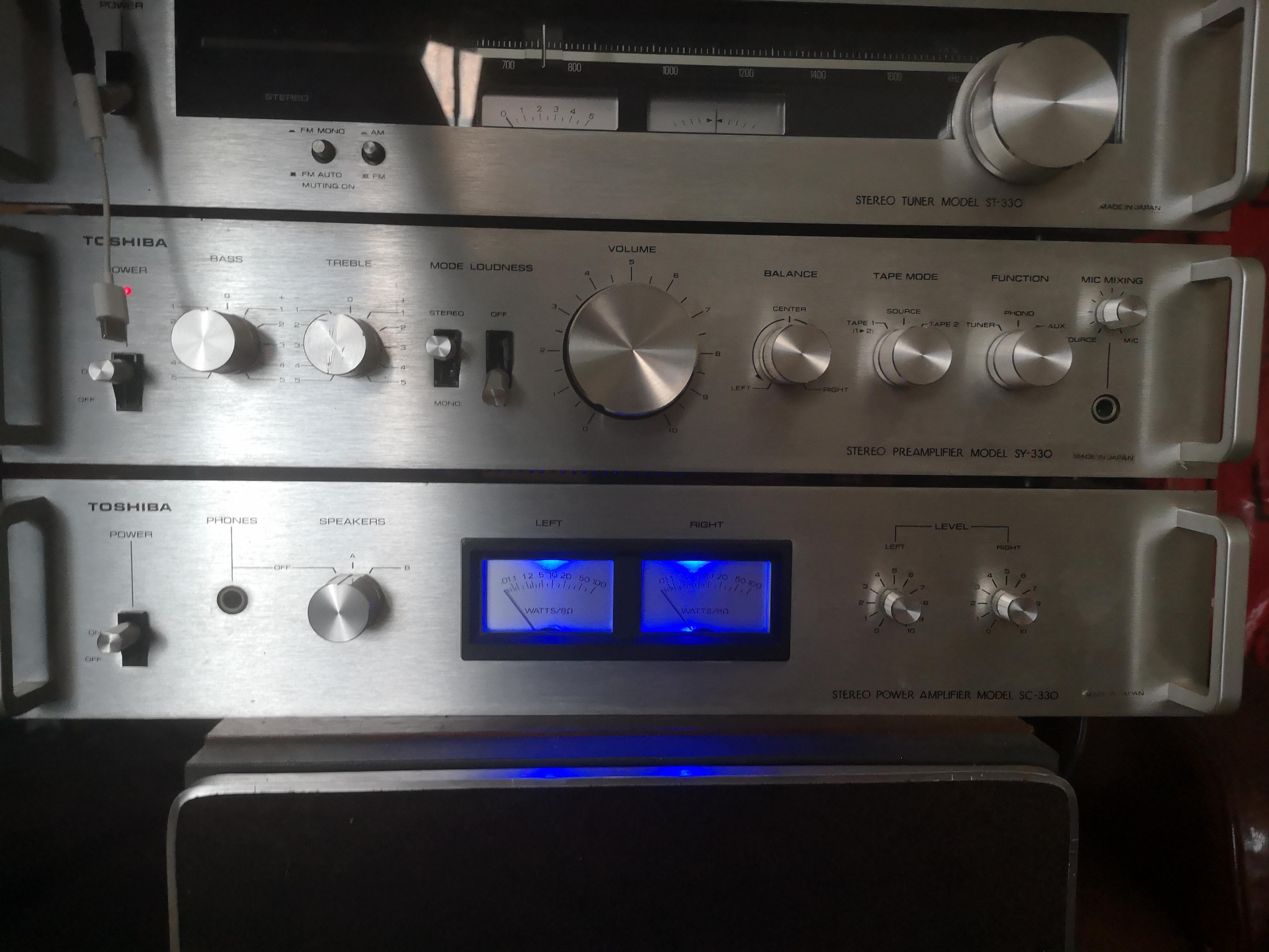

Hi folks and hope you're all having a blessed New year.
Thought I'd update my post here for anyone else who might be looking to do the blue led upgrade.
Turned out to be extremely simple to do, I bought some blue LEDs (14v + resistor) from the bay and just cut away the old bulb and spliced the led into its place. Little solder and heat shrink and they look standard.
Simple as that really.
