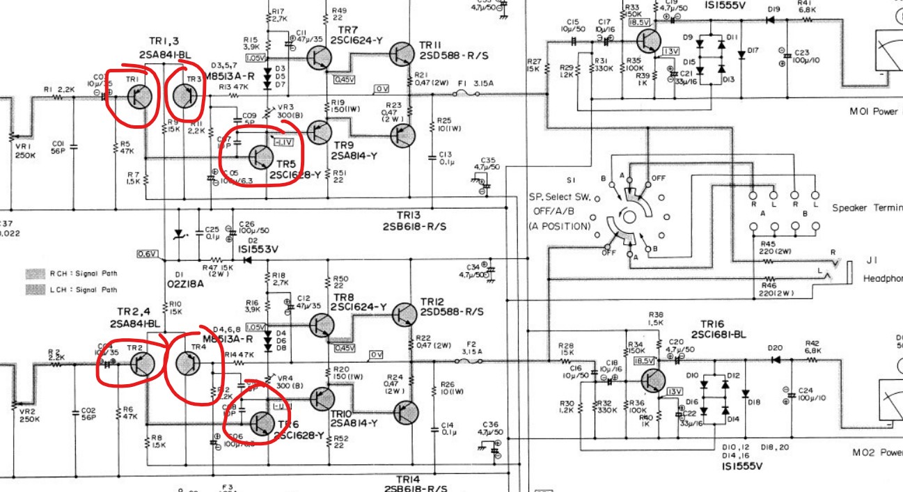

We know the input transistors are a known issue so I think you should replace those first.
Also check for any poor joints around the VAS stage.
The VAS transistor will run hot and so might be worth replacing.
These transistors. Change the input ones and check the other one for dries. If no dries and it still has the fault then replace this transistor.
I don’t understand why do you advise me to change some data on the left channel? if it plays well and there are no problems ... and why do you have a diagram with no such power transistors?

I listened to your recording and heard the popping noises it makes.
You have to change the parts on the channel that is faulty, that is up to you to determine.
It is possible the actual device numbers differ between different markets and regions.
The two transistors at the input are a known fault. These are the two 2SA841's. Change them on the channel that is faulty.

you absolutely rightly thought ... and this happens when you turn on ... replacing the resistors did not help ... then now you need to order those transistors in exchange for 841 to 970?
So you have to try those transistors first.
