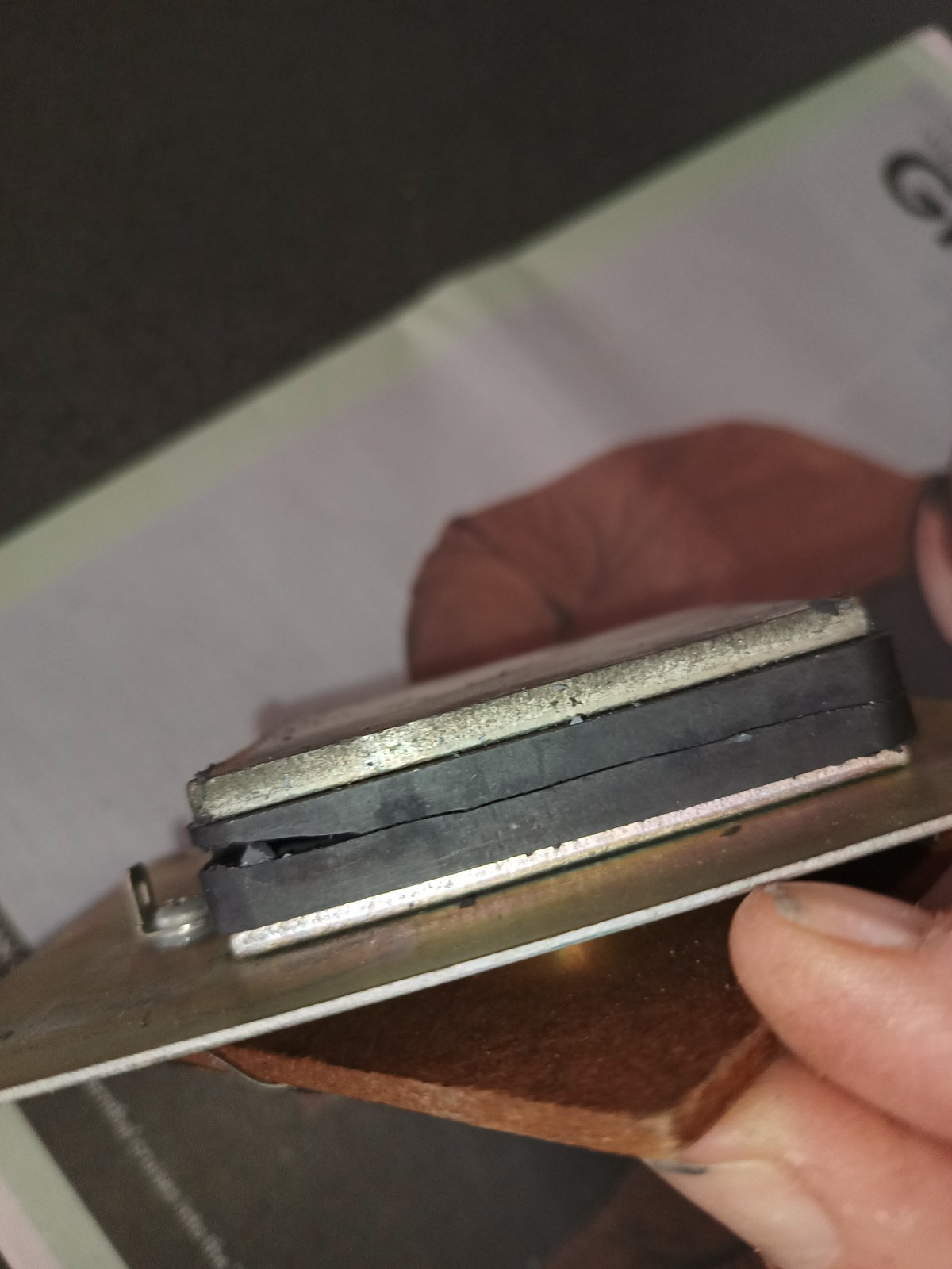

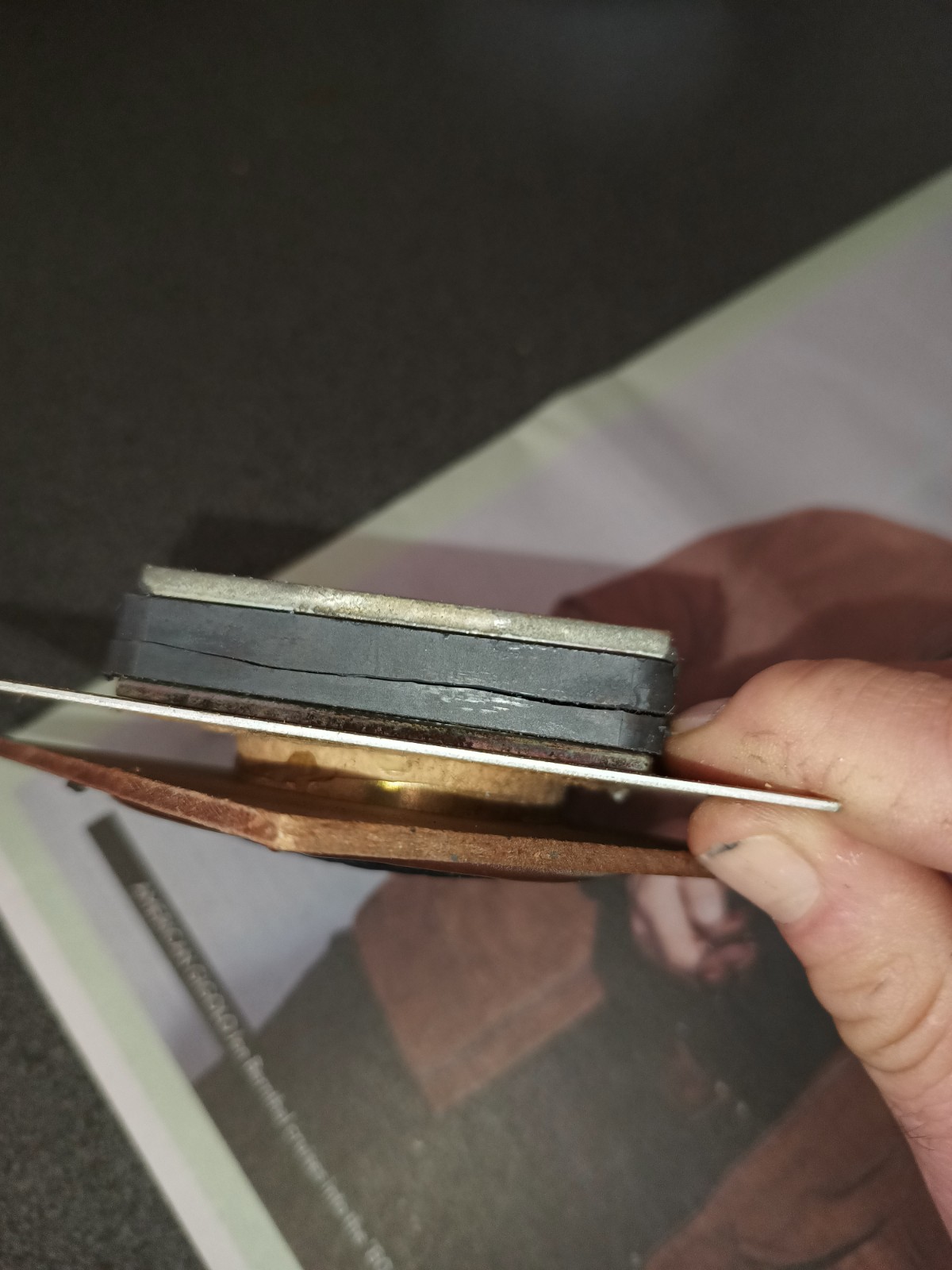

However, considerations such as those above pale into insignificance when faced with a fractured tweeter magnet!
If I can get over the tweeter problem I'll definitely review the caps.

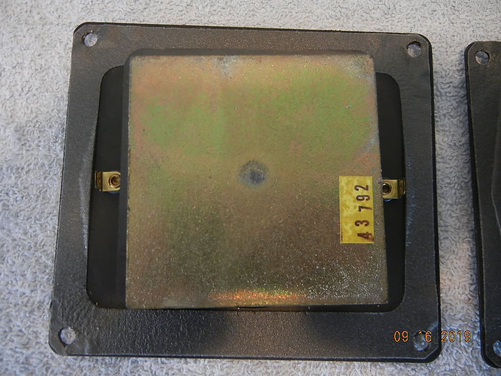

Just where on the back of your tweeter is it cracked?...is it under the backing plate or?

The only thing I can think if is to dis assemble (if that is possible) without destroying the tweeter and fit a replacement magnet??Just where on the back of your tweeter is it cracked?...is it under the backing plate or?
-----------------------------------------------------------------------------------------------------------------------------Rick...

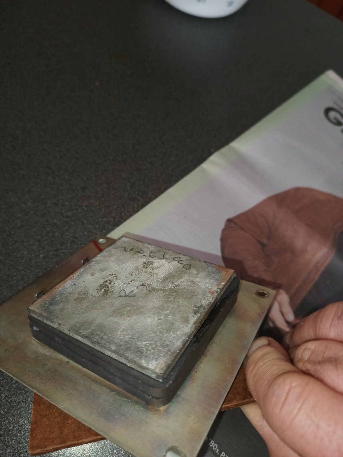

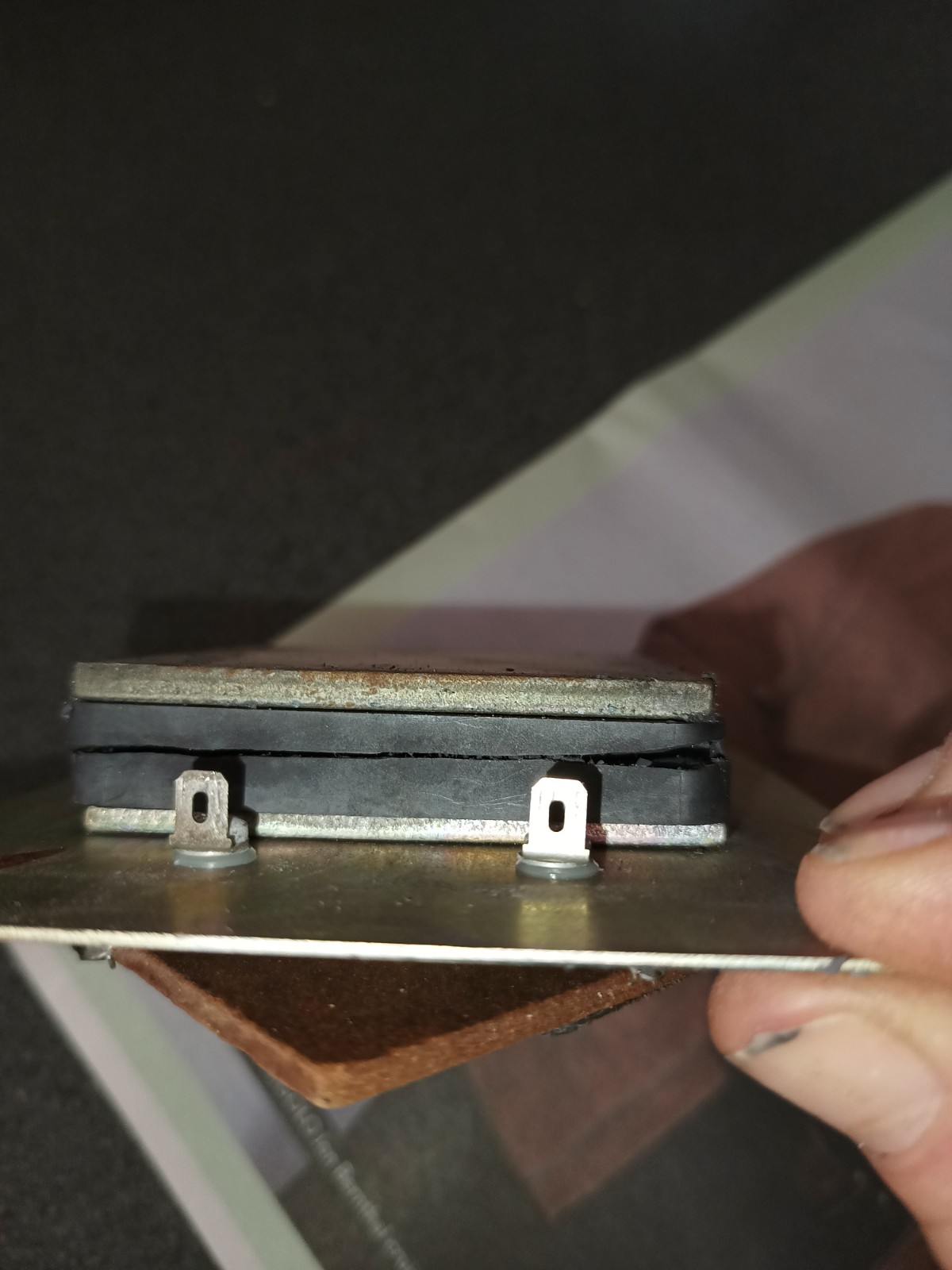

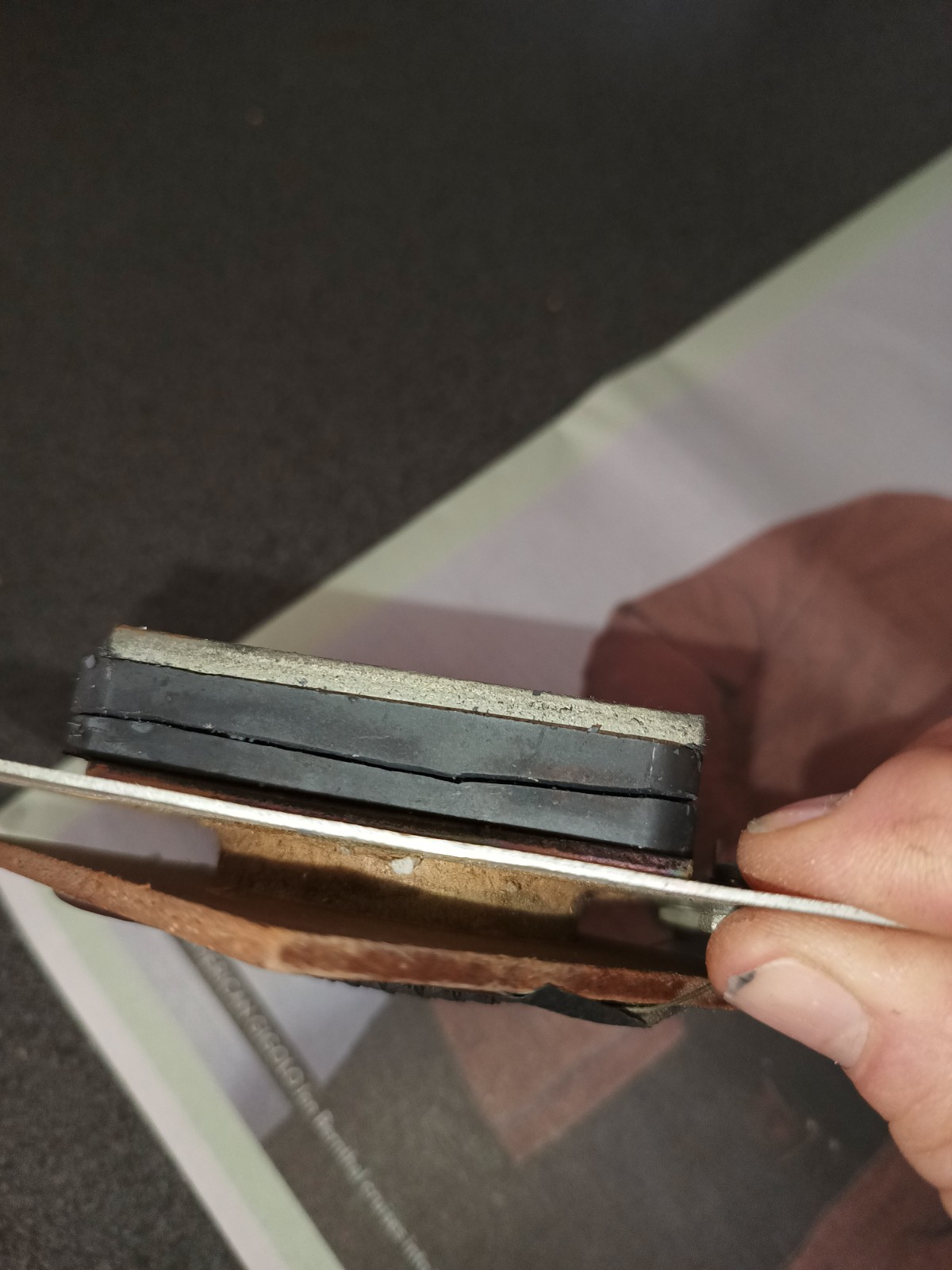

Oh, only now I see.
That magnet is cracked!
It must have fallen hard on a concrete or tiled floor.
Yes, technically, it CAN be replaced, it involves full disassembly and major surgery, but not at home or in an Electronics service shop, only at a speaker Factory or an *advanced * reconer
Not sure if square magnets are still available, but a proper thickness ferrite ring, its diameter some 20% larger than a square plate side would work fine here.
Problem is cost: freight both ways would be way more expensive, so your second best is to try and find a spare one on EBay
Just curious: can you measure healthy square magnet on the "good" tweeter?
Square sides and ferrite thickness, Metric if at all possible.

The square magnet is 77mm x 77mm x 12mm
The outer plate is 73mm x 73mm x 4mm
The plate sandwiched against the mounting square is 73mm x 73mm x 2mm

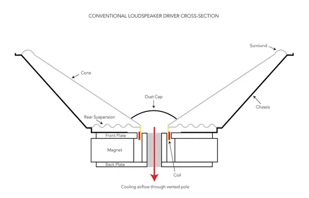

There should be no danger of shorting the amp provided the magnet halves still remain firmly sandwiched between the metal front plate and the metal back plate - see the magnet assembly in the typical loudspeaker cross section below. The cracked magnet should still do its job effectively - a listening test comparing with the good tweeter will confirm or deny that - but you may want to tidy up the crack with some black silicone sealant to make you feel better! JMF may have more to say about using cracked magnets.
