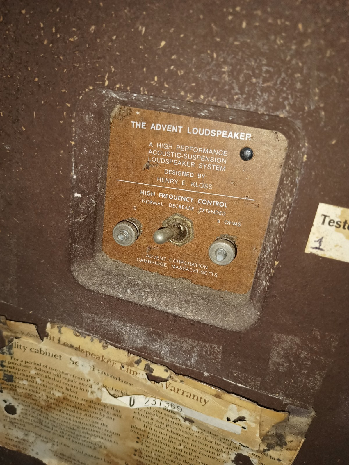

While handling the speakers I inspected the attenuater controls at the rear between terminals.
They look like toggles but twist rather than switch.
I noticed they don't have stops and continue to twist without an apparent beginning or end.
Is that normal?

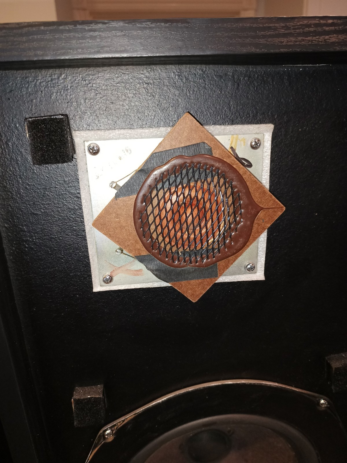

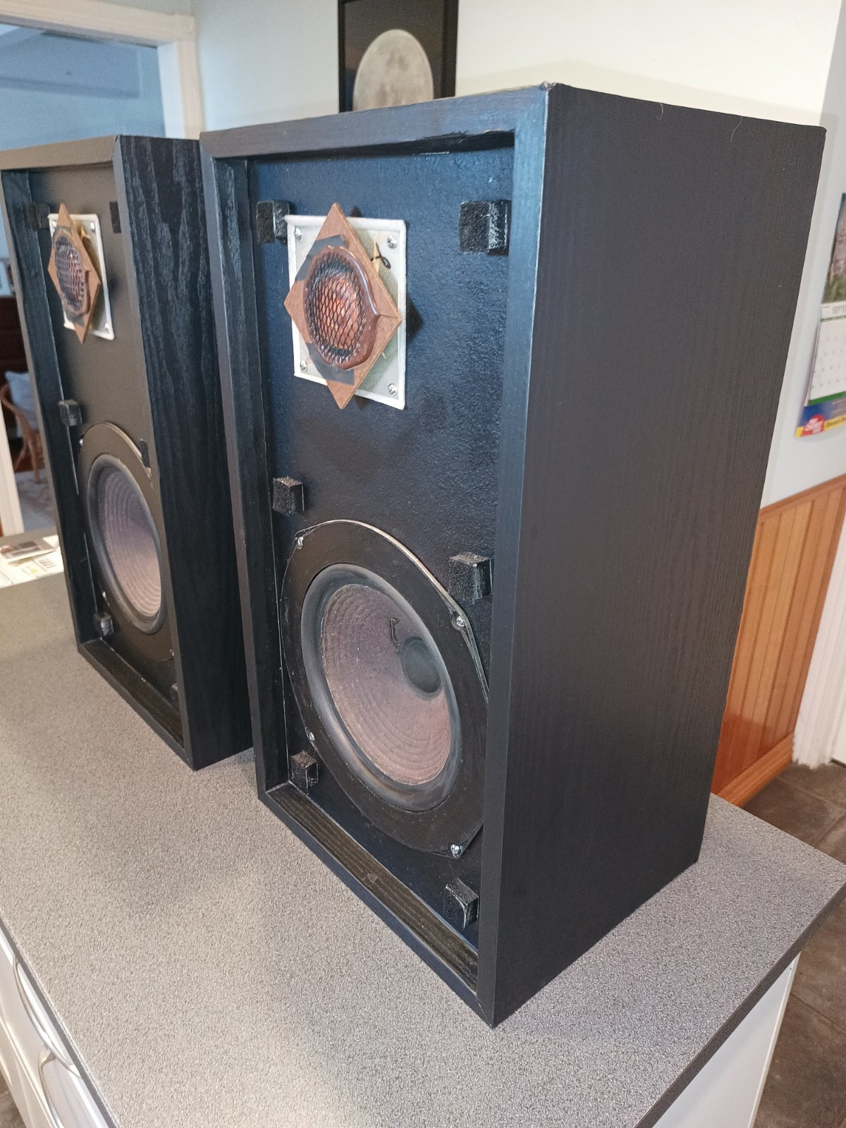

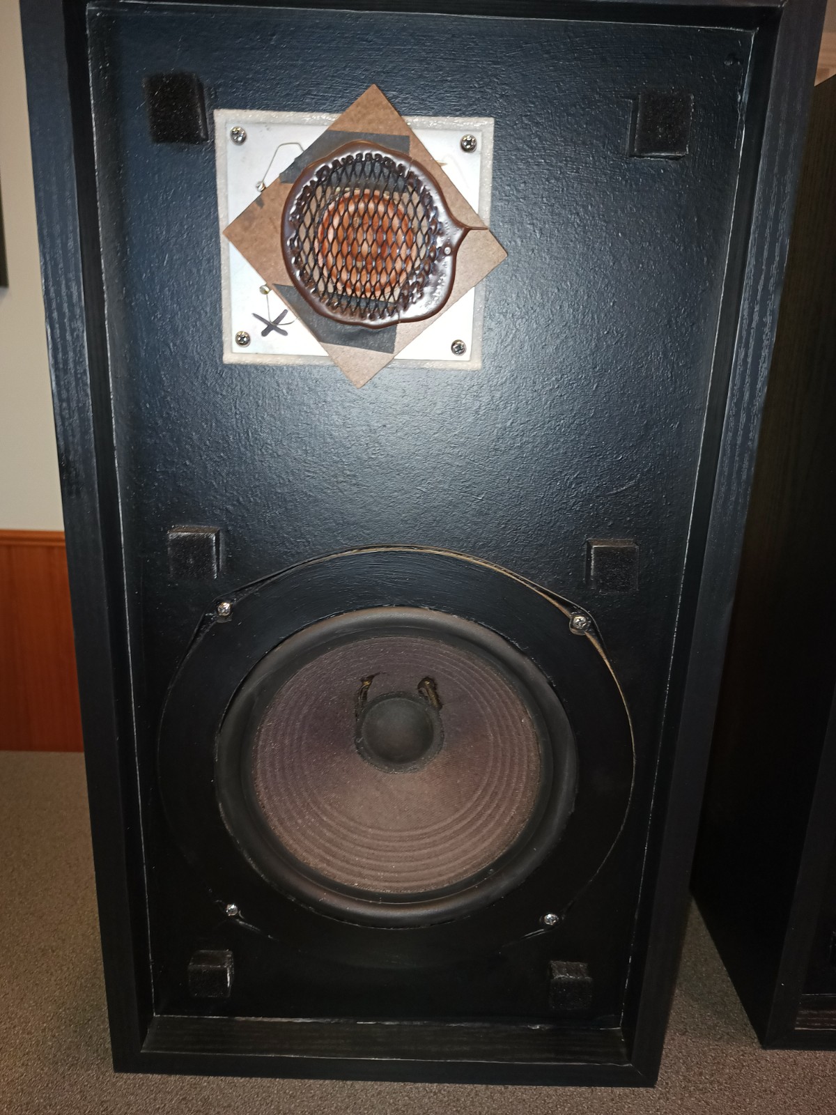

Hi G.
I'm currently in the process of tidying up the cosmetics.
In essence, changing them from a garage speaker, to something the Mrs might accept in a lounge room environment.
Matt black baffles, matt black wood grain vinyl wrap.
Also brightened up all connection points and checked the crossovers and wiring to make sure nothing is amiss.
While dusting out the cabinet internals I found remnants of foam surround material.
I'd say for sure, either a previous owner, or their speaker guy replaced the foam with the rubber surrounds.
It would have been nice to be able to audition these speakers to the makers specs.
But with rubber, who knows what glue they used to connect the surrounds to the cones.
So I'll stay with the rubber material for now, as removing contact adhesive from original cones could most likely be destructive.
I'll definitely come back with pics and a critique on their sound.
I'll run then from my Marantz PM 6a, and Marantz CD-74 or Luxman DZ-112.
One thing, the toggle control between the speaker wire terminals is a twist affair to attenuate the tweeter.
It doesn't have stops. You can continue twisting it in each direction without a stop.
Hope this is normal, and hope whatever I set for one speaker, I can duplicate with the other.

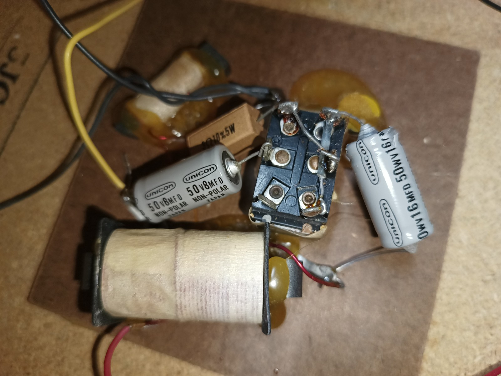

Hi Cliff!
The word "toggle" suggests a simple on/off action as in "toggle switch".
Could the tweeter control be a rotary switch which selects different values of fixed resistor to be placed in series with the tweeter to vary its attenuation?
We could do with a clear photograph showing the tweeter control and all that is connected to it.
If "twisting" the control has the desired effect of attenuating the tweeter, then you have nothing to worry about.
Try examining the action of the attenuator on the first speaker with your ohmmeter to see how you can duplicate the setting of the control on the other speaker.

Having said that, it won't toggle & it won't press in/out.
The only thing it will do is twist with no stop in either direction.
The area directly on the inside of the switch forms part of the crossover.
CORRECTION: I wasn't firm enough when testing. It is indeed a three position toggle. All is solved. 😊
Post a closeup picture of your switches, inside and outside.
If you have rectangular bodies inside, with 2 or 3 contacts each, and toggles outside, those are regular toggle switches, period, switching action comes from .... ummm .... "toggling" them side to side (or top to bottom)
Sometimes, depending on construction method, toggles themselves could rotate if held between thumb and forefinger , but that switches nothing, simply they are loose.
EDIT: simulpost 🙂
Definitely toggle switches, moving side to side in first picture, up-down in the second, same thing.
Notice the "fat" toggles.
Often actual acting toggle is a straight piece of hard wire, over which, for looks, a turned "barrel" (typically nickel plated brass) is slipped over, and crimped or simply friction fit.
Over the time that decorative barrel can get loose and freely turn, no big deal.
Edfit 2: notice toggle body is fatter than the hole giving access to switch insides .... how is that possible?
First a thinner but stiff wire went through that hole, from the inside, then they slipped a decorative cover over it, from the outside.
EDIT: simulpost 🙂

P.P.S. Did I read that you were not going to wire in new electrolytic capacitors? I certainly would.
I've learned my lesson.P.S. It's worth checking that your twisting of the toggle switch around "with no stop in either direction" has not damaged the connections to the switch or the components attached to it.
A large reason for the Advents acclaim was the crossover voicing.
Old as these components are, it all looks pretty professionally designed.
Replacing the caps could destroy their sound.
I beg to disagree. Rather than destroying the sound, replacing the capacitors with fresh electrolytics should restore the original voicing of the speakers.
You can keep the original caps and can always revert back to them if necessary.
Have you measured the capacitance and ESR of the original capacitors to see how much the values have drifted from when the electrolytics were new?
Hi Galu.I beg to disagree. Rather than destroying the sound, replacing the capacitors with fresh electrolytics should restore the original voicing of the speakers.
I was of the mind to back off on cap replacement partly due to the general feel I've been getting from previous refurbs that I'm doing my money, that gains are unlikely and one poster implored me not to tamper with the voicing.
The crossover is pretty congested with parts and existing caps wires are fairly short. I'd have to either cut them out or de solder them to do correct tests.
Although fresh electrolytics would have correct ESR & capacitance, aren't they inferior voice wise compared to film?
I finished the cosmetic makeover and during the final inspection and reassembly I noticed something that I had missed.
The square magnet of one of the tweeters is split vertically into 2 pieces. Previous owner must have dropped it when they were repIacing the surrounds on the woofers. I've removed most of the crumbled pieces and moved the magnet halves into alignment with each other.
They reproduce sound but you can tell they're not performing very well.
So basically they're saved minus a tweeter. Bummer.
I haven't given up on fiddling with them to get an acceptable sound but I think the magnetic affect is diminished??
I was very happy with the sound reproduction when playing the speaker with the intact tweeter.
If ESR is down they have potential to sound even better.
Just need to overcome the tweeter issue. 🙁
Film caps have a smaller ESR than comparable electrolytics for which you must compensate by adding series resistors if you want to emulate the original voicing of the your vintage loudspeaker.
Low ESR capacitors will make your speaker sound different, but not necessarily sound better.
