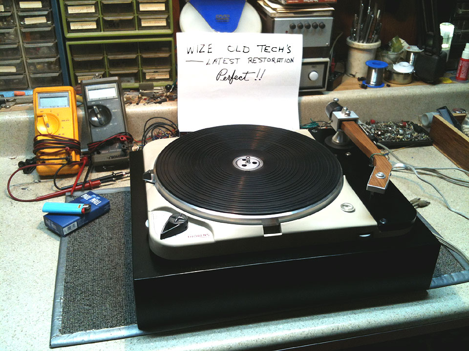

How about THIS "Old Clunker"?
A Thorens TD124 w/Grado arm.
Just finished a week's worth of restoration work on it for my neighbor.
Reactions: jkasch
So, which would YOU have adorning your living room?

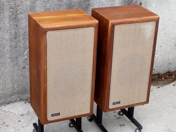

My main aim is to economically to pretty up these speakers while maintaining their sound.
I win;t be touching the original crossovers, and will stick with the rubber surrounds.
The finish on the woofer masonite rings isn't the best.
What are your thoughts of painting these to match the matt black front cabinet baffle?
Could that detract from their desirability?
I'd certainly take the Advents.
Satisfying sound, reasonable price.
I don't need spaceship art to impress people with.
Hi W.
I'm with you regarding cosmetics.
Far from "spaceship art", I'll be doing a low sheen black wood grain vinyl wrap, re spray the front baffle and edges with mat black, brighten all terminals to remove corrosion, tighten up wire connectors and make sure the wadding is correctly in place internally.
Also the "satisfying sound" will be maintained as I won't be touching the crossovers.
And the "reasonable price" will also be there as my investment so far is under $30.

Dunno, you tell me.
"A week" job means 8 hours * 5 days * $65 (minimum bench Hour fee in US, easily $125 to $150 at a nationally recognized AWSC shop)=$2600 (+ applicable Taxes)
Did your neighbour pay that?
Congratulations.
My neighbor's brought me quite a bit of audio equipment needing my services, pays in cash, and doesn't quabble over my pricing.
He's picking up the turntable next week and then paying my fee as usual.
The only time I ask for "up front" money is if some parts are expensive to order, and he hands me the needed cash.
Since I'm retired and work occasionaly in my home basement shop, (pictured) my fees are reasonable.

The reason they were unpainted is that the speaker was designed to be used with the grill on, as that masonite plate renders the drvers flush or recessed, not protruding from a baffle with a raised rim.
These are not modern, show the drivers speakers, use them that way and they will not sound as good.
Thanks B.
Unfortunately, this pair didn't come with the covers.
Do you think this will affect the sound?
I thought covers can typically take a dB or more off the highs, or generally muffle the sound depending on how heavy the fabric is.

The original Advent speaker covers were common 1/8 inch fiberboard, with 6 velcro pads which mated with the ones on the speaker baffle.
The natural beige cloth was an open weave which I never felt hindered the sound in any way.
There are places that sell that same cloth.

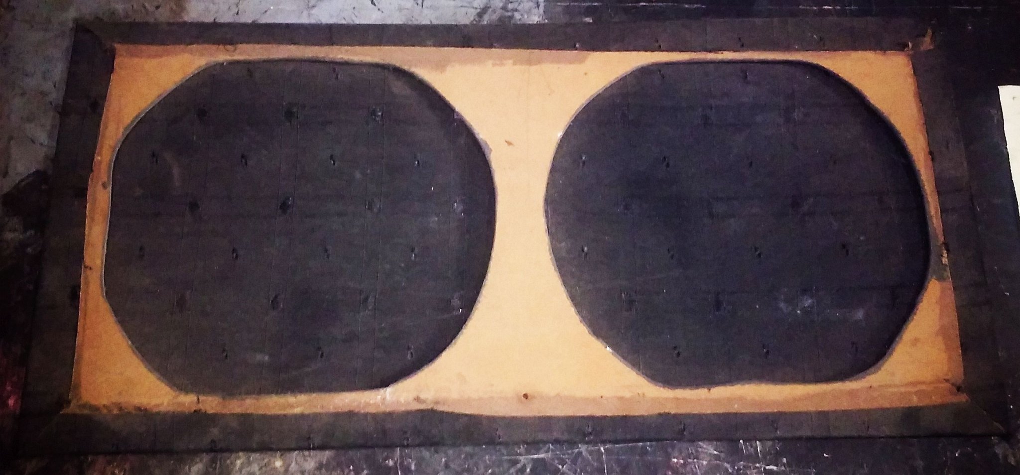

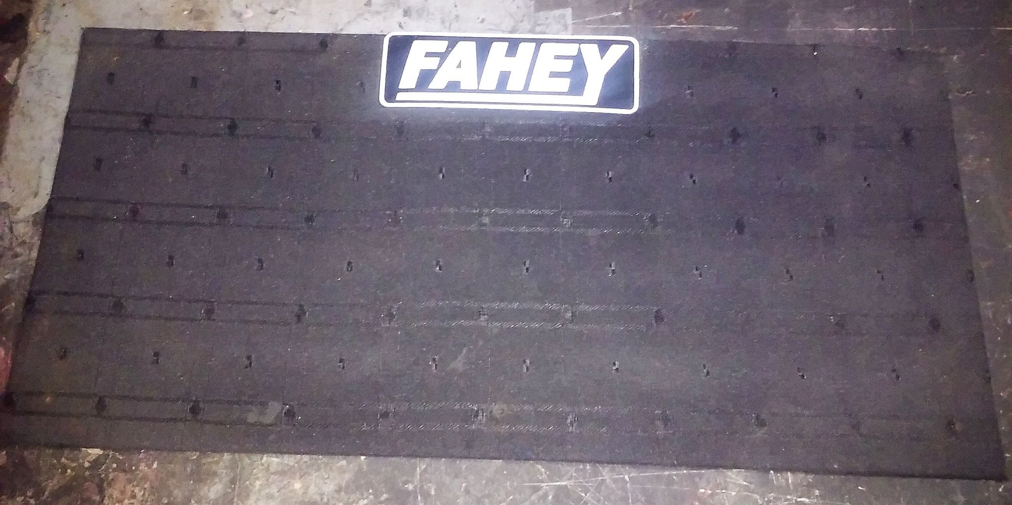

Just yesterday I made a cloth holding frame for a 2 x 10" 100W Guitar amp I am finishing, using hardboard and glued cloth (too thin frame to use staples)
Don´t worry, synthetic cloth is thin enough not to stop sound, just avoid thick heavy "furniture" type cloth or heavy curtains ,even worse if heavy wool or *thick*thread cotton or linen.
