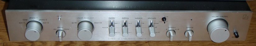

Luxman C 12
Service on Luxman C-12 PreAmp.
New caps for psu, & new filmcaps for signal (DC-block)
the input-selector was dismantled, cleaned and lubed.

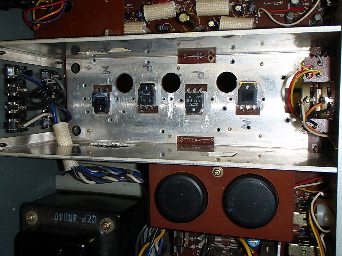

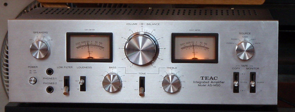

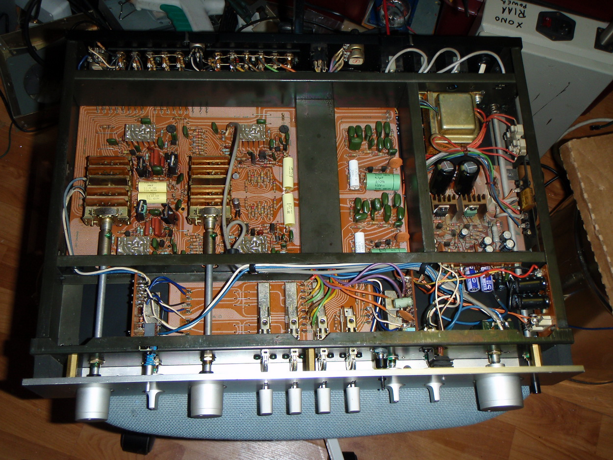

Teac AS-M50
Repairs for the amplifier: new output transistors, & a handful of smaller electrolytic-caps.
Arne K
i find that unexpectedly nice ... ( see other people's work )
one thing to say though
Number one rule for repairs like that in our shop is that here is no question about which electrolytic to replace ... Just replace them all
in the Luxman there is some that even can be seen with a naked eye that have been under thermal stress ... also there is some others that originally been placed horizontal ( these one should be dead too )
more or less is the same story for the Teac
