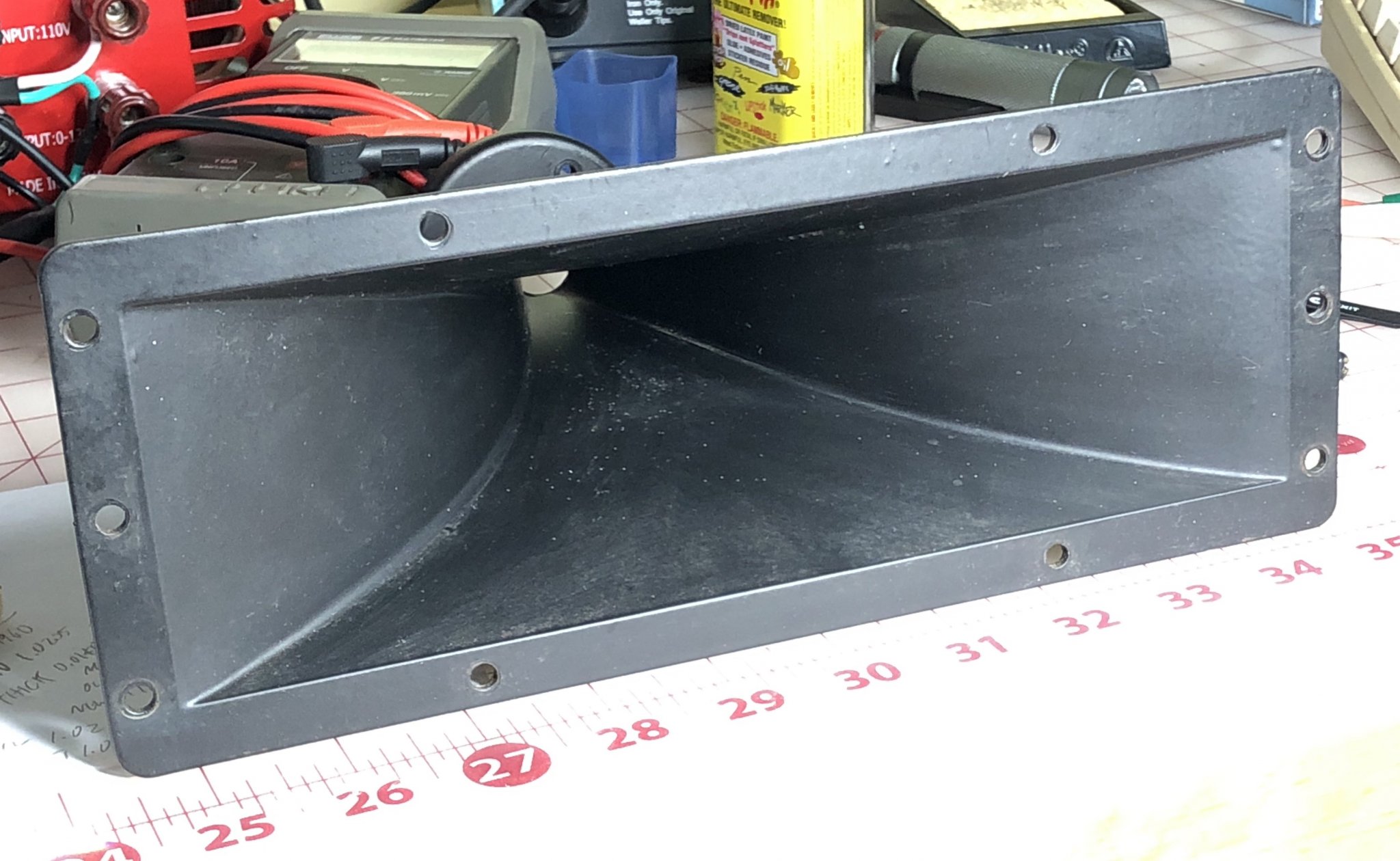

UPDATE: Have picked up a sheet of fiber/rubber gasket material that's labeled as 1/32" thick. I will have to do some more precise measuring to determine if I need one layer or two.
I've cut one gasket but after reassembling one horn with the gasket in place, it sounded terrible - no longer like a kazoo but with voice coil rub.
Long story short: the index holes in the new diaphragms don't really fit properly onto the pins that jut out of the magnet assembly. I've drilled those index holes out somewhat on one diaphragm so that I could slide it around and while running a 10-20Hz sinewave through the voice coil at a level such that I could see the dome move, I was able to scoot it around until the voice coil was not contacting anything. I managed to add the gasket, phase plug, and metal lens to the magnet and diaphragm and it appears like I have a second working unit. I'll want to test it some more before I decide whether I want to repeat the process on the other horn.
I had hoped that during the low-frequency test I would know that I had positioned the diaphragm properly when I could see the dome move but there was no sound, yet I could still hear a flapping sound when the dome didn't stop moving from being in contact with the magnet. I am assuming this is not a big deal because I was operating the diaphragm way, way outside of normal usage and that it's not representative of what happens post-crossover in the cabinet; otherwise there'd be a lot of distortion in the form of extra harmonics just from mechanical shenanigans in the diaphragm. I set up both horns side by side and ran sinewaves through them of varying non-insane frequencies and I was getting similar results from both but the one with the new diaphragm seemed a bit louder.
The best way to cut holes in gasket material or diapragms is a gasket punch set from some import tool shop. You select the right size, put the gasket on a piece of soft wood, and hit the tool with a hammer. You local auto supply as oriellys will have a selection of gasket materials they can order. Cork is soft, paper is medium, vinyl flooring material is hard. For more exotic materials like silicon rubber or buna rubber of various hardnesses, try mcmaster.com .
I'll remember that, thanks - although cutting the material with scissors and a utility knife and using a spring punch and drill for the screw holes worked just fine.The best way to cut holes in gasket material or diapragms is a gasket punch set from some import tool shop. You select the right size, put the gasket on a piece of soft wood, and hit the tool with a hammer. You local auto supply as oriellys will have a selection of gasket materials they can order. Cork is soft, paper is medium, vinyl flooring material is hard. For more exotic materials like silicon rubber or buna rubber of various hardnesses, try mcmaster.com .
Earlier today I tried running some program through the one horn in which I've installed the new diaphragm and the single layer of gasket that's between the diaphragm and the phase plug. The class-D Crown amp I'm using has front panel controls that let me interpose a highpass filter so I was running with that set somewhere around 900Hz. I had it turned up fairly loud - loud enough for me to have to wear hearing protection even at a distance - and I couldn't hear anything wrong. I was listening for harshness associated more with transients that would indicate voice coil rub but no such. I also hooked up the other horn with the one good original diaphragm in it for comparison and again, couldn't hear a problem. I ran sine sweeps through both and the one with the new diaphragm was noticeably louder. I was starting the sweeps at about 500Hz (probably too low) and the one with the new diaphragm did sound overworked until it got to about 800 where it kind of "barked" and then settled down.
So I think I'm going to run with this and repeat the process on the other horn. Then I suppose I'll test the two pairs of piezo tweeters and if they're all sorted I'll put everything together and see how they sound. I still have those two L-pads that I might choose to install for the midrange. However, it has also occurred to me that I could add an equalizer to the rig and I know I can remove a digital reverb that I'm not using or needing to make room for one.
Taking a pause to get the aluminum lenses of the Heppner drivers powder-coated by a guy who has done some work for me before. I had tried to clean them up with soap and water but they still looked a little ratty:
BTW I also brought along the phase plugs to get them blasted. Both were kind of rough with corrosion - not surprising for being 40+ years old and kept part of the time on a houseboat at a lake. 🙂 Once I get everything back, I'll buff them up with Maas metal polish and that should afford them a certain amount of protection going forward.
My powder-coat guy said that the finish defects apparent in the horns is due to the aluminum metal outgassing. It stands to reason that, as is the case with bullets (the metal's just for the weight), no one sweated the quality of the metal being used very hard.
Sadly, I'm not going to be able to go forward with the original Heppner horns even with the new diaphragms. I think I've been able to make one of them serviceable but the other one has a problem: its mounting flange at the throat end has a warp in it, I've tried to shim near the screw that has the warp but even with that, whereas I am able to position the diaphragm such that the voice coil isn't rubbing without the lens involved, as soon as I start tightening the screws with all the parts together (including my layer of gasket material that's needed to get the phase plug away far enough away from the diaphragm's dome), I can hear changes to the white noise I'm putting through it during assembly. I suppose I can try to put it all together with the one working original diaphragm and no gasket but including the shim, but it and the other horn won't be a sonic match. I was able to find a few sources for horns that resemble the GEM Sound unit the previous owner had replaced the blown horn with; I went ahead and ordered a pair given that I know they'll fit and that they're adequate. If it turns out that they're too sensitive for the rest of the cab, I can either add the L-pads I already have on hand or fix it in EQ.

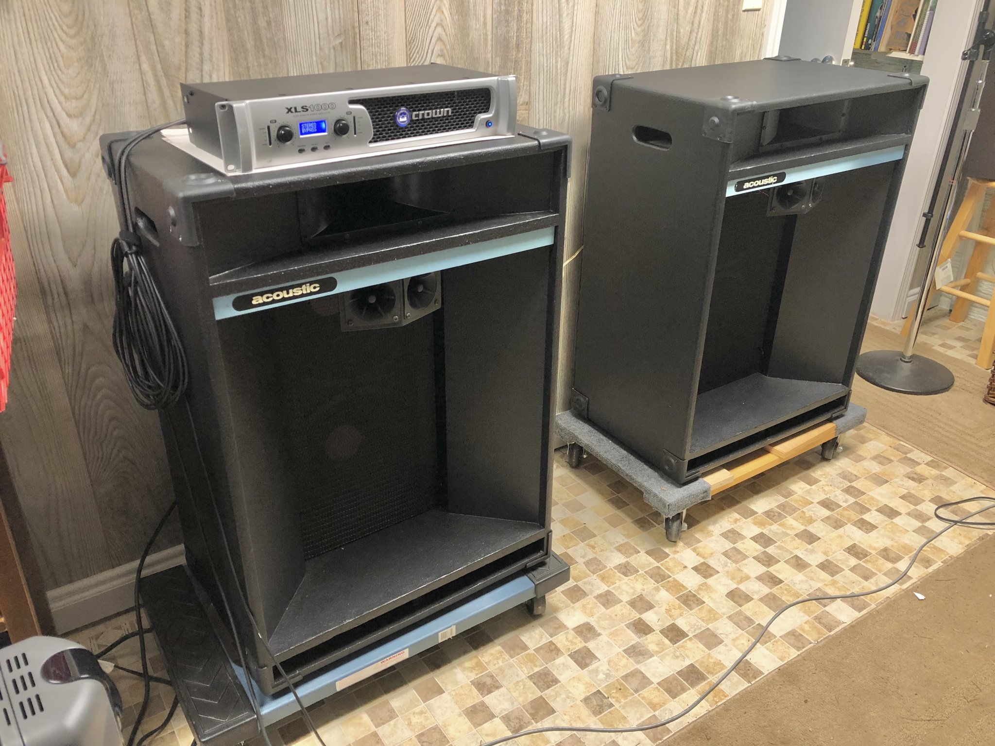

After getting the original Heppner horn with the blown voice coil back, I had the lenses powder-coated and I got hold of replacement diaphragms. Then two things went wrong: 1) one of the lenses had gotten warped at the rear mount plate - not sure when that happened but it was a dealbreaker 2) the registration holes in the diaphragm were not properly located to fit cleanly on the magnet assembly. I ultimately had to abandon using those. I ordered a pair of plastic-lensed horns from a vendor that just taped together a couple of retail boxes made of thin cardboard. Both arrived damaged and the vendor was simply unable to do anything but refund my money. So even though they were weirdly peaky I went back to the metal-horned replacement horns I'd ordered, took them to a machine shop to mill the long edges of the front mounting flange so they'd fit into the recess at the top of the cabinets, and carried on.
I hooked all four 12"s up on my workbench, connected them all up series-parallel to one side of that Crown power amp, and ran subsonic sinewaves through them just to make sure I had good cone movement. I did but I was getting some rubbing-like noise. I was partway through trying to source a quartet of new 12"s when I got curious about something and activated the Crown's built-in lowpass filter. The rubbing noise mostly went away; it was due to my cheap function generator.
One of the four piezos tested weak so I replaced them all - for less than $3 each new. Turned out one of the originals was an actual Motorola.
Plastic corner protectors and 1.5"-wide rubber feet have been added to the one cab I've finished.
Okay, now for the cool part. Last night I took a couple of songs, GTR's "When The Heart Rules The Mind" and Rush's "The Anarchist" (the latter of which has some tasty Moog Taurus pedal stomps (those things were AMAZING) and mixed them down to mono in the laptop which was connected to an audio interface feeding into one side of the Crown. The cab was up on a folding table and I was sitting on a stool at my workbench about eight feet away. The bass response was poor and the midrange was harsh. Then I stood up and the midrange calmed down. Then I took a few steps back in the garage...and the bass came up.
Turns out these cabs are crap at near-field. Running the finished one in the garage was the farthest I've ever been away from it running and I feel like the result at 50-75 feet would be even better. Now, ultimately my use case for the cabs is for a keyboard rig, not general PA, but what I discovered has shown me that I was right to believe that the original designers at Acoustic weren't fools. They're no Voice of the Theater I'm sure, but they tried to make something good by being a bit unconventional, as was their wont back then.
I'll post a photo of the one completed cab soon once I've cleaned up the grilles; they're pretty gross but I tried cleaning a patch in the middle of one and it looks like new there.

First, the cabs are put together and are in use. In fact, they saw service Halloween night - outdoors, playing my daughter's Halloween playlist for the trick-or-treaters. I ran audio through a Dynaco preamp from 1976 that has been sent to me for restoration; the tone controls helped bring out the bass and compensate for differences between the two cabs with respect to treble response.
They have new corners and feet and three coats of Exohyde paint. As mentioned before, the two 12"s in each one are original and both pairs of piezo tweeters have been replaced with new production because one of them had weak output.
The real problem has been the horns and I don't have a satisfactory solution in place yet. The two metal-lensed new-production replacements - the ones I took to a machine shop to have the long sides of the mounting flanges milled down - just don't sound good in the cabs and much of the problem seems to be that they're 8-ohm whereas the original Heppners are closer to 16 ohm (the DC resistance of the one good one is 15.4). I have the bad Heppner horn; it has two issues: 1) voice coil is open-circuited (no one makes a usable replacement diaphragm assembly) 2) the back end of the lens where the diaphragm assembly and magnet mount is warped. I can't remember if I'd said here, but I found a source for horns just like the GEM Sound one that the guy I'd bought the cabs from had put in as a replacement for the bad Heppner. They both arrived with damage because the vendor did a terrible job of packaging; I wound up effectively getting them for free. I've put one of those in because I was able to work around its damage. It works but that cab doesn't sound very good; I think the problem is that being 8-ohm, it's just taking more input power than the designers intended and so the cab winds up too mid-dy. The good Heppner is in the other cab and, other than the disappointing bass, it actually sounds pretty good. It's got a nice texture just playing music through it and really, playing music through them both isn't terribly objectionable especially if using the Dynaco's tone controls (nice that the two channels have separate bass and treble controls; when do you ever see that?). So I'm left really with three options: 1) replace the bad Heppner with a good one off the used market (yeah, wish me luck) 2) actually fixing the bad Heppner - rewind voice coil and somehow bend the flange back into shape (although I suppose 3D-printing a whole damn lens is one possible way to go but that's waaaay out of my ability) 3) put a power resistor in front of the too-loud replacement horn. Of those, 3 is the most practical; it's still going to be a compromise because power that's supposed to be going into sound will instead go into heat. I think what I will wind up doing is experimenting with values of low-power resistors (or more likely combinations of low-power resistors) hoping to get the two cabs to more or less sonically match up and I think that'll put me in a good place.
