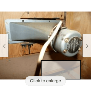

Here is photo of another Heppner speaker with similar basket and 575 code
The Horns appear to be Heppner as well

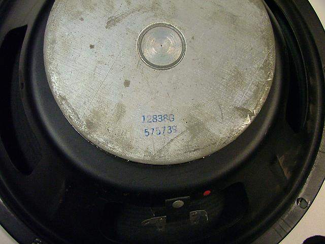

I appreciate the info; thanks. Any idea how the date codes work here?575 is EIA source code for Heppner Speakers
I dont know exactly how the date codes work.
usually if only 3 numbers following EIA , means its a single digit year code, then week number.
So with single digit you would have to know the era.
575629 = 575 (6) year 29 week
575723 = 575 (7) year 23 week
575 is manufacture EIA source code
its likely
1976 29th week
1977 23rd week
single digit years is usually very old stuff from 1940 to 60's
but some companies used single digit up to the 70's
so don't hold me too it LOL
Heppner I believe was bought by Cerwin Vega in late 70's
So these speakers you have were probably made towards the end

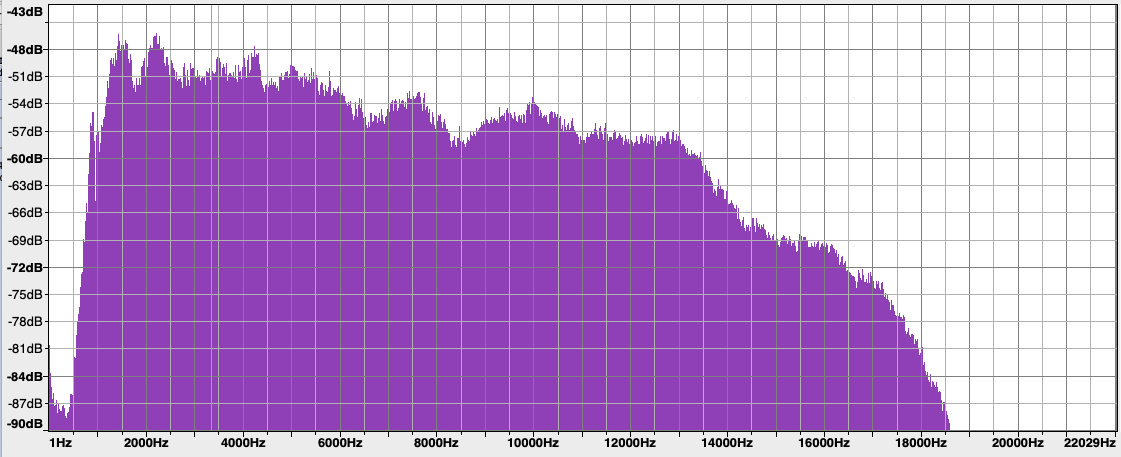

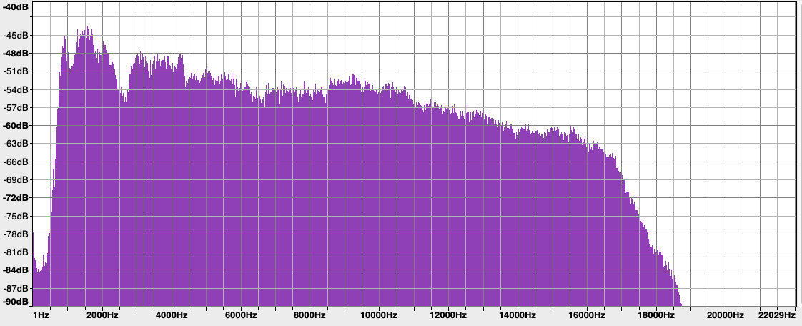

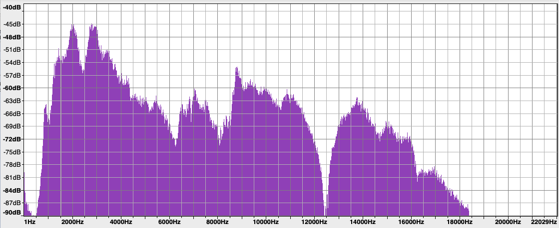

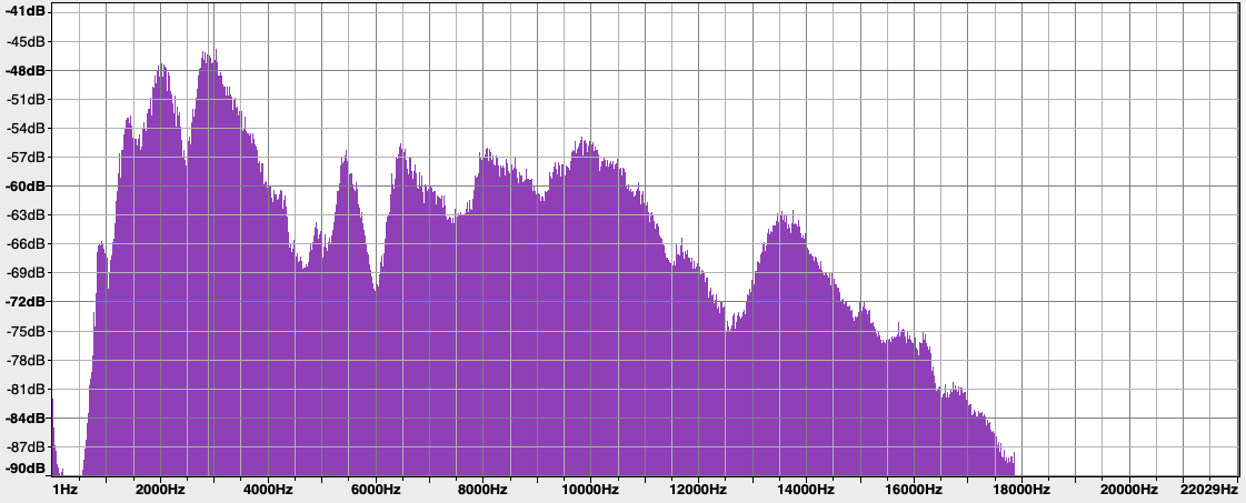

Here's the latest. Before I trimmed the long edges of the Studio Z T-122 horns from Simply Speakers and making them unreturnable, I wanted to hook them up and verify that they worked. To my disappointment, they didn't sound the same at all with white noise running through them, so I set up a large-diaphragm mic and recorded white noise output so I could get spectra.
Here's "left:"
and here's "right:"
By comparison, here are the two horns (the plastic-horned Gem Sound replacement and the original Heppner) that these T-122s were supposed to replace:
The Studio Z horns are awfully peaky - and how about the I-got-nuthin' -45db-down notch at ~12.4kHz?? But even down where things are more audible (and in the post-crossover range they would receive) that's really uneven and not consistently so between the two speakers. I thought maybe it was due to the metal horns ringing (if you strike them or even rub the edge with your hand they "sing" at about 6k) but I tried again with alternately grabbing the horns with both hands and releasing them and it made no difference. So I think I need to get in touch with Simply Speakers and ask for a recommendation. Getting the blown original back from the original owner is looking better and better.
