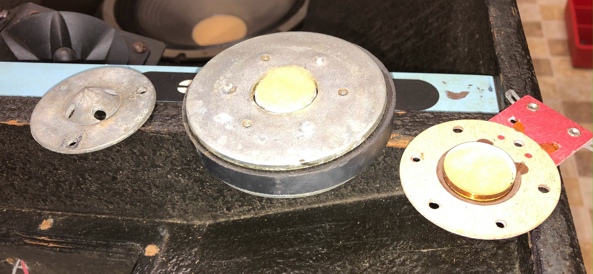

I've cut one gasket but after reassembling one horn with the gasket in place, it sounded terrible - no longer like a kazoo but with voice coil rub.
Long story short: the index holes in the new diaphragms don't really fit properly onto the pins that jut out of the magnet assembly. I've drilled those index holes out somewhat on one diaphragm so that I could slide it around and while running a 10-20Hz sinewave through the voice coil at a level such that I could see the dome move, I was able to scoot it around until the voice coil was not contacting anything. I managed to add the gasket, phase plug, and metal lens to the magnet and diaphragm and it appears like I have a second working unit. I'll want to test it some more before I decide whether I want to repeat the process on the other horn.
I had hoped that during the low-frequency test I would know that I had positioned the diaphragm properly when I could see the dome move but there was no sound, yet I could still hear a flapping sound when the dome didn't stop moving from being in contact with the magnet. I am assuming this is not a big deal because I was operating the diaphragm way, way outside of normal usage and that it's not representative of what happens post-crossover in the cabinet; otherwise there'd be a lot of distortion in the form of extra harmonics just from mechanical shenanigans in the diaphragm. I set up both horns side by side and ran sinewaves through them of varying non-insane frequencies and I was getting similar results from both but the one with the new diaphragm seemed a bit louder.

Taking a pause to get the aluminum lenses of the Heppner drivers powder-coated by a guy who has done some work for me before. I had tried to clean them up with soap and water but they still looked a little ratty:
BTW I also brought along the phase plugs to get them blasted. Both were kind of rough with corrosion - not surprising for being 40+ years old and kept part of the time on a houseboat at a lake. 🙂 Once I get everything back, I'll buff them up with Maas metal polish and that should afford them a certain amount of protection going forward.
My powder-coat guy said that the finish defects apparent in the horns is due to the aluminum metal outgassing. It stands to reason that, as is the case with bullets (the metal's just for the weight), no one sweated the quality of the metal being used very hard.
Sadly, I'm not going to be able to go forward with the original Heppner horns even with the new diaphragms. I think I've been able to make one of them serviceable but the other one has a problem: its mounting flange at the throat end has a warp in it, I've tried to shim near the screw that has the warp but even with that, whereas I am able to position the diaphragm such that the voice coil isn't rubbing without the lens involved, as soon as I start tightening the screws with all the parts together (including my layer of gasket material that's needed to get the phase plug away far enough away from the diaphragm's dome), I can hear changes to the white noise I'm putting through it during assembly. I suppose I can try to put it all together with the one working original diaphragm and no gasket but including the shim, but it and the other horn won't be a sonic match. I was able to find a few sources for horns that resemble the GEM Sound unit the previous owner had replaced the blown horn with; I went ahead and ordered a pair given that I know they'll fit and that they're adequate. If it turns out that they're too sensitive for the rest of the cab, I can either add the L-pads I already have on hand or fix it in EQ.

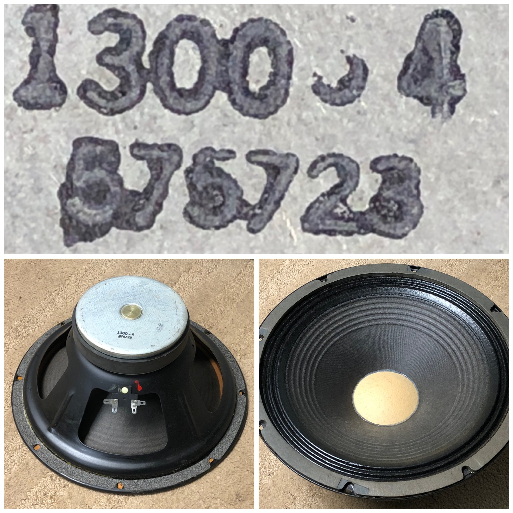

Thank you for taking the time to respond. No, they really are; the upper 12" is in its own little box
The DC resistances of each of the 12"s was around 7.4 ohms and the original horn was like 15.1

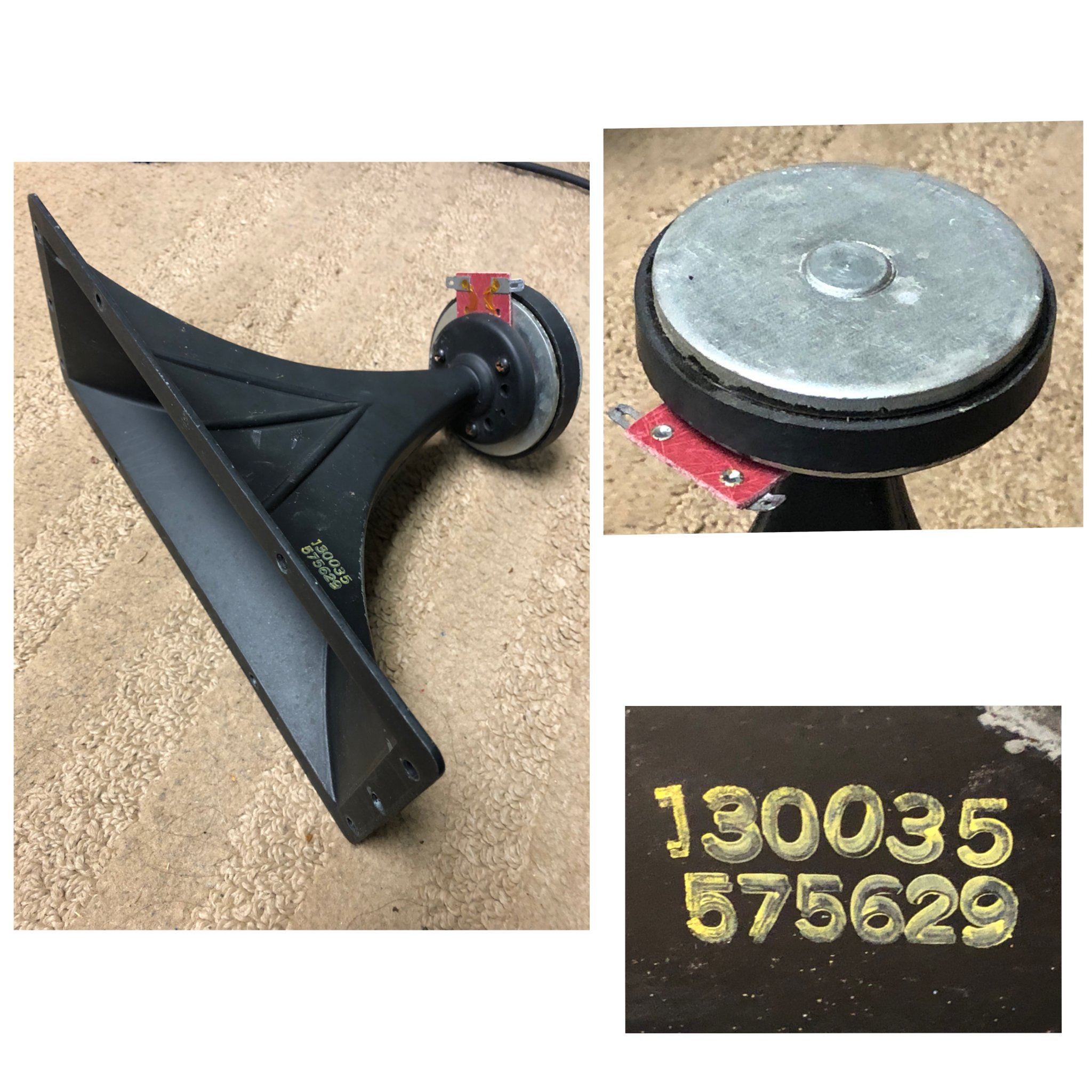

Haven't been able to tell; I haven't removed it and I haven't been able to make out any markings yet. Would you advocate for putting the lamp at the same location as the circuit breaker and leaving the big power resistor(s) that is(are) connected in parallel across it as-is? I was surprised the breaker wasn't right at the speaker input ahead of the crossover.
I'll certainly take that into consideration. Could I just use those L-pads I bought in front of the mid horns?
Will do. Circular ceramic-magnet arrangement in the back. I've forgotten the code stamp but looking it up told me Matsushita/Panasonic.

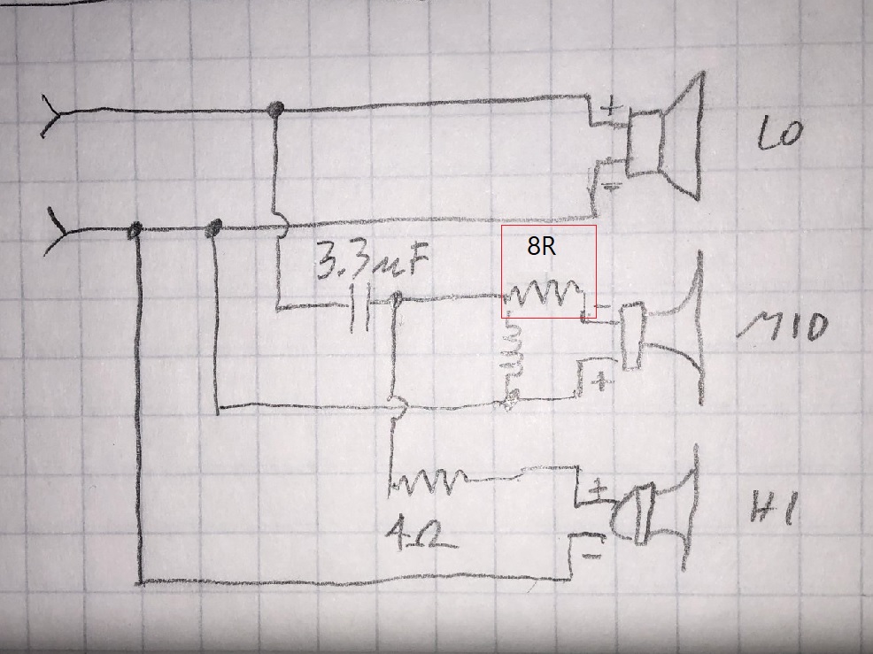

Understood. One thing about the original crossover is that its coils are really big - much bigger than the ones on the PE crossover. Like, one of them looks like they just used a spool that wire comes on to make it out of. 🙂
That was kind of my original approach but I wanted to see if I could reasonably improve on it any, thinking that the original crossover may have been just barely adequate (perhaps tipping into inadequate) in order to meet a price point.
OK, certainly not at DC or freqs below their rating, but what about in the PE crossover's >5kHz high output? Or is this simply a bad match?

  • Would it be a good idea to replace those 3.3uF capacitors with prejudice? I mean, I could lift one leg and test them but if I'm going to do that, why wouldn't I just replace them? If I do, are there any formulations of cap to avoid (I know not to use electrolytic)?

After getting the original Heppner horn with the blown voice coil back, I had the lenses powder-coated and I got hold of replacement diaphragms. Then two things went wrong: 1) one of the lenses had gotten warped at the rear mount plate - not sure when that happened but it was a dealbreaker 2) the registration holes in the diaphragm were not properly located to fit cleanly on the magnet assembly. I ultimately had to abandon using those. I ordered a pair of plastic-lensed horns from a vendor that just taped together a couple of retail boxes made of thin cardboard. Both arrived damaged and the vendor was simply unable to do anything but refund my money. So even though they were weirdly peaky I went back to the metal-horned replacement horns I'd ordered, took them to a machine shop to mill the long edges of the front mounting flange so they'd fit into the recess at the top of the cabinets, and carried on.
I hooked all four 12"s up on my workbench, connected them all up series-parallel to one side of that Crown power amp, and ran subsonic sinewaves through them just to make sure I had good cone movement. I did but I was getting some rubbing-like noise. I was partway through trying to source a quartet of new 12"s when I got curious about something and activated the Crown's built-in lowpass filter. The rubbing noise mostly went away; it was due to my cheap function generator.

The real problem has been the horns and I don't have a satisfactory solution in place yet. The two metal-lensed new-production replacements - the ones I took to a machine shop to have the long sides of the mounting flanges milled down - just don't sound good in the cabs and much of the problem seems to be that they're 8-ohm whereas the original Heppners are closer to 16 ohm (the DC resistance of the one good one is 15.4). I have the bad Heppner horn; it has two issues: 1) voice coil is open-circuited (no one makes a usable replacement diaphragm assembly) 2) the back end of the lens where the diaphragm assembly and magnet mount is warped. I can't remember if I'd said here, but I found a source for horns just like the GEM Sound one that the guy I'd bought the cabs from had put in as a replacement for the bad Heppner. They both arrived with damage because the vendor did a terrible job of packaging; I wound up effectively getting them for free. I've put one of those in because I was able to work around its damage. It works but that cab doesn't sound very good; I think the problem is that being 8-ohm, it's just taking more input power than the designers intended and so the cab winds up too mid-dy. The good Heppner is in the other cab and, other than the disappointing bass, it actually sounds pretty good. It's got a nice texture just playing music through it and really, playing music through them both isn't terribly objectionable especially if using the Dynaco's tone controls (nice that the two channels have separate bass and treble controls; when do you ever see that?). So I'm left really with three options: 1) replace the bad Heppner with a good one off the used market (yeah, wish me luck) 2) actually fixing the bad Heppner - rewind voice coil and somehow bend the flange back into shape (although I suppose 3D-printing a whole damn lens is one possible way to go but that's waaaay out of my ability) 3) put a power resistor in front of the too-loud replacement horn. Of those, 3 is the most practical; it's still going to be a compromise because power that's supposed to be going into sound will instead go into heat. I think what I will wind up doing is experimenting with values of low-power resistors (or more likely combinations of low-power resistors) hoping to get the two cabs to more or less sonically match up and I think that'll put me in a good place.

As I mentioned before I've had these things for a long time and over the years I've made any number of modifications to the wiring including ditching the 1/4" jacks on the back. Not unexpectedly I'd lost track of where everything was supposed to go on the crossover lugs and it was your hand drawn sketch that gave me a glimmer of hope that I could find my way back. With some head scratching and a bit of testing I think I finally arrived at the correct connections, at least everything seems in balance, and for now I'm one happy camper!
I do have one question about that diagram. In it you show the mid range horn connected with a reverse polarity...is that what you intended? I assumed it was a mistake and did not go that route, but I was curious if I missed something.

Midnitmike - I never did respond to your question; sorry. I drew the diagram with the polarities the way I found them. I've tried switching it around on the horn and I'm not sure it matters all that much, to be honest. The low, mid, and high drivers are all at different depths from the front of the cabinet...what I figure is most important is, which polarity produces the most even response far-field or, to put it another way, which polarity is making the best use of amplifier power? I find it interesting that the original Heppner horn appears to be 16-ohm when the two paralleled 12"s present 8 ohms and the cab itself is rated 8 ohms; it's like they were adjusting driver level by power-splitting via impedance. This is one reason why I turned away from replacing the original crossovers; the same people who designed them were the same people who specced a 16-ohm horn.
Here's what that article about the A-L VotT speakers had to say on the subject of phase:
These systems are intended to be listened to at a distance, in a wide and fairly flat room with a tapered floor, so that most of the listeners are in the same vertical plane as the speaker. They might be a bit higher or lower if they are seated in the front or back rows but they won’t be too far off. As a consequence, the phase coherency in the horizontal plane was not something about which the designers of these speakers ever cared.
I expect the engineers at Acoustic were of similar mind.
