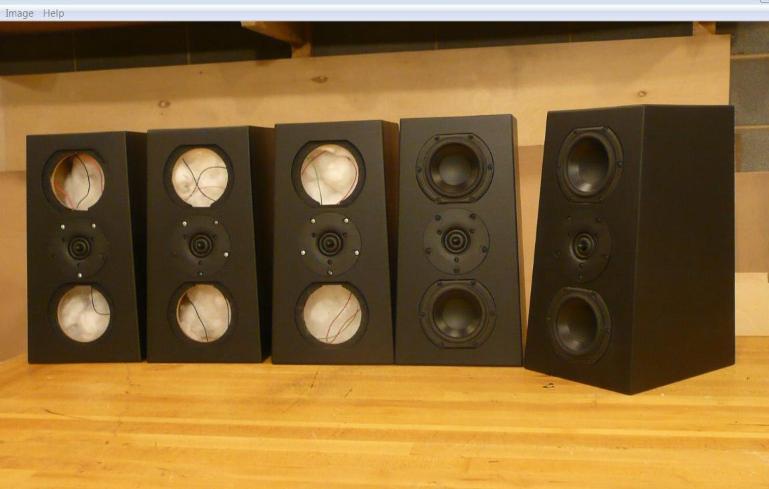

Tweeters on the bookshelf
In my last build I had similar problems where the boxes were to be on a bookshelf and close to wall. After listening to many options I found that having the tweeter in a waveguide as described by Zaph worked the best for avoiding reflection from the wall. This was the only option that had reasonable imaging and clarity. I used a scanspeak dome but the Vifa tweeter is supposed to be quite good for this.
Waveguide I think will raise up response in some range? And would need additional tweaking? I will look at that though, seems pretty interesting. Big thanks!
A wave guide solves so many problems that in my opinion, its silly not to use one. Dave Pellegrene has a 6x4" guide that will allow a 2000 cross or the 8x6 I used to cross lower to a Seas 7" poly cone that has little to no break up and a really clean low end. A simple 3.3 to 4.0 cap will hammer the response back to near normal and it takes the distortion down with it. The seas is a bit out of your budget but you can find used drivers too. Just throwing ideas out to research.
The Madisound Speaker Store
Here is my build. The thread didn't get much of a reaction but at least it illustrates what the wave guide does and how it attaches. I hope its of use to you:
http://www.diyaudio.com/forums/multi-way/241286-my-first-wave-guide-speaker-lots-pics.html
The wave guide increases dispersion to be excellent anywhere in the room and cleans up the low end of the XT25. It lifts the response 8-9db in the low and middle tweeter range making it work with a fraction of the power the unit normally needs making it really clean sounding.
