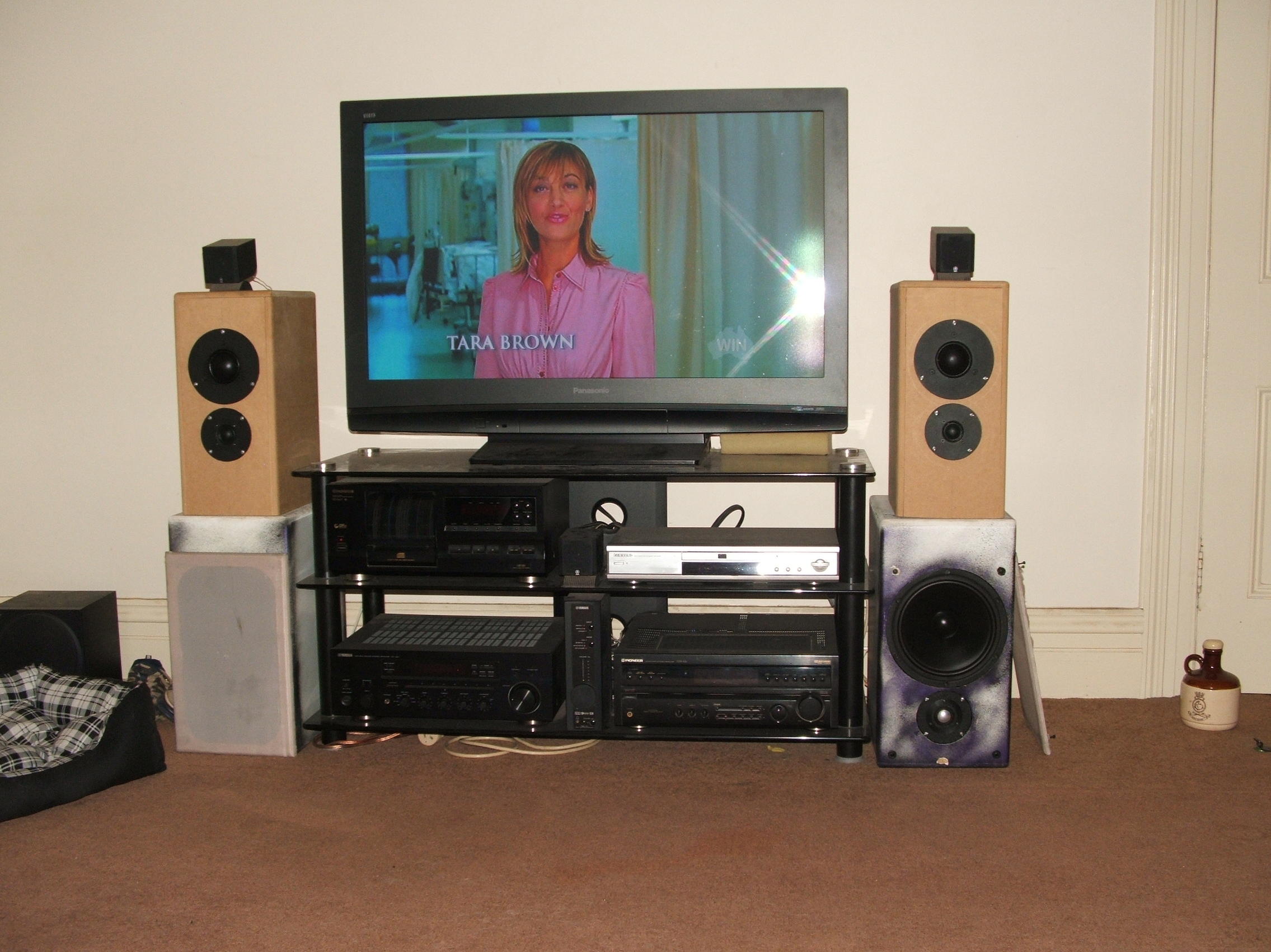

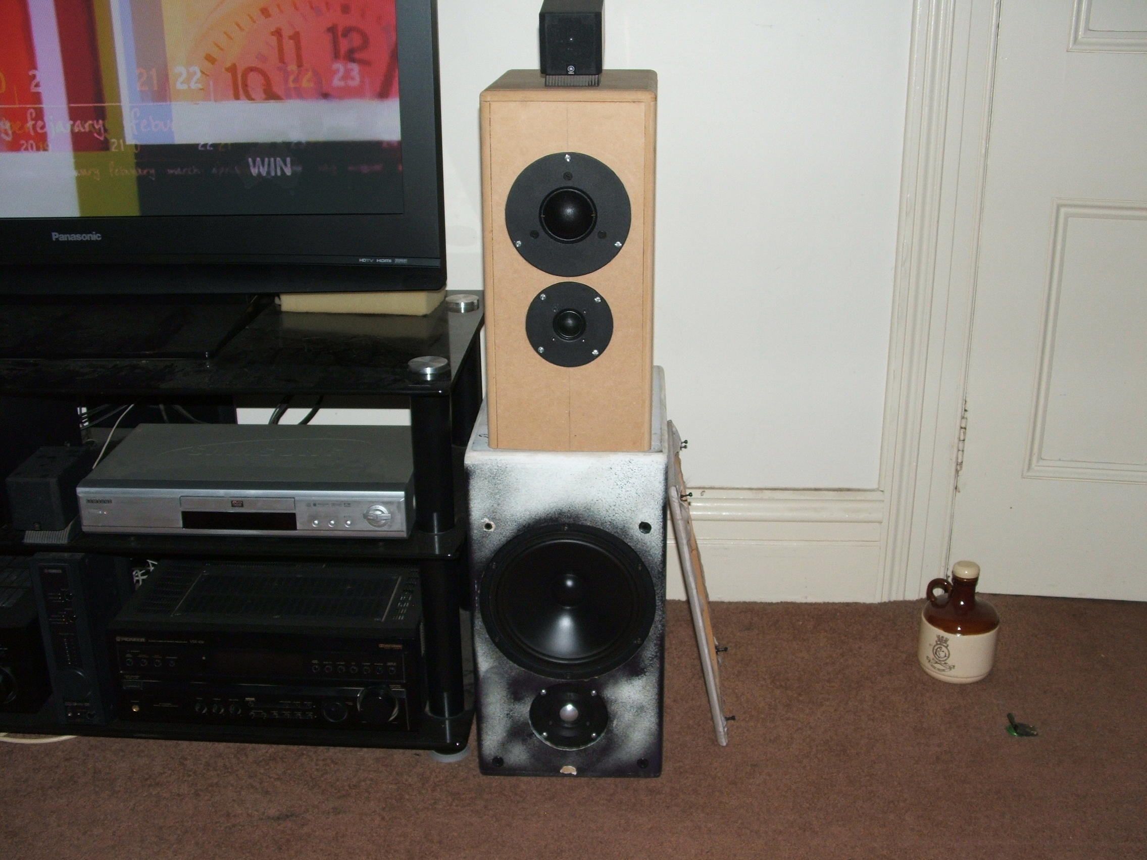

Well, I have discovered a new breed of feral, Its the result of crossing the notorious feral tower with the leaking mongrel.
The leaking mongrels were dragged (kicking and screaming) out of the shed, a VERY thick smear of grease or silicon, was applied to anywhere a leak may have been hiding, and, hey presto, no 80hz dip!! (Its now @ 31hz and keeps rolling off!).😀
The feral towers were lopped off @ the top (ish), and now, using the leaking mongrels (tweeter disconnected), and the feral towers (woofers hacked off), I present to you 'The feral mongrels!!'
Funny thing is, for a pair of fugly feral mongrels, they actually sound bloody good! Can't wait to 'Have a tweak!'
Anyhow heres the photos of 'em, (Brace yourself!!). Now thats feral!!!!
woooo hoooo!, Mick.

LOL well done Mick, good ol aussie ingenuity!!! I actually think that they don't look to bad at all.

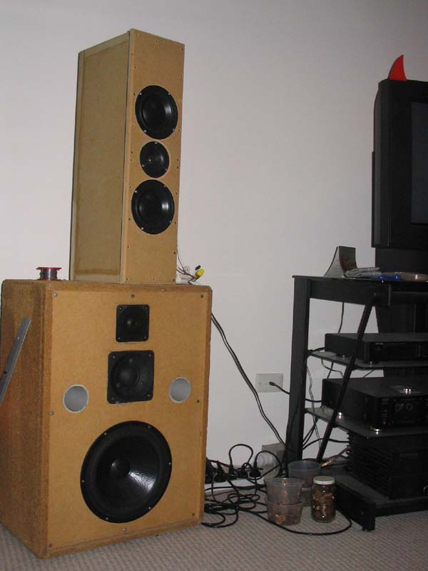

I think you might be right Mick (about trying to seal them but trust me it won't be easy. I did paint them recently thought and I wasn't sure but I thought it might actually have made a difference....
Now you reckon yours are ferral, take a look at this pic I took a while back when I was testing my prototype MTM.
They look slightly better now that I've painted them flat black... 20+ years and I finally got around to it 😉 I've also replaced the horrid woven grill cloth as seen in this pick with some black stuff from Jaycar. Amazing the transformation!

Tony,
No points for second place mate! mine are way feraler (is that a word?).
Yours look like an unfinished project, Mine just look plain feral!
Maybe we should hold the inaugural feral speaker build international this year!!😀
