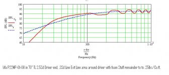

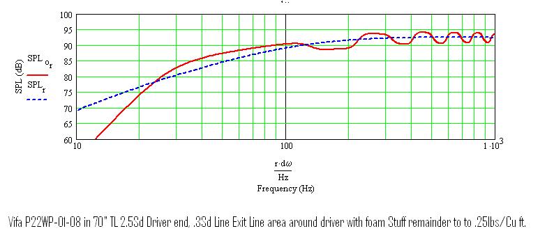

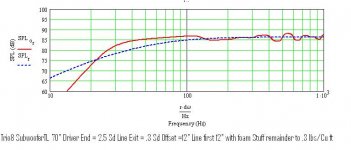

I've got a pair of these in 70" TL's and I'm disappointed with the bass; although they have extension, they are distinctly 'thin' and 'lean' sounding. My last TL's had 10" Focals and would find every loose object in the room and rattle it
, so these Vifa's have been a letdown. The MJK Mathcad macro download predicted this very well; wish I had used it. What the hey, only paid $25 ea for the Vifas. Below is the predicted response for the P22 WP's. The Dayton Reference 8 sub and the Trio 8 sub are included for comparison, though at the prices it not really a fair comparison, just a reality check. The Dayton 8 classic looks very good though, and is only $29.
Low Q in a TL = expensive bass cut. Look for Q of .35 -.5.
Jim
Jim

I recon the best test would be an impeadance plot, but an spl meter won't give you that. Only reason I say that is that if there is anything weird going on inside the cabinet, reflections, refractions etc then they should show up as anomilies in the impeadance plot.
I recon it would be interesting to put some damping material around that port and maybe even put some loose stuffing (polyester fibre or the like) in it. certainly doing some measurements with the SPL meter to see what (if any) difference this makes would be a good idea!
Tony.
Tony.
