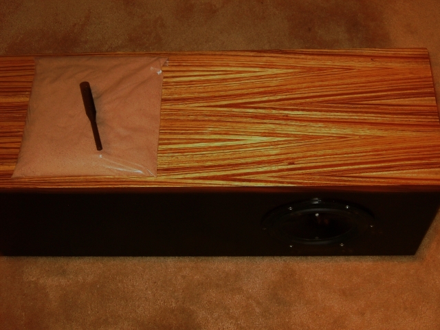

TLs are very forgiving about design, much more than bass reflex. I built a 6 ft. taped line with a Dayton RS270S-8 10. It is pretty simular to the Tritrix line but is 12" wide with a little longer line, done by increasing the length of the back baffle. The enclosure volume is about 3 cubic feet. It is 3 dB down at 40 Hz. It sounds better than an Eton 10" in a 100 pound bass reflex. There are dozens of TL designs on the web and most are pretty forgiving of the driver used.
http://www.parts-express.com/projectshowcase/indexn.cfm?project=Tritrix
http://www.flickr.com/photos/7567821@N05/?saved=1
Finished TL withe Zebra wood veneer
Finished TL mounted wth spikes to floor. Sideways mounting loads driver with 2 pi steradians floor loading for better efficiency. One of the spikes is closely coupled to the woofer mounting frame with short stiff bracing to minimize motion of the woofer motor. This can be achived with high enclosure mass or coupling to the concrete floor with spikes. My back doesn't like moving 100 pound plus speakers...

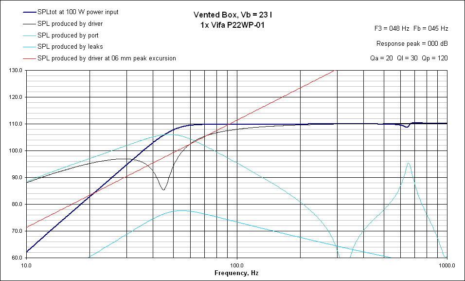

I have attached pics of the 23 ltr BR 2 ways, (the ones that had the dip).

OK, you still haven't posted the cab's internal dims/woofer cutout location and I assume the vent is attached to the bottom plate (can't get the thumbnails to open). Regardless, I see nothing to indicate a ~80 Hz dip other than possibly an air leak that will cause a suck-out (had this happen the other day) and with it simming a max flat alignment, such a small cab needs some form of BSC filter to tonally balance it down to ~40 Hz if not a near-field app. This will cover most recorded music if the dip can be be rectified.

Anyhooo, The cabs int. dimensions are 200x320x420 and the port is attached to the bottom. The port is made from 12 mm mdf and is actually 195mm long internally +25mm cab wall thickness (sorry, I think I quoted 190 total in a previous thread). The bass driver was centre and centred 210mm from external bottom (185 internal). Both channels seemed to have the same problem and talcam powder was used to find any leaks, although none were evident. Is this a sound method for finding leaks?
A bsc was used, however it didn't seem to do much (if anything to the dip) except tone down and clean up the midrange, ....seemed to intergrate the whole sound alot better.

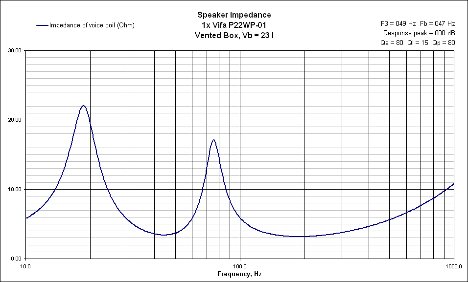

Hi Tony,
Geez, I gotta say, that impedence peak is sitting right there isn't it!
I agree that there may be somthing in that, almost certainly, its awfully sharp, and bang where I was hearing the problem!
The 30 ltr box internally measures h990xw150xd220 and the port measures 80x50x145, I agree that the side firing idea was not a good 1, huge bsc troubles i think is the biggest
trouble here, although the high xover point is also a big problem. I built these on a whim,
and was doubtful of their success from square 1, which is why they are not long for this earth.
But again that impedence line is scarily close to where I was hearing the problem!😱
Far too close to be a mere coincidence I feel.
I'm interested to see if the 30 ltr box shows the same problem?

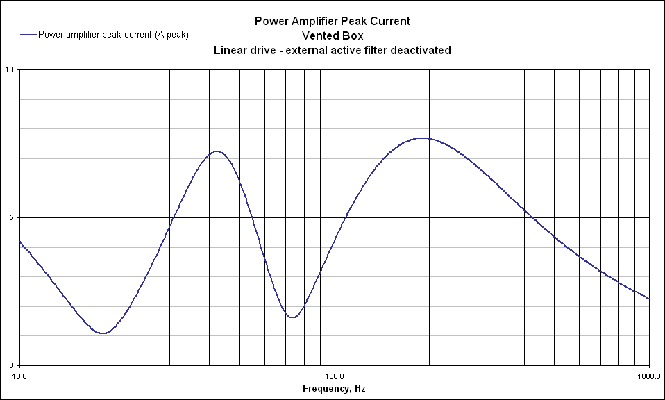

yep it does plot the theoretical SPL but no effect shown for the impedance peaks... the current for the amp is interesting though, and may be more telling, ie due to the higher impedance the current at that freq is quite low, as power = Volt's X Amps I guess it stands to reason that you will have a dip at the impedance peak. I'll have to read up on BR again (as this could well be complete rubbish), This may be one of the tradeoffs (much poorer transient response was the main one I could remember).
The zobel shouldn't affect this particular impedance peak. From memory it is due to your box tuning. Bass reflex has two impedance peaks not one.
One thing I did think of this morning though was the positioning of your port in the 23L boxes. Since it is on the floor of the box rear facing and directly behind the woofer you may be getting some sort of diffraction or other effect I noted some quite marked effects in woofer response (sealed box) in nearfield measurements just from having a 1" sqaure brace directly behind the woofer, this was at around 700Hz but removing the brace removed the anomaly completely. I wouldn't rule out the port being the culprit. Do a search on port placement, I think I vaugly remember something about NOT putting it directly behind the woofer.

OK, using MJK's software which is the most accurate I have, cab tuning is right at 50 Hz and has strong vent pipe harmonics out in the 700-900 Hz BW, though MJK has noted that the accuracy falls off above 500 Hz, so could be insignificant. Bottom line, I don't see anything in the cab design that could create a ~80 Hz dip.
Never tried talcum powder, just the traditional soapy water with the vent plugged if applicable. Did you plug the vents?
No, BSC shouldn't have affected any dip, just increased tonal balance to a lower frequency, which it did.
'Near-field app' just refers to sitting close to the speakers, like at your computer. If the dip was in anyway room related it would disappear, but from your comments I guess it's not.

I don't think a side firing woofer was probably a great idea if it was playing up to 600Hz especially if it is a 1st order crossover!
It would be interesting to model it in unibox. I did the 23L and it seems to be not bad at all.
Only thing I noticed was that one of the impedance peaks.........
Yeah, not a good plan. Normally you want to limit the distance 'around the bend' to 1 WL of the XO's HF -12 dB point.

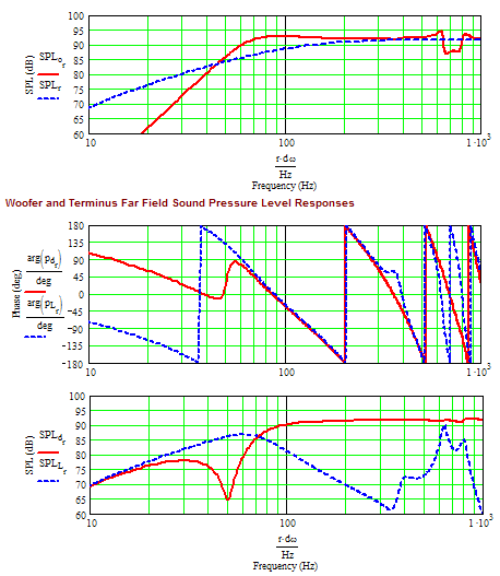

Unfortunately, Unibox can't even model the 23 L box fairly accurately since it assumes a ~uniform particle density in the cab, i.e. an ideal Helmholtz resonator, so no hope of accurately modeling a tower design (aka MLTL) that has some 1/4 WL pipe resonances affecting vent tuning.
The impedance peaks can affect response if the amp can't deal with them, such as a high output impedance tube amp that tracks the impedance peaks/dips or if it has a weak power supply such as the entry level 'T' amp that dips at a high impedance, but since more than one amp has been used with the dip still present I don't see how it could be the problem.

Thanx again Tony,
I now have unibox up and running, (I found my office pro 2003 repair disc), although it may take a day or two to learn how to drive it.
I'm not sure this peak is the one the zobel is aimed at, as I understand it, the zobel is aimed at the rising impedence that occurs as frequency rises, (further to the right of the graph) 🙂.
What your saying is making a lot of sense, and the 'mysterious dip' may not be all that mysterious after all! (At least I know my ears arn't crazy!).
I think I have also read that BRs are meant to have two peaks, but this is the first time I have actually heard it, if that is its cause.
Could it be a combination of port placement/shape + the high impedence causing the spl drop THAT much.
