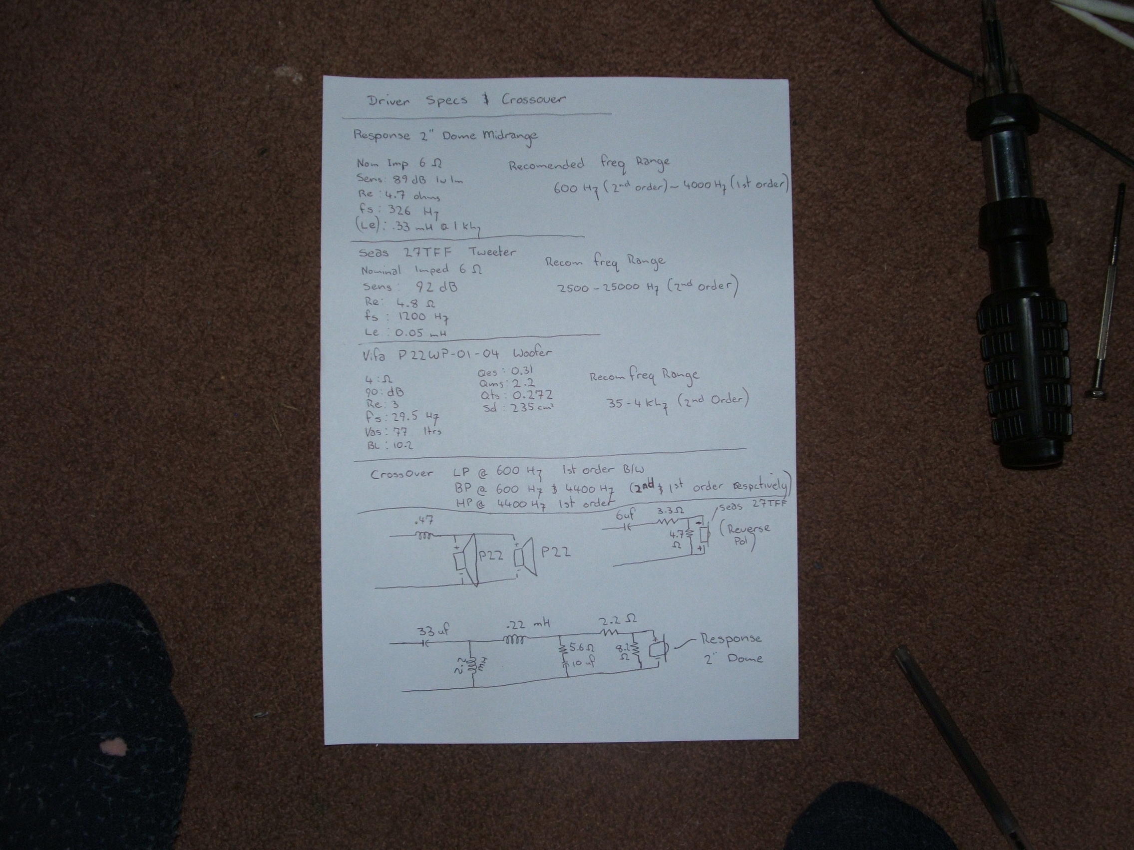

Just toying with the idea of a transmission line setup using the vifa p22wp-01
in a three-way set up, but just not sure exactly where to start.
SPECS; 4 ohm nom
RE. 3.0
fs 30 Hz
qms 2.2
qes .31
qts .272
sd 235 cm2
vas 77
90 db sens
bl 10.2
I'm led to believe the specs make it a fairly good candidate for a tl, although i'm not sure what makes it so.......... I have used them in BR with good results, however i feel that these drivers have more to give than i can extract from them in a bass reflex design. I would love to make this project fly but i'm not sure how to work out taper ratios, driver placement and other associated hoo haa for a given driver. If i could get them going without destroying an entire rain forrest, that would be a big bonus
. If you have trudged down this road b4 what advice could you give (Other than, GIVE UP!!!!)

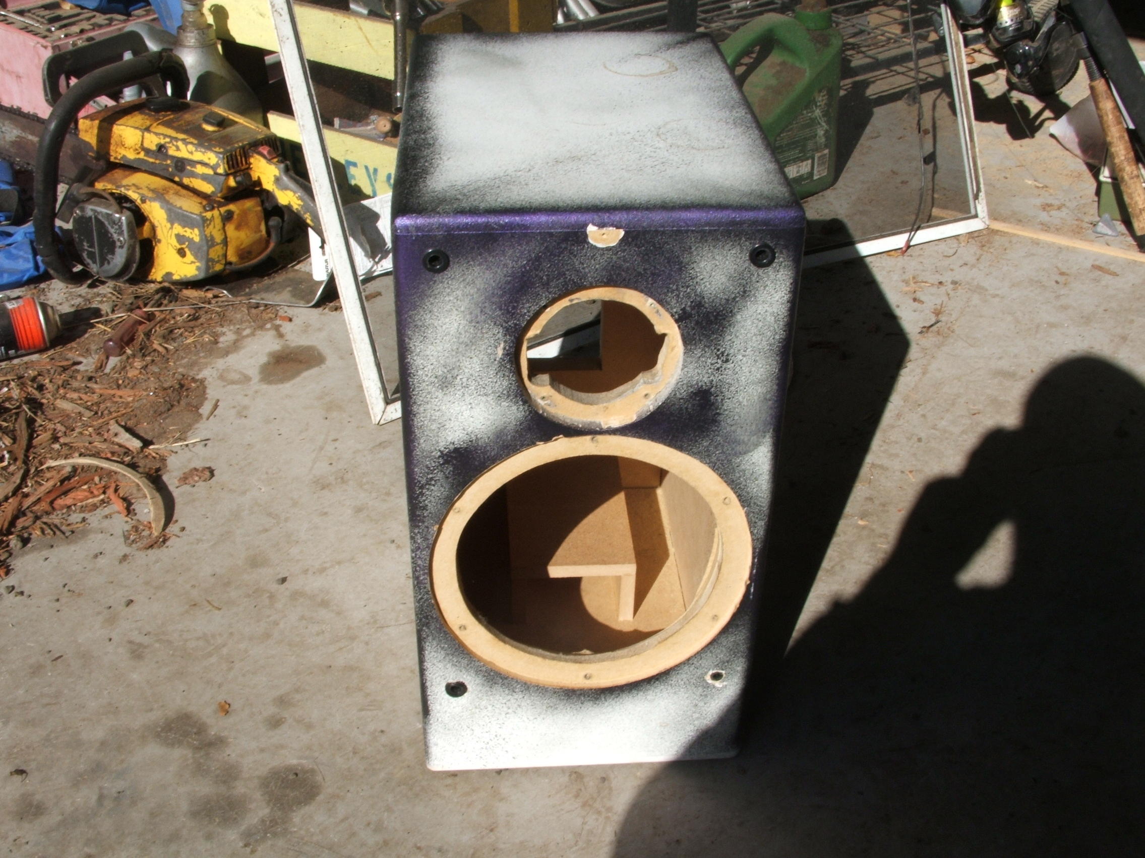

This is my latest project, and its a dismal failure. Such a failure in fact that I shall totally (almost) clean sheat it
Hence the reason for looking at a transmission line enclosure.
The midrange to top end is as sweat as anything i've heard, to be honest, open almost to a fault, tons of head room, astounding detail, yet never hisses an ess, listening to Dianna krall, Donald Fagen, and the like, (except on overly bright recordings, ie, some modern pop and the like). Imaging in this range is dead bang pinpoint. Sound stage is nice and wide, and sounds like vocals are coming from dead centre and five feet back. It is therefore this part that I really need to keep intact.
But then the bass is just plain crap, as sweat as the rest of it is , the bass is a polar opposite to be frank.
I guess the side firing bass is a good concept, if you hold bass directly responsible for the global financial crisis........... WOW what a flop!
In a vain attempt to save face (and bass), I plugged the bass port completely, (the bass port is actually external) and added another bass driver in parallel, (I did this because the box was 30 ltrs and winisd tells me a sealed box for 1 bass driver is 13 ltrs), and halved the value of the 1st order slope on the xo. That helped a little but is far from a cure. Clean sheet me thinks.
The best bass i've had from them so far is the 23 ltr box I mentioned in an earlier post, Except for that annoying dip at around 80 hz that I could not seem to cure, which gave them a 'lack of bass attack' sound, although the rest of it (bass) sounded tight, clean, and powerful with good extension.
Could the box LxWxH ratios have caused this? Seems like a likely suspect as far as I can tell.
Figure the 23 ltr box, rear vented, but all drivers on the front baffle might be the go. That is in keeping with the KISS principle.
As you can see from the photos, I have experience, but i'm far from an expert. Any Thoughts, always welcome.

At a glance, it looks like the port frequency in the 23L enclosure is very low, like ~25Hz. Am I correct?
Maybe I misconstrued your port dimensions. 80mm x 50mm rectangle opening x 190mm long?
I'll recalculate, maybe it's too late in the evening for math...
😕 I calculate that 5x8 = 40 or the same as a 7.15 cm tube (diam). A quick glance in Weems book chart seems to suggest around 45 hz for that length. Do rectangles and tubes behave differently? or did I just plain get it wrong? If so, what is the right method?
Thanx again, Mick.
Thanx again, Mick.
My mistake. It's indeed too late for math, it took me 20 minutes to notice I was insistent on considering the radius as a diameter and halving it again while converting to inches... duh.
As long as the rectangle is not too skinny, the equivalent diameter is fine.

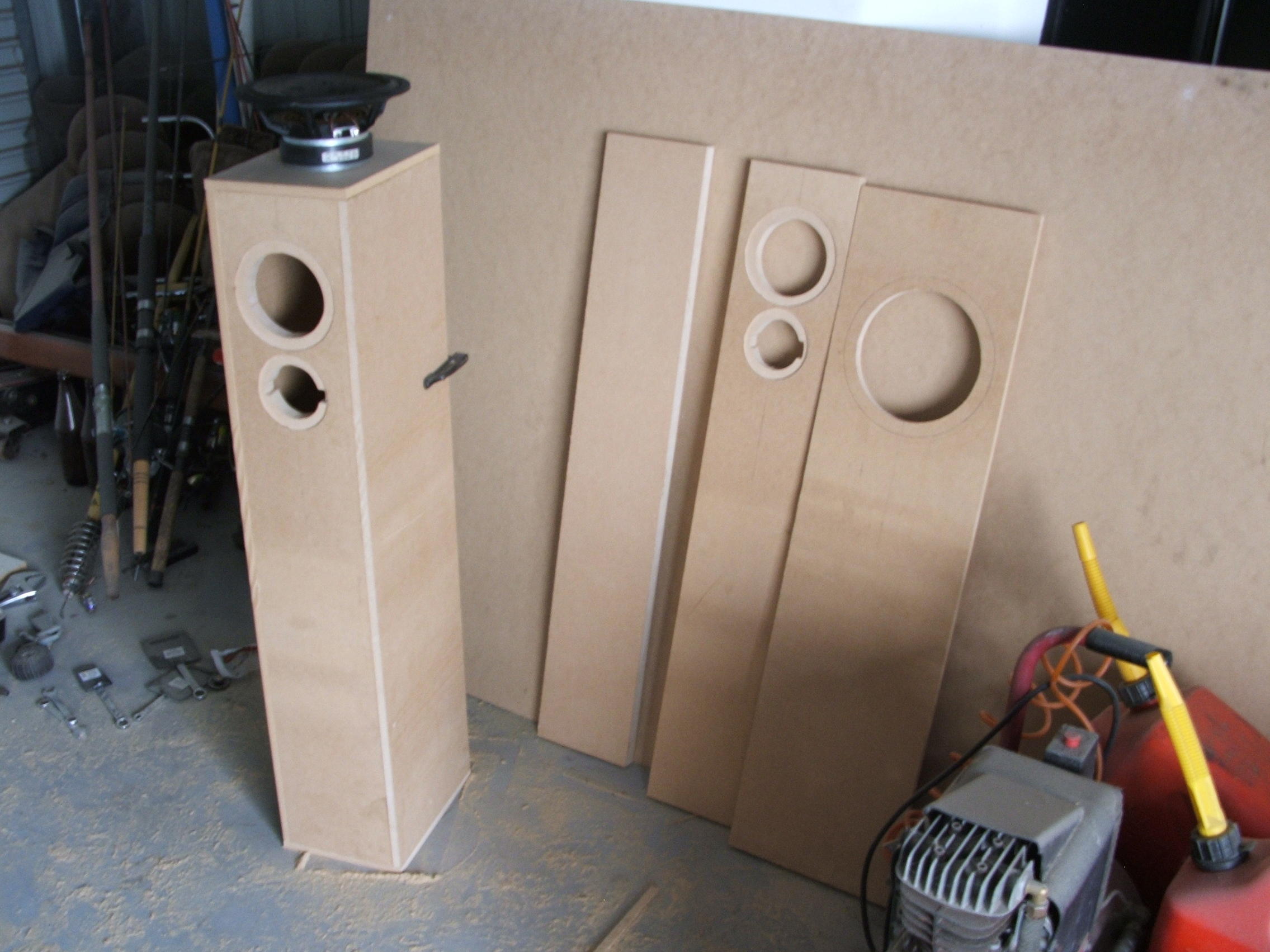

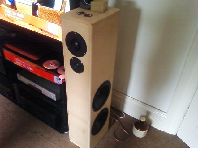

That's a nice looking bit of cab work there Mick... Did you use any stuffing in your box.. Have any luck with different types?
Is that the Jaycar mid dome or?
Keep us up to date with your TL's mate.

Dean,
Those pictured mids are jaycars, picked them up cheap on ebay, and expected very little from them. At first thats just what I got, a bad 'rattle' was very audible in them. It turned out to be small metal shavings on the voice coils and in the magnet gap. Having fixed that, they supprised me with their abilities. Not much to dislike about them other than somewhat whimpy little terminals.
I have tried different stuffings, Foam, felt and polystuffing, but suprisingly perhaps, not wool. (check personal messages). They all give slightly different sounds, although they must be heard to be apprieciated. BTW your right about Clarke Rubber!
The dip was centred @ 80hz, back to normal 10-12hz either side, I do not have testing gear or a response graph for this driver, so i'm not sure what the impedence is doing at this point.This design did have a zobel and bsc, which cleaned up the midrange but had no effect on the dip. Going by ear only.

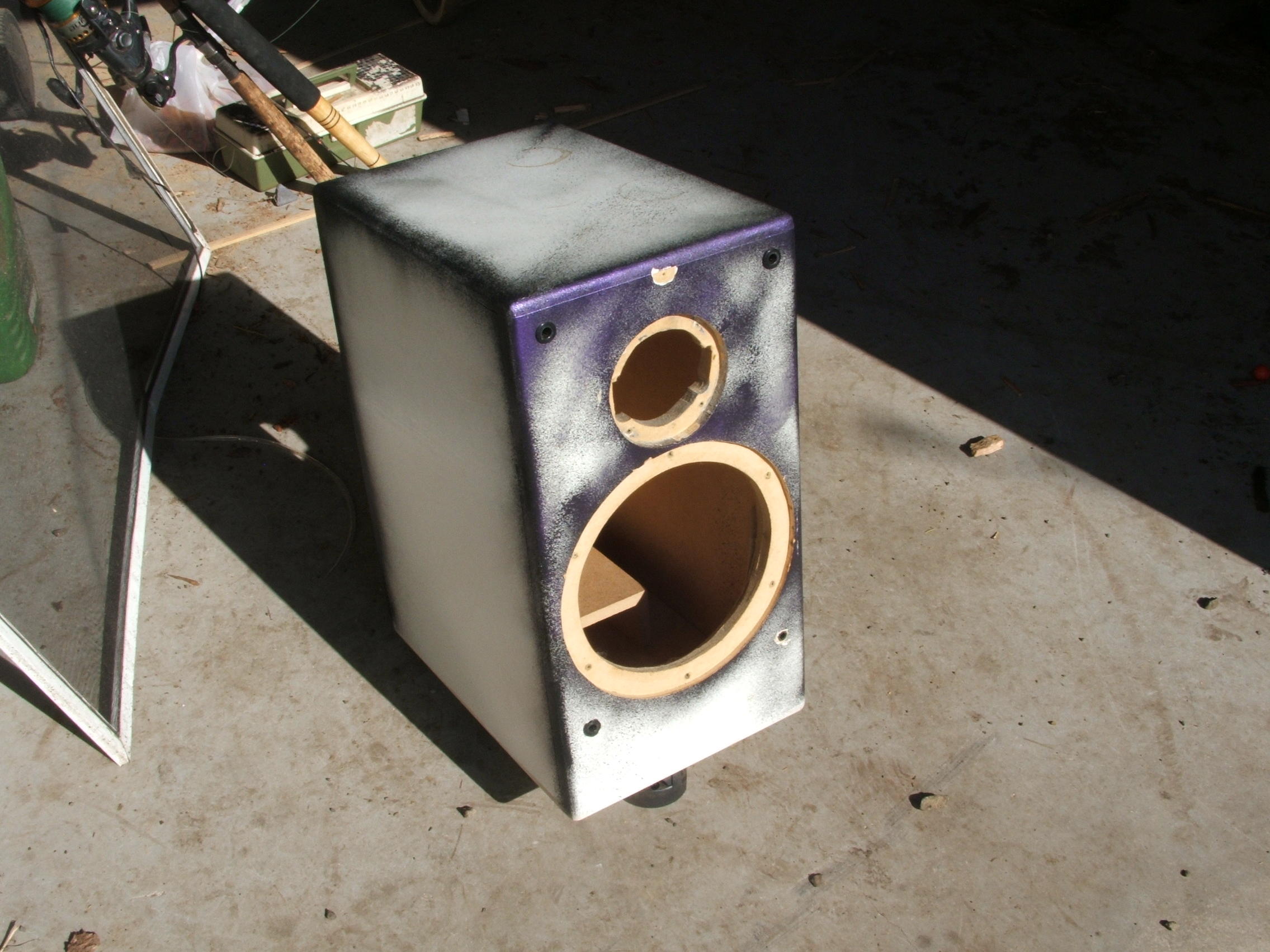

I have attached pics of the 23 ltr BR 2 ways, (the ones that had the dip).
I neglected to mention these were decomissioned a couple of days ago, Sorry for the confusion there! The towers (30 ltr) in the earlier pics are being used at present, despite their crass bass, as the overall sound to me is still preferable. However they are not long for this Earth.
The bass dip (23 ltr BR) was present in my house (13 foot ceilings), my Brothers house (10 foot ceilings) and my mates house (8.5 foot ceilings). It is also not an issue for my Tannoys (mercury MX2s) and is also present played through either my Yamaha 797 or my old Pioneer 436.
