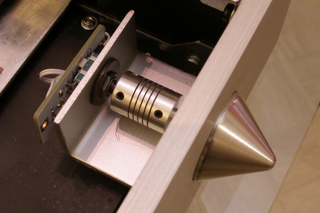

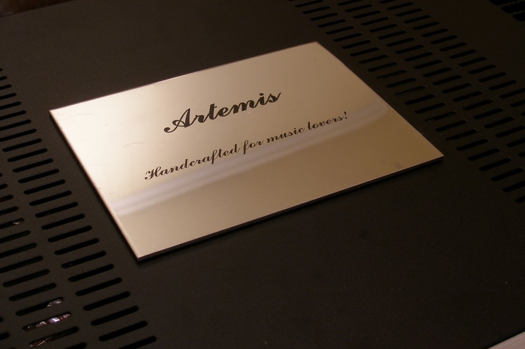

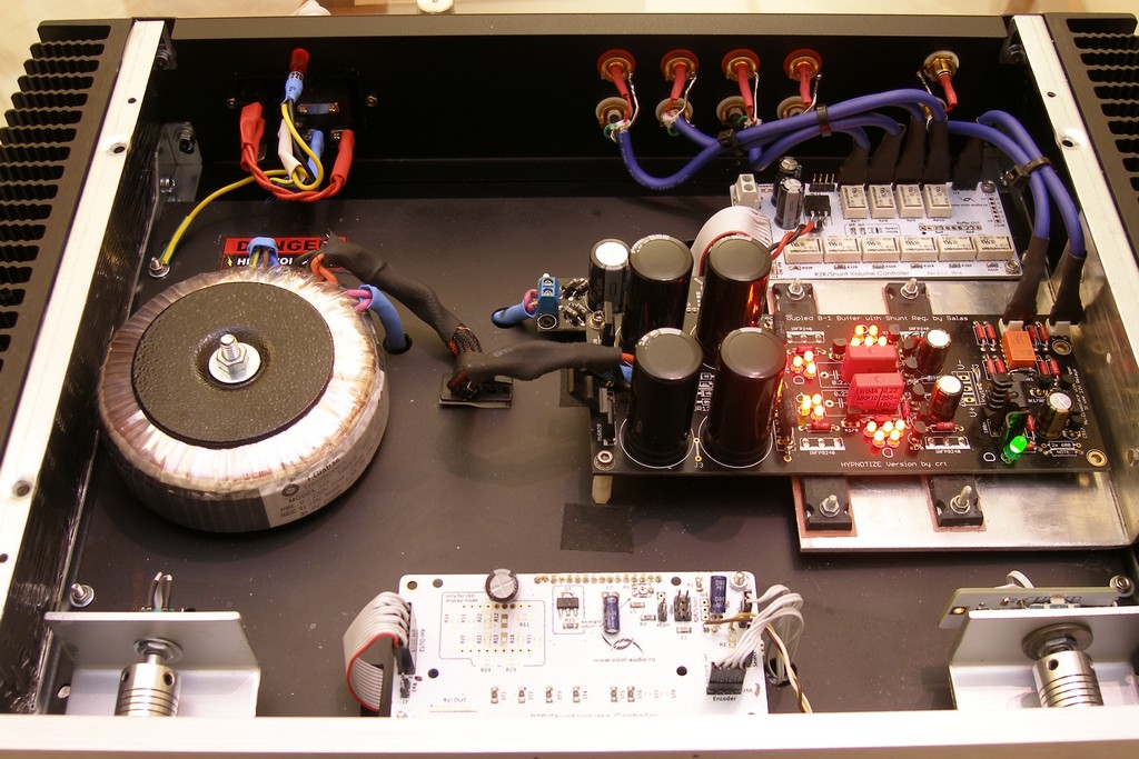

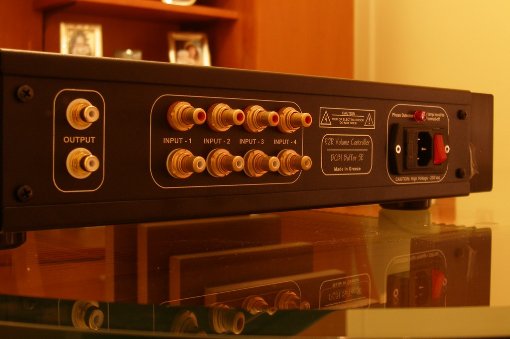

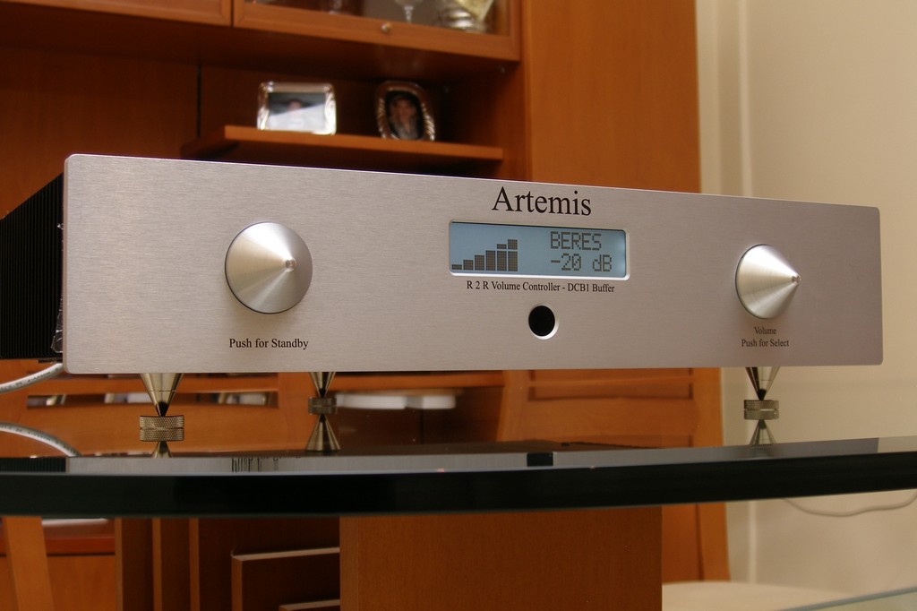

This is my Artemis.
A R2R Volume Controller (4 inputs and 1 direct) with a Salas DCB1 Buffer at the output of R2R.
Some pictures for the construction and the chassis are enclosed.

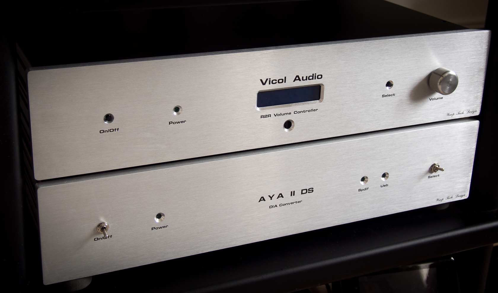

Inspired of "lemons" nice Volume control i decide to do something similar.
so here´s my Vicol R2R volume control. Works and sounds absolutly fantastic in my system🙂
Nice build. Which amp are you using, my dac+ volume control are similar)))
BTW, how did you wire the on/off button is it connected to your buffer as well?

Hi and thank´s!
Currently i use my new built PA03 Gainclone, my Firstwatt Aleph J have to step aside for awile.
About on/off, i wanted a green led for the standby function. Tibi told that i could use J7. So J7 and Vcc+ from the update firmware pin with a resistor works perfect with the standby called on/off on my VC front.
Hi and thank´s!
Got it so essentially you use this s button to power on the Maya only, not the buffer with it?
I was just thinking if the way to re-use the same power button for Maya and Salas DCB1
