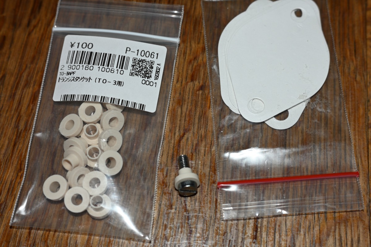

Looking again at the THF-51s formfactor (which is very different from TO-3) it is a real possibility to mount the THF-51s directly at the heatsink and have easy access to all three terminals. I have the mounting "garniture" for these devices......isolators etc....Also note that Pa's brackets are T shaped, not L shaped. They probably do a better job of spreading the heat.
@MEPER if the VFET chassis heatsinks had two M4 holes added 44mm apart, would you use those to mount the THF-51S directly or would you still use a bracket? I'm starting to think I might order two of these, with the second one having these added holes.
I'd check your shoulder washers. While the THF-51S hole is big enough for an M4 bolt (it's actually 5mm in diameter), the plastic shoulder washers I have that fit the THF-51S only accommodate an M3 bolt- they appear to have sides that are 1mm thick. I would be glad to have a part number for 5mm shoulder washers that fit an M4, as well as non-ceramic insulators.
I just checked and a M4 screw fits the isolators. Why TO-3 is mentioned on the label on the small plastic back I don't know. They are much larger than TO-3 devices. If only M3 fits in your case, I guess M3 will do the job for mounting the THF-51s directly and not via a bracket.I'd check your shoulder washers. While the THF-51S hole is big enough for an M4 bolt (it's actually 5mm in diameter), the plastic shoulder washers I have that fit the THF-51S only accommodate an M3 bolt- they appear to have sides that are 1mm thick. I would be glad to have a part number for 5mm shoulder washers that fit an M4, as well as non-ceramic insulators.

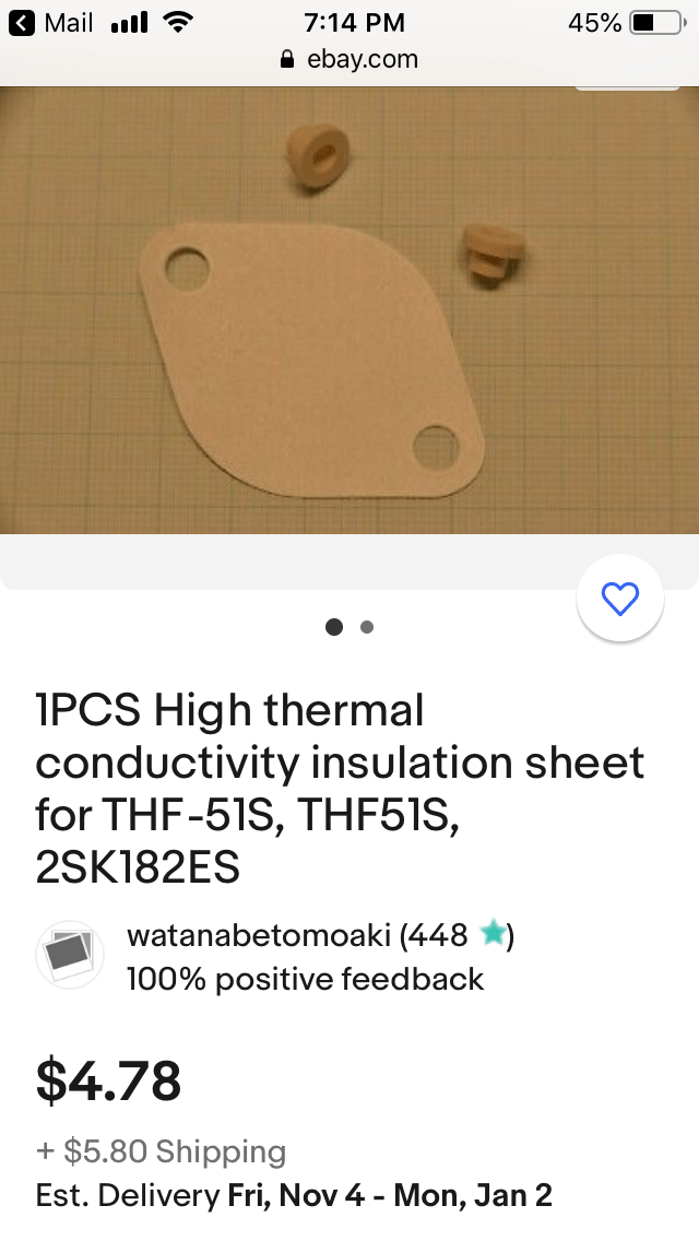

When I ordered the Tokin's, I also ordered the mounting "garniture".
https://www.ebay.com/usr/watanabetomoaki?_trksid=p2047675.m3561.l2559
With current prices I should probably have ordered more than just a quad and a pair.

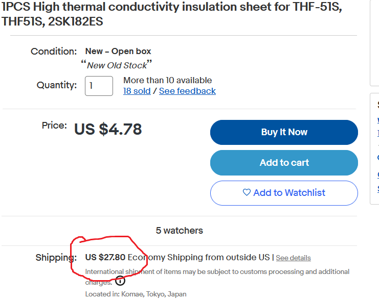

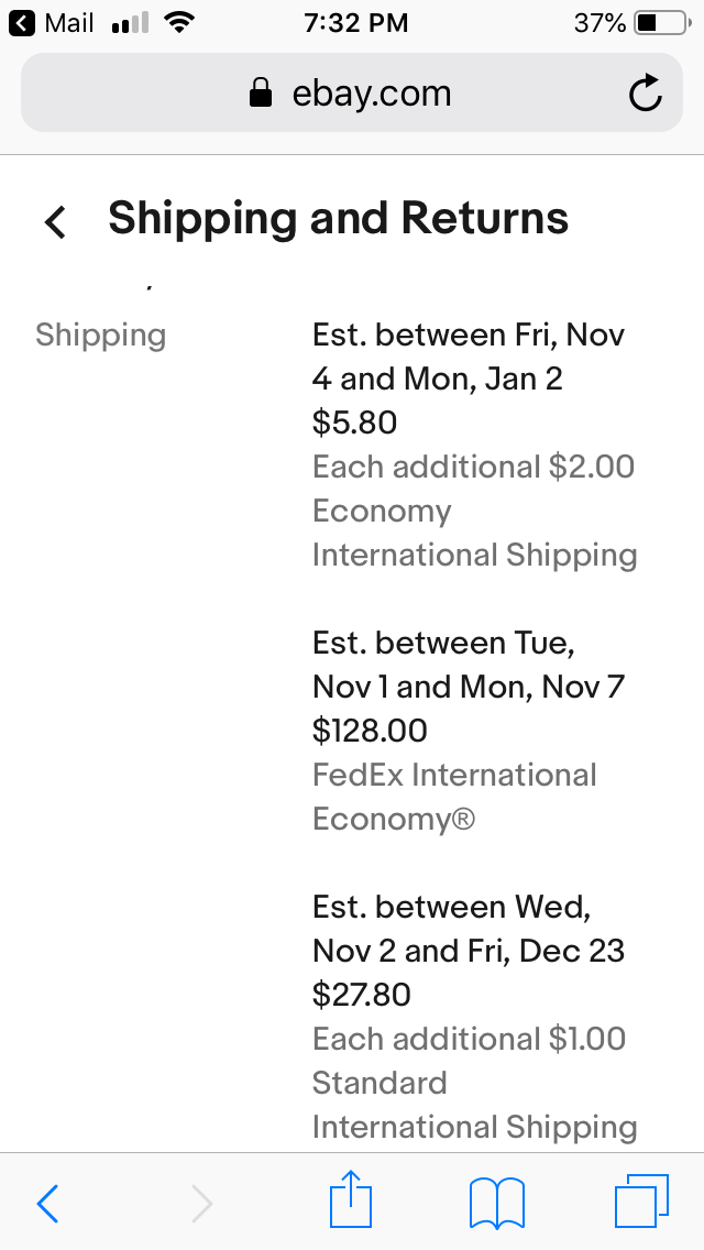

Oh good lord, $32+ for a pair of these shipped to the US. Idk how I missed them back when I bought my SITs. Yet I could buy 10pcs 'for a few dollars more' (read: $58).When I ordered the Tokin's, I also ordered the mounting "garniture".
There were what seemed like a ton of the THF-51S being given out at the BAF2022 raffle, and since I have a pair already (& had mine greedy eyes on other stuff, haha), I looked elsewhere. All of those lucky bstrds need these mounting parts if they expect to build an amp. I smell a group buy.
I get no rate lower than the one I showed, whether it's 1pcs or 10pcs. Looks like you've got the magic zip code.
You could probably write to the guy, he’s very accommodating and it’s international shipping so the postal code or zip code should not matter.
