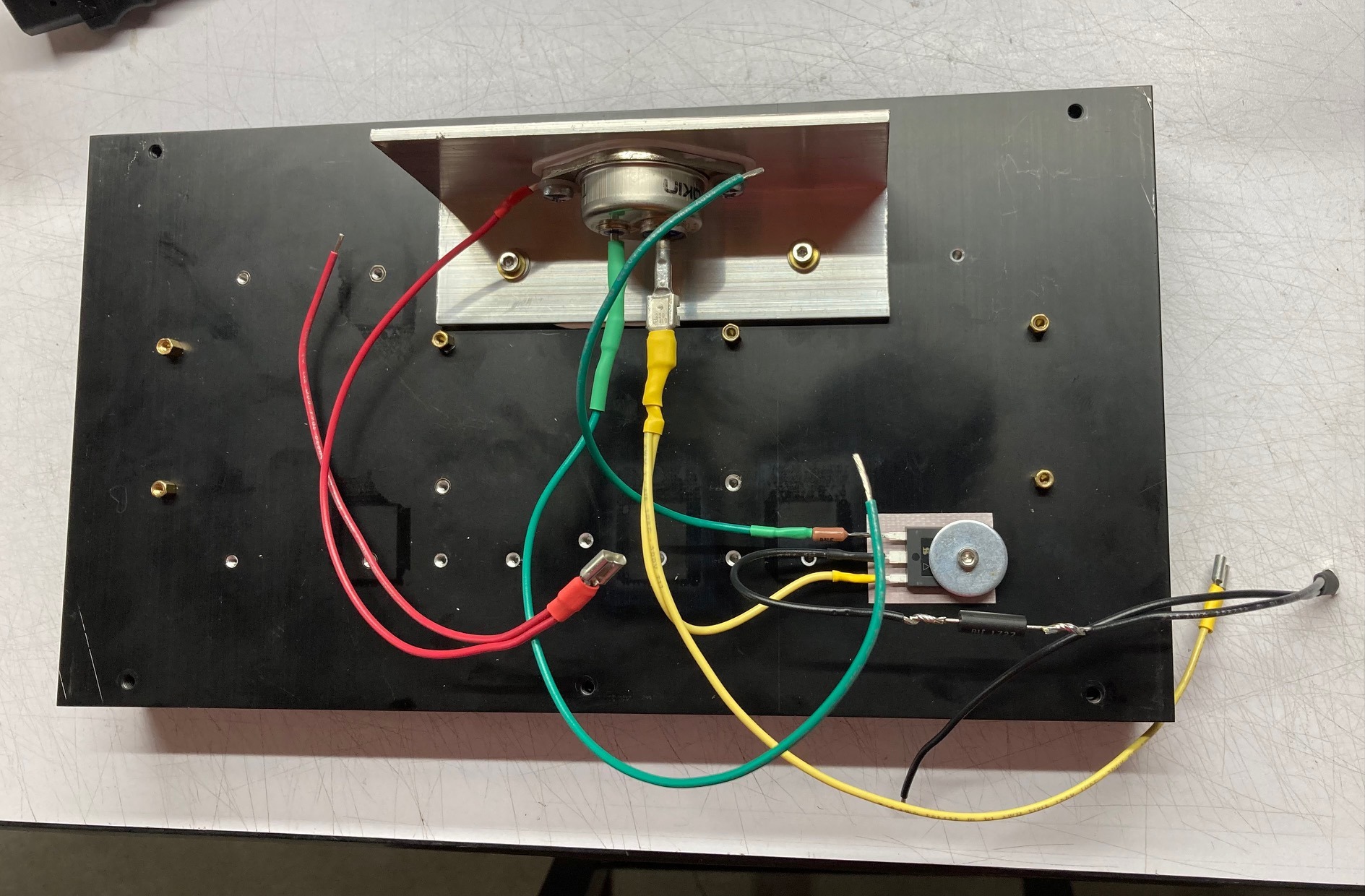

There are no mount holes properly spaced on a UMS drilled chassis to directly mount the THF-51S. To the best of my ability to measure, the mount holes on a THF-51S and 2SK180 are 44mm apart.I wonder if this chassis would work for the future Tokin THF 51s kit?

it could, if you choose construction with no more than, say, 60W of heat per side

I was hoping that a kit included a bracket to mount the THF-51s (like the VFET kit).There are no mount holes properly spaced on a UMS drilled chassis to directly mount the THF-51S. To the best of my ability to measure, the mount holes on a THF-51S and 2SK180 are 44mm apart.
If I did the brackets myself then maybe heat could be split between the two heatsinks so current source device on one side and THF-51s on the other?

So, I tried the bracket approach with THF-51S, and I wasn't happy with the heat transfer. Granted my brackets were on the thin side, 1/8" or ~3.5mm, which is thinner than the ones in the Sony VFET DIY kit. Maybe a thicker bracket would do a better job. Maybe ZM can comment.I was hoping that a kit included a bracket to mount the THF-51s (like the VFET kit).

When I finally build something permanent with these I'm mounting the flat face of the THF-51S and 2SK180 directly to the heat sink.
I think the "bracket approach" is the only practical solution in my case. I will find some thick aluminium brackets. Think I will make them longer......as long as possible, I think.
if you have area - and you have - better to tap M4s in heatsink for Tokin and bolt it directly to sink; to ease your life - you can shoot with holes between ribs, so though-hole possible, mucho easier for drilling and tapping
if not, pay with pain - minimum L bracket thickness is 5mm, 40*40 as minimum, 50*50 better and no less than 150mm in length

Also note that Pa's brackets are T shaped, not L shaped. They probably do a better job of spreading the heat.
@MEPER if the VFET chassis heatsinks had two M4 holes added 44mm apart, would you use those to mount the THF-51S directly or would you still use a bracket? I'm starting to think I might order two of these, with the second one having these added holes.

btw - M3 is not nearly suitable hardware to do anything with L brackets of proper size
only if you have mesh of 3mm thingies, but that's not likely case
M4 is minimum when speaking about L Brackets, and even then you need to take care of positioning and actual details
