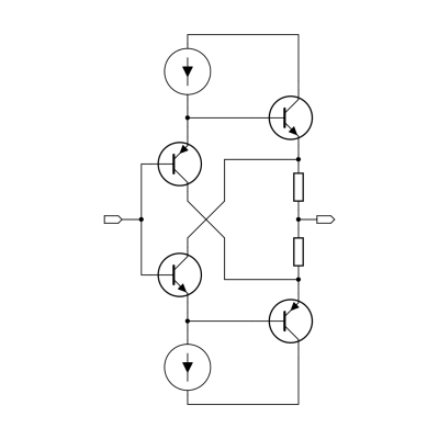

Dear audio enthusiasts on DIY Audio,
I plan to build an amplifier front end that is heavily based on Bob Cordell's CordellAudio.com - A MOSFET Power Amplifier with Error Correction amplifier from 1984.
I also implemented some ideas from his excellent book and some further ideas collected or developed over some years.
The design looks pretty complex, but most of the complexity is not in the signal chain.
Some design goals:
  • High PSRR
  • Power supply invariant operation
  • Massive input over-voltage protection
  • Feedback Baker clamps to maintain NFB during clipping
  • Adaptive clipping by sensing output stage voltage
The design looks totally over-engineered, but I had something in mind with every complication I added.
I present the design here because I like to hear the experts opinion, kind of peer review.
I gain a lot of inspiration on the forum and like to share what I do in order to maybe inspire other DIYers.
I'm not really interested in simplification of the design unless this would improve performance.
Some design justification:
The CCS are so huge because their output current does not vary at all with supply voltage. Also the PSRR is impressive. They are pretty stable.
The VAS has its own CCS, which is not really necessary, but allows setting standing current of first and second LTP independently. Can be omitted easily in case this is not desired.
The input over-voltage protection aims to protect the sensitive transistors from ESD and other high voltage events for both inputs. The design is simple, effective, does not worsen distortion significantly and is optional to assemble. I just find that inputs deserve protections since exceeding the absolute maximum rating of the input transistors voltage will degrade or destroy them. The standard low pass filter does a lot to mitigate ESD already and the additional protection is just for more severe cases.
Capacitance multipliers are great. This is Keantoken's design. Thanks a lot!
The rail reference sense makes sure that the output stage cannot be driven into saturation. Zener diodes values need to be adjusted to the type of output transistor used (BJT, vertical MOSFET or lateral MOSFET).
I use CFPs in the first LTP. While this does not show any improvement in simulation, I still like to try this. In any case, it makes this stage more linear. I stumbled across an article, that this helps to minimize memory distortion. So maybe worth a try. In case it doesn't work well, it can be reverted to the classic design easily.
I'm looking forward to your comments.
Easter is coming. And every project needs a name. So this is the Bunnyphant.
Best regards,
Lee

I have used the circuit given for the tail and reference ccs in multiple designs spanning 20yrs without a startup resistor and it has never failed to start. I even stuck one in the deep freeze for a few hours and it started no problem. In theory the circuit might fail to start but in practice, never!
Whether or not the CSS startup is a likely issue, I prefer to be on the safe side and adding three cheap resistors in the first place is better than maybe having a problem later.

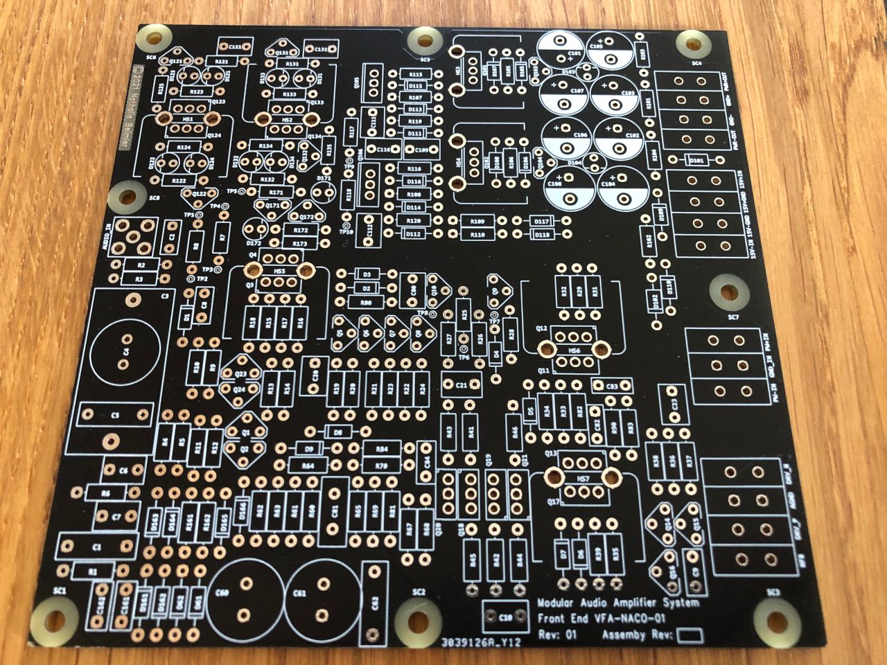

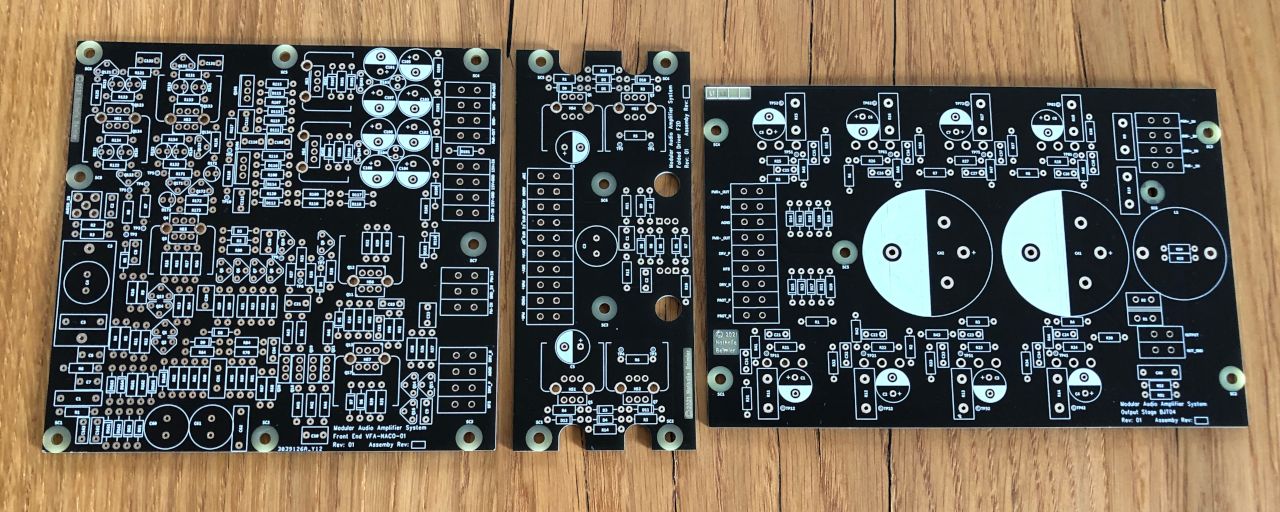

PCBs arrived and I'm looking forward to assembly. This may take quite some time.
This front end is part of my modular amplifier system and the first pairing will be with a folded driver and an output stage that has four pairs of BJT.

Making a LTP from CFPs works well.
It linearises the varying gm of the two active devices, so that the horizontal S curve of the LTP is flattened. The linearity of LTPs is worst at high amplitude, particularly like bass signals. I used this concept in a series of kit amps from 2007 called the Lifeforce, and it worked very well, giving the amp very good bass response and great resolution.
Great thinking, like your amp!
HD
Hugh, thank you very much for confirming that CFPs inside LTPs are a good idea.
I had some linearisation in mind and you explained the effect very well so I now better understand why I did it this way.
Thanks for the compliment! Coming from you, that means a lot to me.

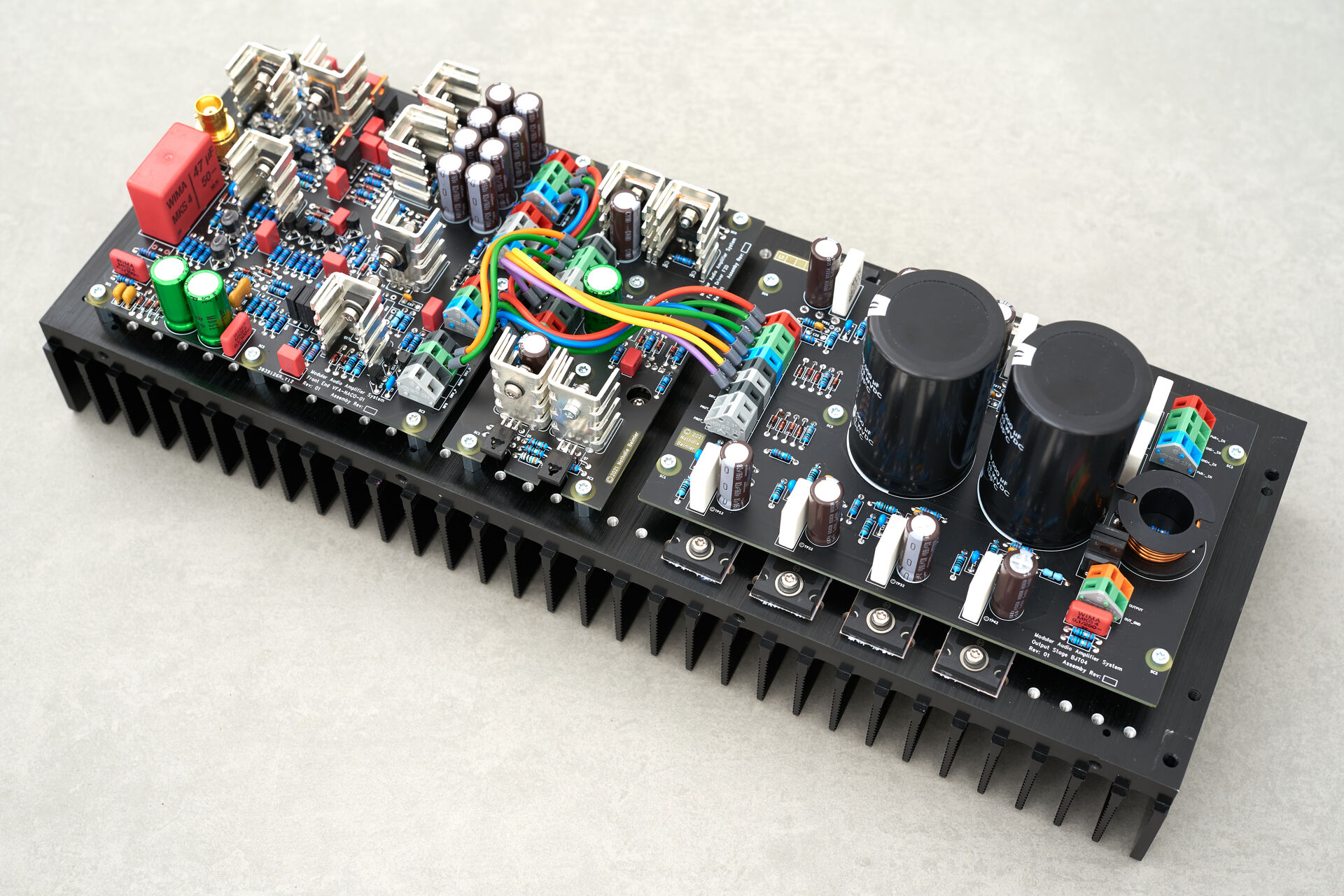

Meanwhile I built the front end and also the folded driver and output stage module. Below image shows the Bunnyphant together with her companions mounted to the radiator.
I haven't had any time to really test this example amplifier configuration.
What I can say for now is that the front end DC conditions are as expected and it produces razor sharp square waves with negative feedback taken from the front end output.

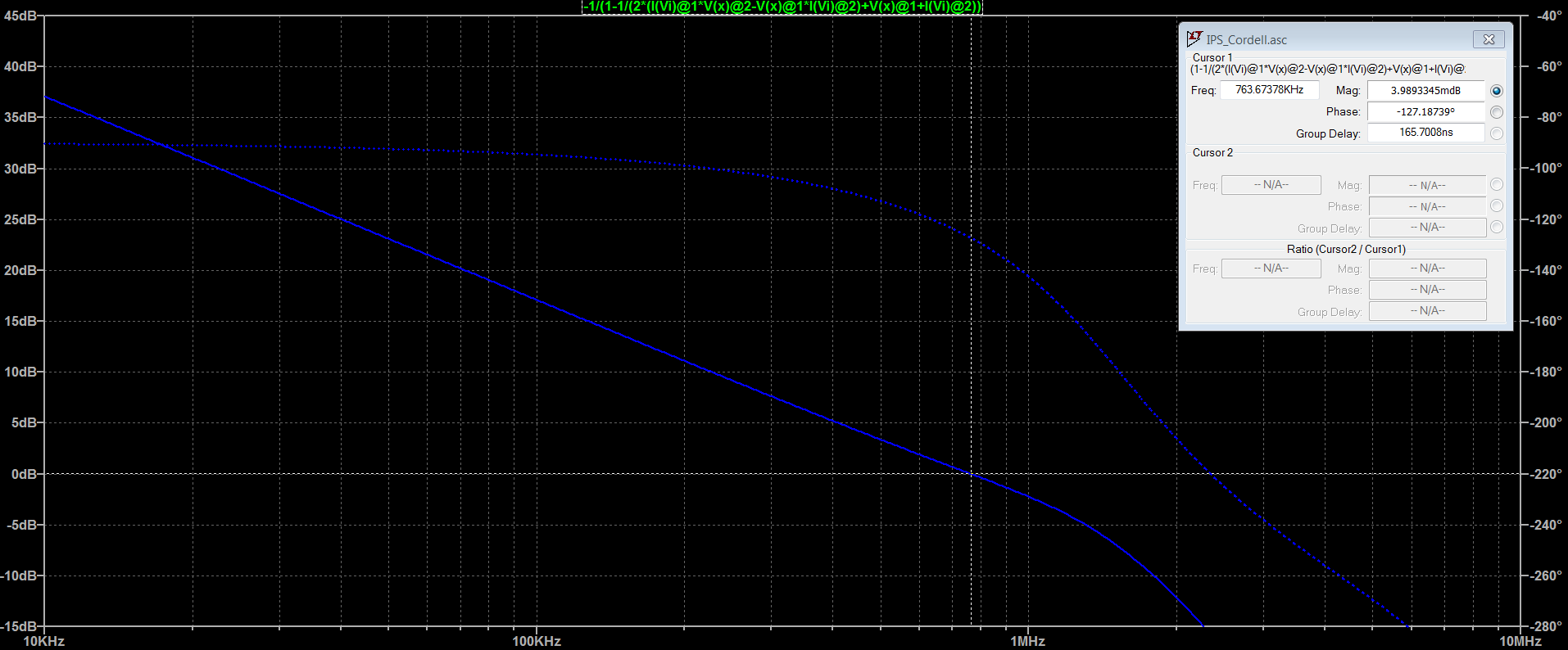

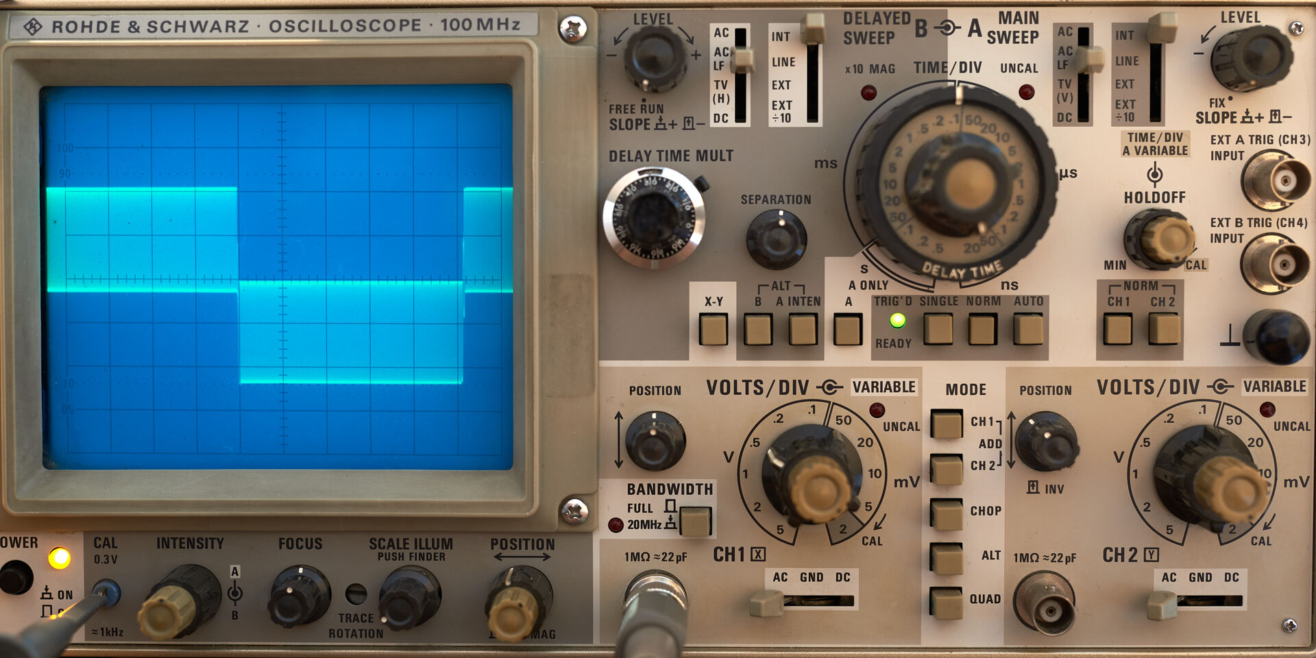

I started electrical evaluation and while the first results were promising, I soon stumbled into problems:
The front end shows nice square wave response either open loop or with the loop closed right after its output.
Also, the driver stage and output stage seem to work fine, at least with the very small square wave signal I have available for feeding into the modules (oscilloscope test signal).
However, as soon as I connect the front end to the driver (and output stage), there is a sustained 250kHz oscillation. This is regardless whether there is any input signal or whether I close the feedback loop right after the front end or after the output stage. Connecting the modules together is enough to cause this weird oscillation, that is also pretty high in amplitude.
The 250kHz oscillation is superimposed on everything - no input, square or sine wave - it is always there.
I tried a massive shunt capacitor parallel to C83 at the output of the front end. 1nF causes the oscillation to decay within 150us after the slope of the square wave and 2n2 cures the oscillation, but this brute force approach totally destroys gain and phase of the amplifier.
According to simulation, the complete amplifier should have enough gain and phase margin (could me more though).
Has anybody seen such weird effects before?
I have no idea what could be going on here.
It must be so big that I cannot see it.
I find the frequency is way too low for parasitic oscillation. This should be in the 10s or 100s of MHz somewhere, not a few 100kHz.
I tried identifying something that could explain the long time constant, but didn't see anything.
Any help is highly appreciated!

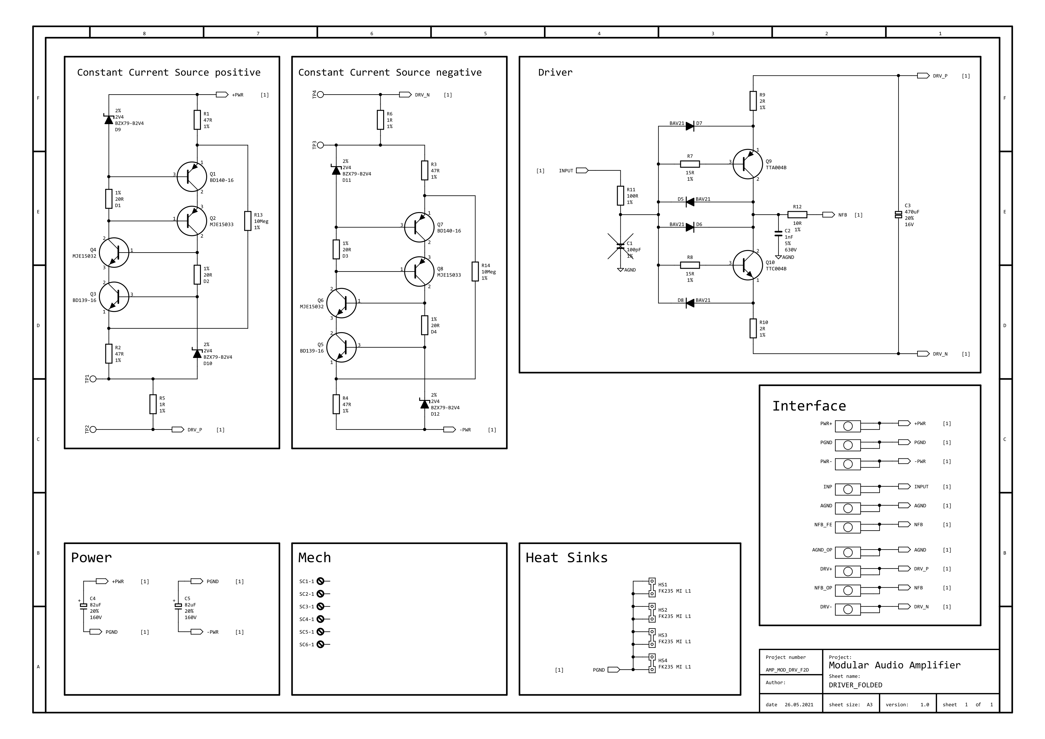

Here is also the schematic of the driver module.
This is basically like the folded driver in Bob Cordell's book (1st edition) figure 11.16.
The output stage is just a plain emitter follower with each four MJL3281 and MJL1302. 2R2 at the bases and 0.22R at the emitters. Nothing special really.
Maybe worth mentioning is that the output stage power supply is +/-22V and the bias is 3.7A roughly for class A operation. The front end and driver has its supplies elevated by 10V.
Each of your current mirrors are a feedback network that could oscillate. Probe each one to see where signal is highest (or where the probe alters the oscillation the most).
(I can't see how the driver can work. You have collectors for npn, pnp connected together and they are being used as emitter followers. Say the input goes high, current flows into Q10 collector, it can't come from Q11. There collectors need to go to appropriate supply.)

I will try to explain how the folded driver works:
This stems from my wish to build a powerful diamond output stage. So I started with the standard diamond buffer, which looks like this:
attachment.php
A better variant would be to connect the collectors of the driver transistors to the emitter resistors of the output transistors like this:
attachment.php
For driving multiple output transistors, this could be modified like this:
attachment.php
The driver transistors turn off the output transistors and the CCS are for turning them on.
When I got to this point, I found out that Bob Cordell has already described this in his book. He also added a small low pass filter from the output node back to the driver transistors common collector.
This small filter, R12 and C2 in my schematic, seems to be very important. Without this filter or with the filter not optimized, this is an excellent oscillator (the sine waves at 250kHz looked really good!).
Bob suggests 100R and 100pF in his book. In simulation I found that the resistor R12 affects DC offset and lowered it to 10R and increased C2 to 1nF. Should be the same in the end, but isn't.
Which brings us to the solution of the oscillation problem:
I increased R12 to 100R and this helped a lot.
I also experimented with increasing C2 to 10nF, but this slows down the output stage too much. I will go back to 1nF.
the DC offset is a problem in reality as well. My observation is that roughly each Ohm of R12 equals 1mV DC offset at the output. This means I have 100mV DC offset now, which is not good.
However, this is not a complete cure for the stability issue. The amplifier is stable now with the feedback loop closed after the front end. If I include the output stage in the feedback loop, there is still oscillation, but slightly damped instead of fully sustained and this is the case even with C2=10nF.
In general, I would not mind excluding the output stage from the feedback loop. Since this runs in class A, distortion is pretty low anyway. Whether this plays well together with any speakers connected, is another story then.
Getting the folded driver to work well seems challenging, but at least I have a forward path now and can go on summer vacation with a good feeling looking forward to continuing evaluation in a month.
