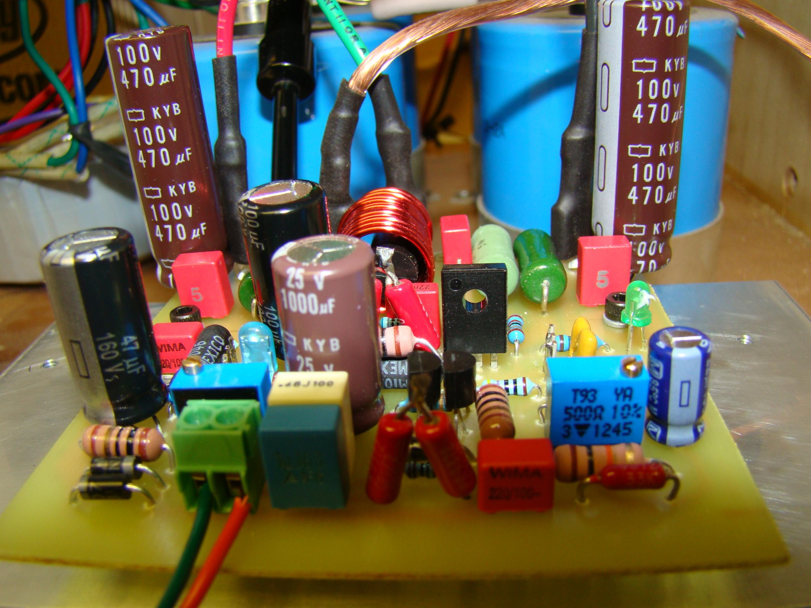

The second channel started up as easily as the first. I'll set them up to play in the shop for a few days before they graduate to a real system. I'll also take a peak with the oscilloscope to to check for obvious problems.
Thanks again,
Evan
Thanks again,
Evan

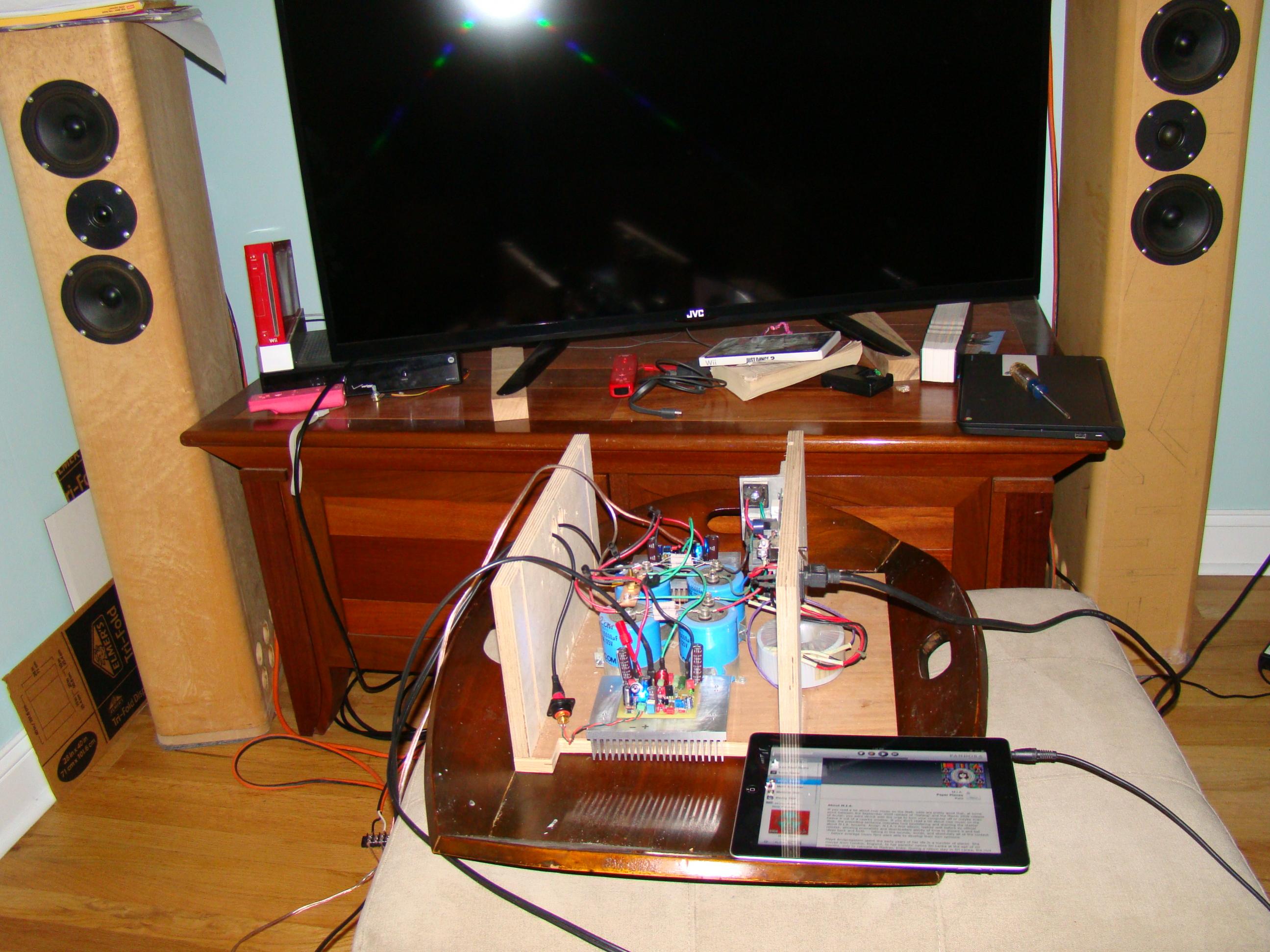

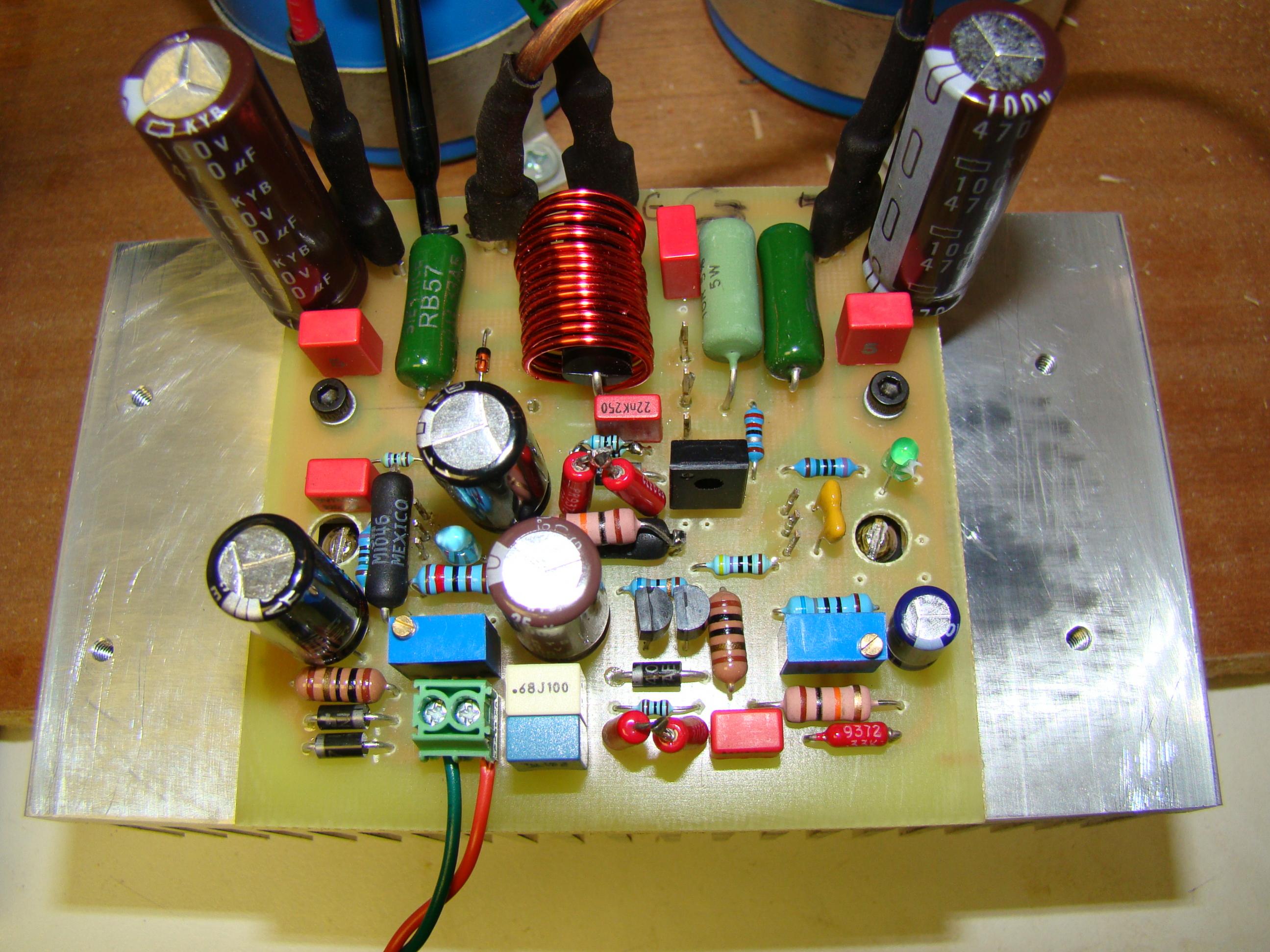

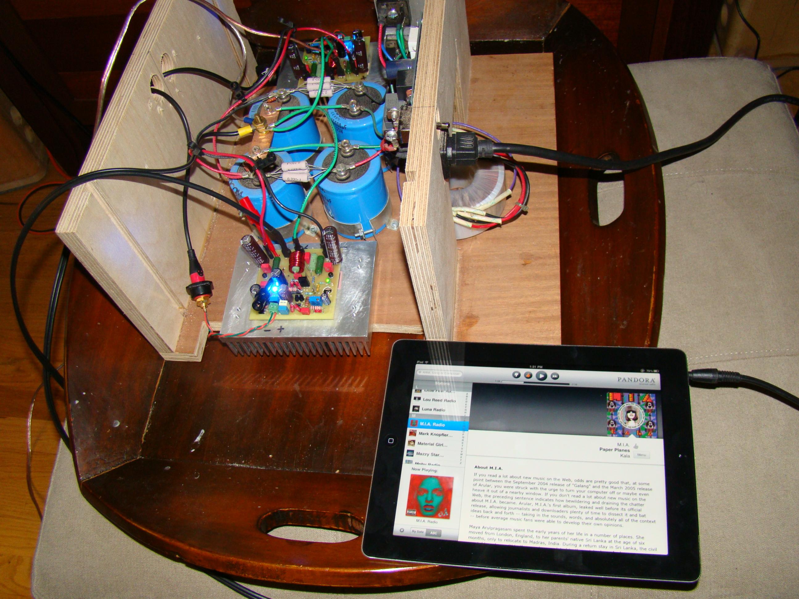

So I listened for a few hours on my old ariels. These little amps sound very good. They are by far the smallest amps I have built. A 4" piece of this 5.375" Wide Extruded Aluminum Heatsink - HeatsinkUSA seems OK for heatsink. Over the next week or so I'll box them up properly... dual mono power supply and dc speaker protection. Then I'll give them a try as part of my main system.
Thanks for the fun project,
Evan
Evan

It's amusing to see Evan's timber quasi cases, surrounded by his artistry in his wonderful furniture....... and his tablet showing he's looking at iHeart Radio!
We are all a bit OCD, aren't we?
Hugh
Hugh
