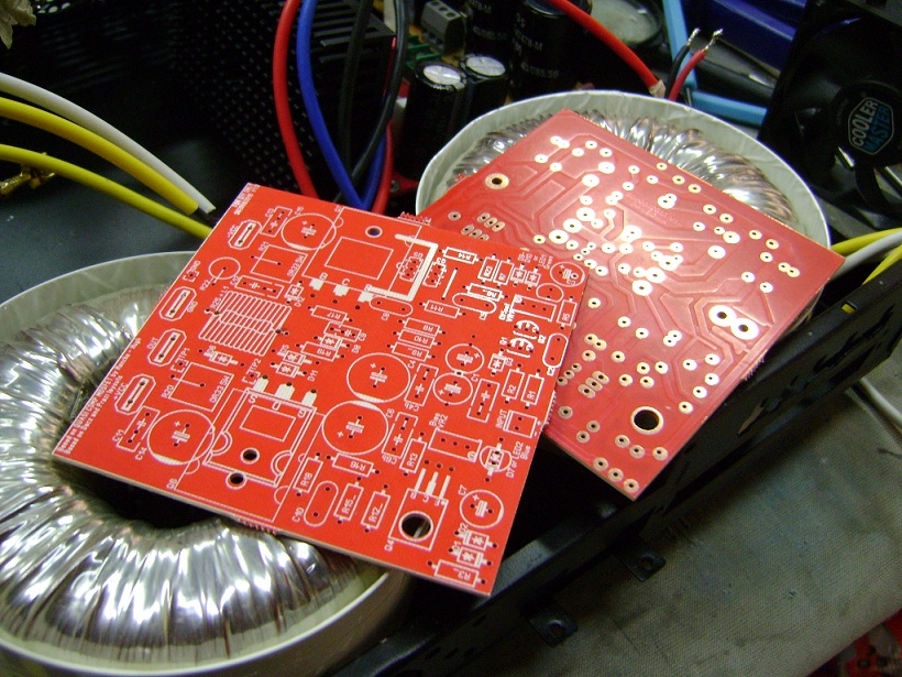

Yes prasi ,an analytic tutorial has been published in destroy-x super A thread,i will try to do a new tutorial with pictures.
This photo-resist method is away better!
My last amplifiers, like Valery Zero distortion modular and astx SA1015 used commercial pcb offered to me by good friends.
I want to thank everyone for all your pcb and parts offers.

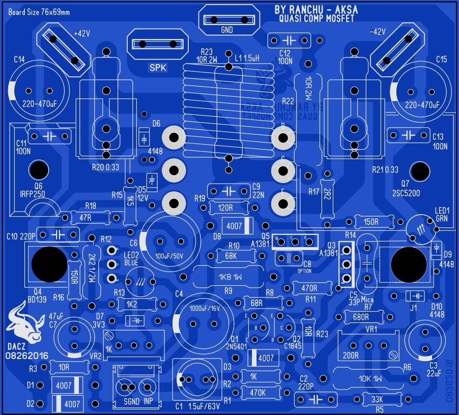

hi hugh
what is the rated voltage of the below capacitors @ 42vdc rail..
i ask so that we can minimised the diameter of the capacitor.
C7 1000uF
C6 100uF
C4 47uF
C3 22uF

hi hugh
C7 1000uF
C6 100uF
C4 47uF
C3 22uF
Dacs, the designations and values here do not match the schematic. For example, C4is a 1000uF part on your schematic. The VAS bootstrap (C6) should be a 63V rated part. The other electros are low voltage 16V or 25V devices.
Hi Dacz,
Very nice pcb, beautifully laid out - my thanks! One suggestion; if you put the large outputs central on the pcb, you can fit the pcb exactly midpoint along the heatsink. The amp looks a bit more tidy but it's not essential and certainly does not change the operation.
I am with Ranchu, his suggestions are my suggestions too! I generally like to use a film cap for C1, 1.5uF is just fine. Electrolytics are not quite as good, even when they are polarised by a couple of volts like this amp input stage. If you use 42V rails, 50VW caps are right on the limit (80%) so there is good sense on using 63VW as they are not much bigger and then offer a lot of upside to the rail voltage. Since outputs can just support up to 48V rails, this makes sense.
As for Class A, I do not like the idea much. I think the sound would be different, but consider that since the upper nmos does not turn off and therefore the cross over point is somewhat blurred, I cannot see the advantage in ensuring the lower npn never turns off. To achieve this, the currents would be horrific; to prevent the npn turn off at higher output (no higher than 65W into 8R, 32.3Vpeak) the quiescent current with 42V rails (no sag at all BTW) we have to give a quiescent current of 4.5A. This mandates 182W dissipation in the nmos, and 180W dissipation in the C5200. These are impossible to sustain; you'd need at least of 480W dissipation in EACH of the two output devices to maintain this dissipation over decent a lifespan for the amp. Even at 65W I see the H5 harmonic at -96dB, compared to the quiescent at 120mA where it's -84dB.
Essentially, this amp is optimised for Class AB, and if you use to Class A, you need a different topology, more like the JLH, which is actually designed for Class A (but gets VERY hot for low output!). High dissipation in output devices reduces MTBF; effectively an increase of 11C halves the life. So if the device operates at 58C, say 33C more than 25C, the life will be almost 2exp3 less, which is 8 times. This is pretty steep, so you have to be careful.
Hugh
