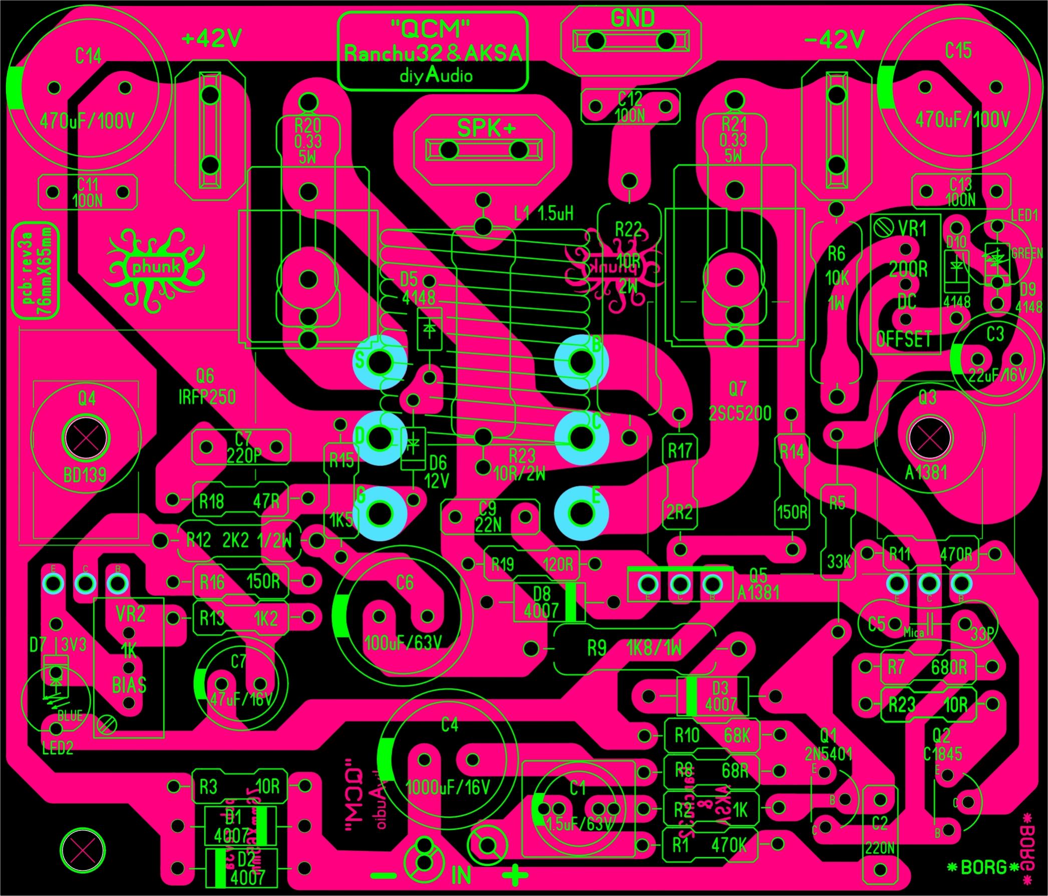

Very simple quasi complimentary MOSFET amplifier
phunk
C2 is 220pf this pcb design has been tested by me.
warm regards
Andrew

I know I'm way late to the party, and all of the helpful links are now in antiquity, I was wondering how bad off I would be if I used a ceramic cap for C5 instead of silver Mica? Must be a good reason mica is specified. My eyes are crossed from searching..
Compensation.......
Hi 2pist,
Silver micas are selected for very high frequency performance. Here's the reason.
Any global feedback amplifier must be compensated so it will not oscillate. This can happen when phase shift from front to back of the amplifier approaches 180 degrees, transforming negative fb into positive fb. This usually destroys the output stage of the amplifier, and often the speaker drivers, so it must be avoided at any cost. The trick is to drop the loop gain to below unity; if it is less than unity loop gain, positive feedback will not accelerate the input of the amp towards oscillation.
On a SS amplifier this Unity Loop Gain Frequency (ULGF) happens around 500KHz to about one MHz, depending on the design and components. To reduce the loop gain (the 'excess' gain over the nominal 'closed' gain set by the fb resistive divider) we use a small cap from the voltage amplifier down to its input, or even the fb node. Usually this cap is strung between collector and base of the VAS. The cap must be temperature and frequency stable, and so we use silver mica. You can use COG and NPO ceramics, but I generally find the sound seems to be a bit better with silver mica.
Books are written on compensating feedback amplifiers. It is a category of electronics called 'control theory' and applies to any device set up for gain using negative feedback. Control theory even applies to sugar levels in the human body, for example, it is ubiquitous.
Hugh
Thank you for the input Hugh. I found a pair of 48pf micas I will try. I made a few substitutions, like a TTC0002 with a Irf240. I had to increase VR1 to 1k to get the offset closer, but that in turn increased the bias to .7 volts. It's a current hog, closest thing to class A I ever put ttogether.. Math isn't my strong suit. I still think I can trial and error my way to success. Good thing it's just a hobby for me, but I always try the parts I have on hand to see if I can cobble together something reasonable.

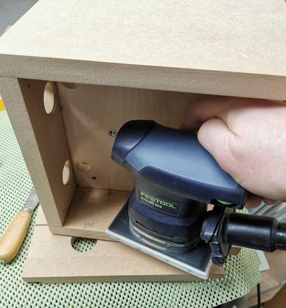

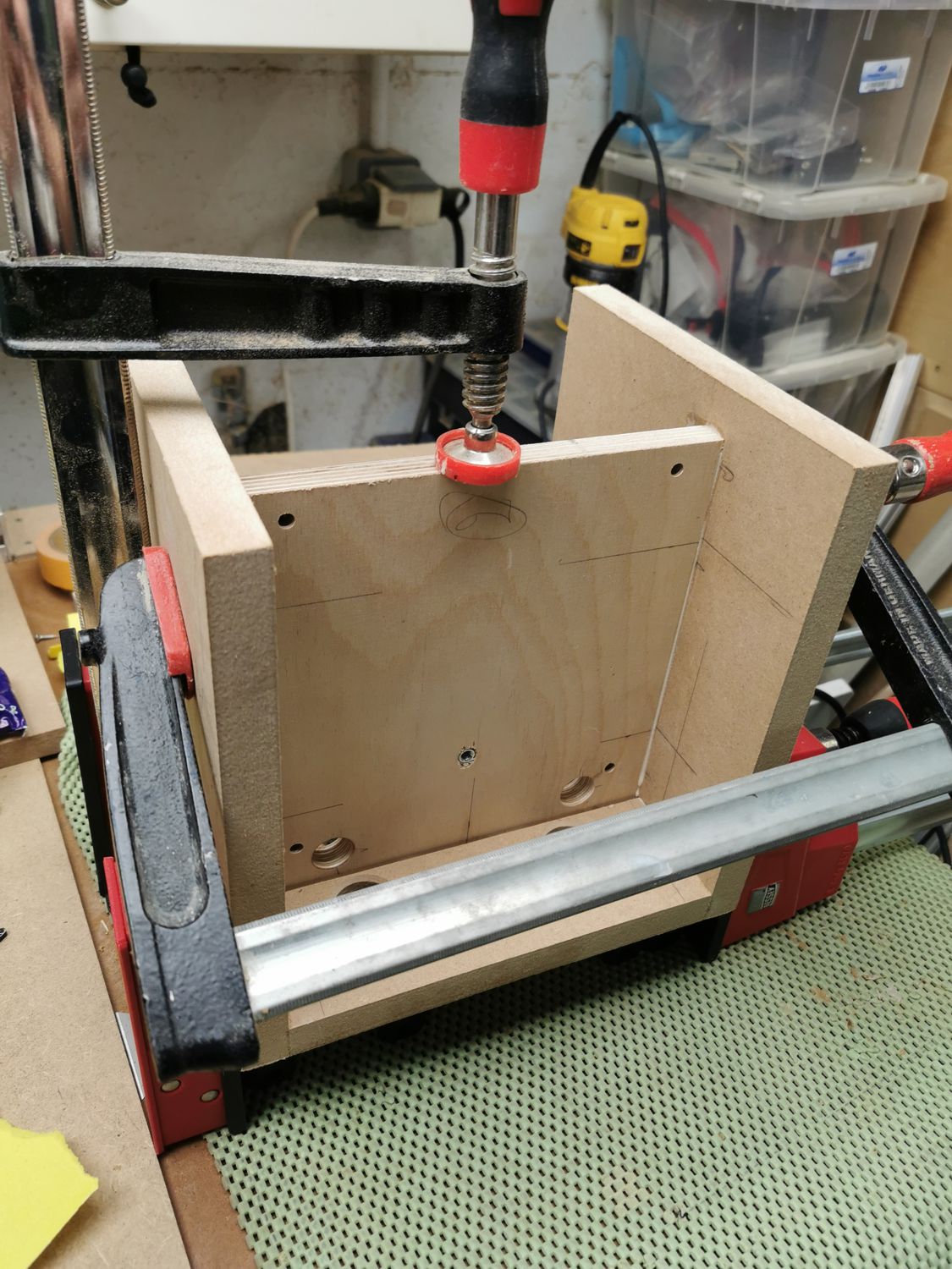

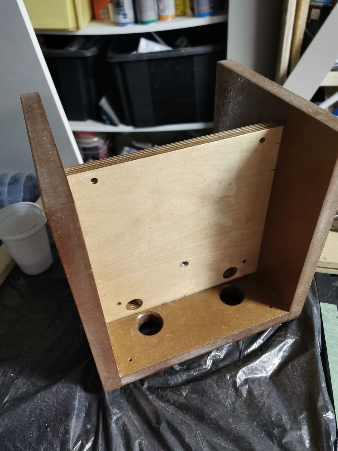

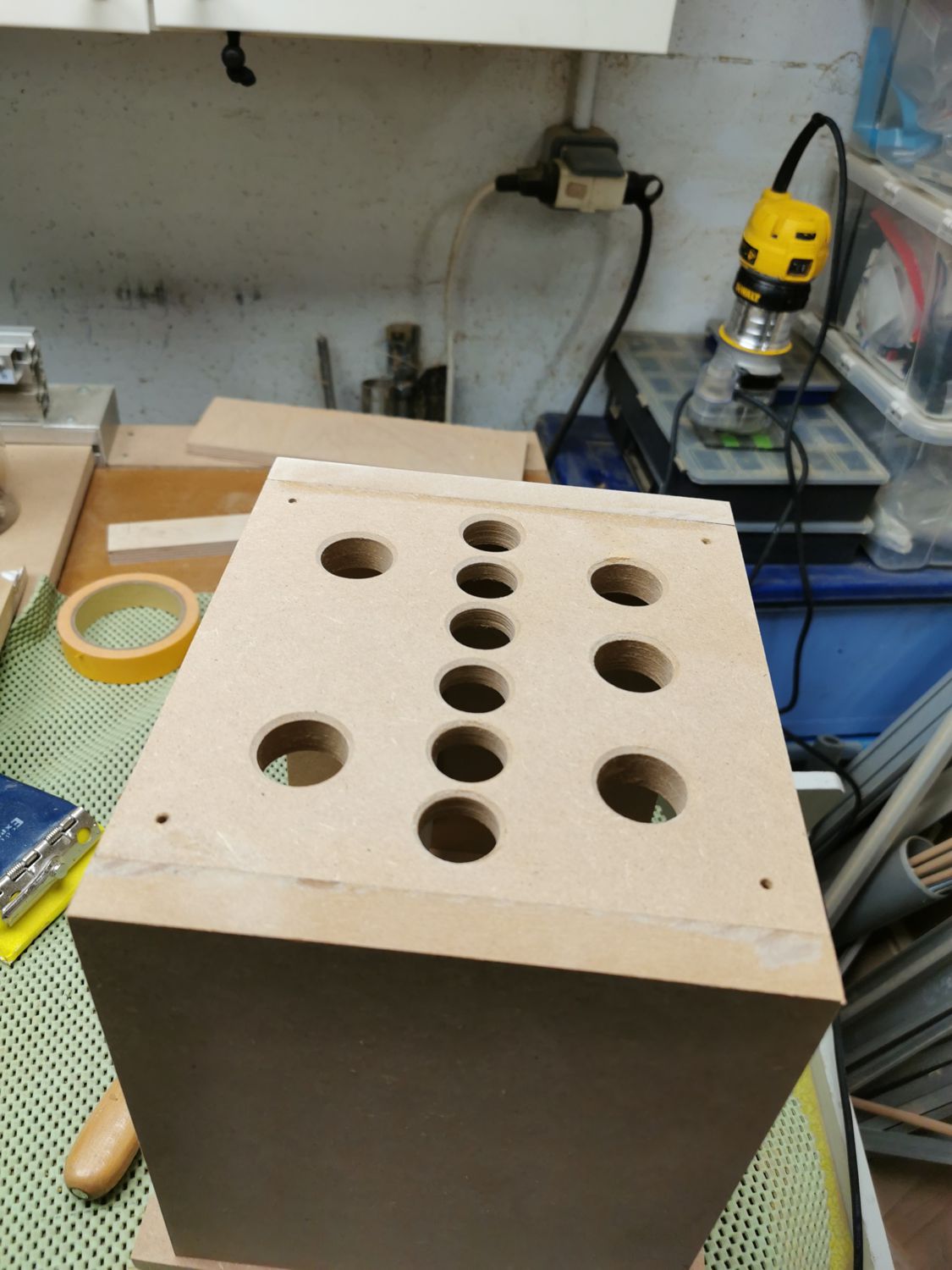

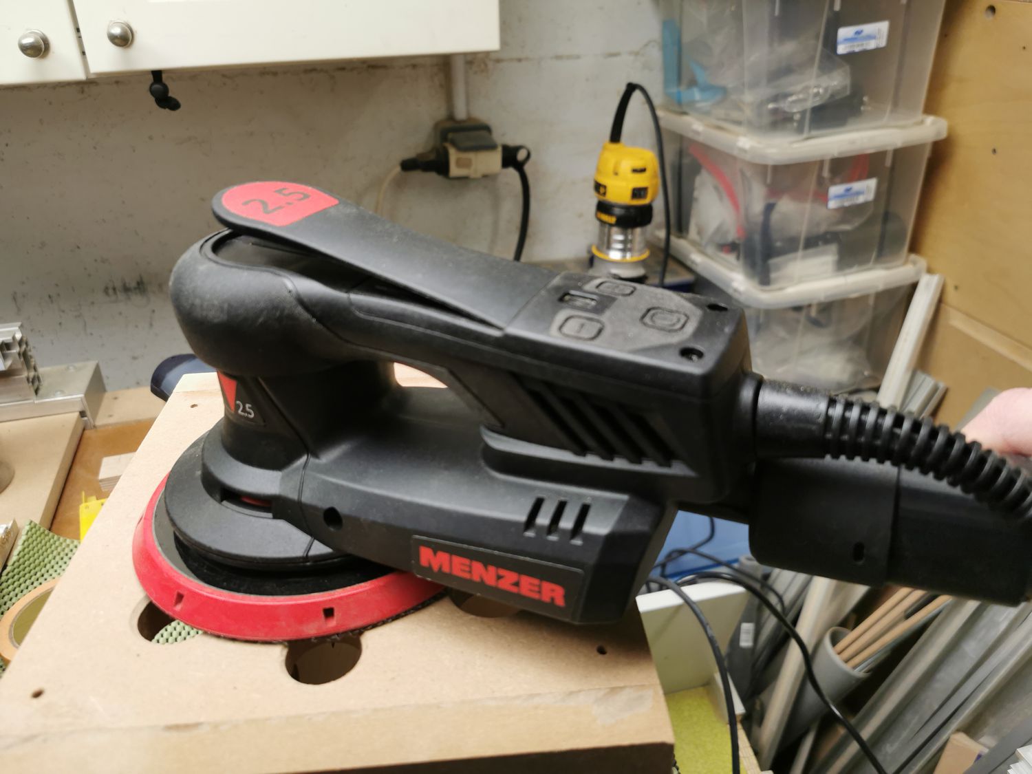

Some more work on chassis : gluing the second chassis, some sanding with my two favorite two sanding machine. The RTS 400 EQ for small area, and the Menzer ETS 150 2.5 for bigger. I apply one layer 2K epoxy resine on first chassis. I hope it will dry coorectly as it is a hold stock one. I order some new

I could use a little help..
Sorry I haven’t seen this sooner.
As Hugh said you need a lower voltage drop on the green led.
For mounting I believe Dacz plan was to pinch the output transistor between the board and heat sink. I ended up drilling the mounting holes in the board bigger and mounting the transistors with Allen head bolts that fit through the enlarged holes in the board

No worries. You guys are awesome. I'm waiting on one Irfp240 to finish my second board. I'm using these in a car amp I built like 15 years ago. I figured out a way to mount them to the case. (Made from aluminum I beams) the smps design is from an old Orion amp I reverse engineered when I was young enough to do such a thing. Lol. And it's going to power a system for my handicapped daughter. It runs at 44 volts per side. I would upload some pics but it looks like they need to be hosted off site.?
44V rails will give you good power; I would estimate from your setup around 90W into 8R, and probably quite a bit more into 4R, the usual impedance for auto speakers.
A car is a noisy environment and even a noisy amp would not be noticed over the road noise and running gear. But the VSQA has a high level of second harmonic conferring a slight 'warm' sound which is immediately noticed even in a car interior. The use of a mosfet one side and bipolar on the other in the output stage enhances this 'warmth' and many people like it. It tends to relax and calm, which is precisely what you need in a car, particularly in traffic!! In fact I have an old car with a Mark Levinson sound system and I'm expecting it to fail, they have a bad reputation. I will use the VSQA to replace it when it inevitably goes to God........
I always liked Thiago's and PHunk's pcbs. Wonderful! This amp was very popular and easy to get running. I hope your daughter loves it too!
Hugh
