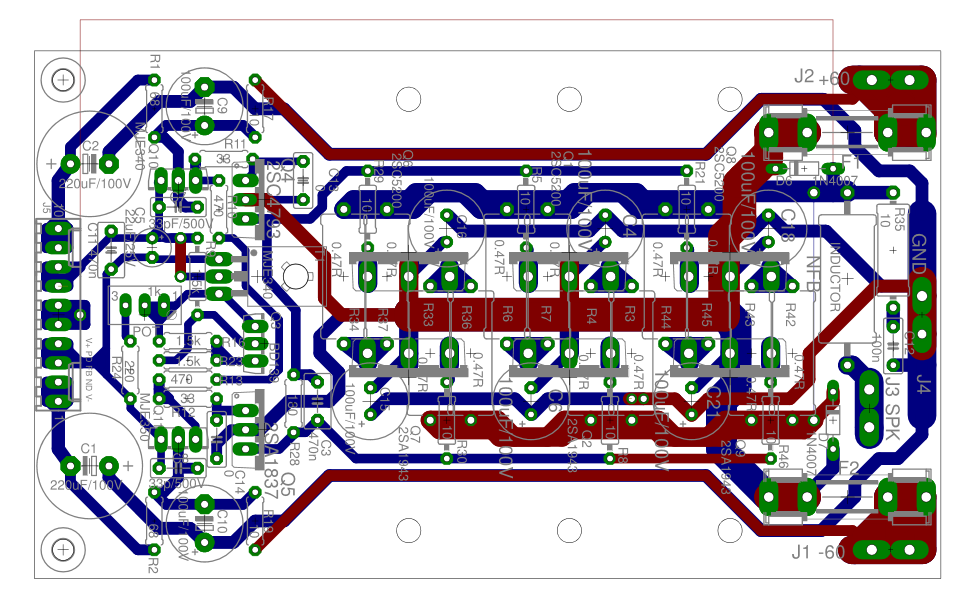

Hi Valery,
That looks pretty cool I'm not crazy about the SMD electrolytics. Any way to make them so the can use SMD and/or through hole.
Hi Terry,
Actually this is a good idea. In most cases there is some space for the holes (unless there is some dense parts load underneath), so it would be possible to make a universal design. I'll try to do it for the "Compact" series.
Thank you,
Valery
Valery
Cool board !!
Dual layer pcb gives a lot of advantages. I have made some measurements to compare the standard single layer OPS and dual layer OPS and there is slight measurable improvement in dual layer OPS. I run the V+ and V- rails very close (on top of each other), even better would be to run V+ and V- rails next to each other and putt GND track right above them, if the GND track would be a current return tor speaker than all the electromagnetic should cancel out.
The SMD emiter/source resistors --> I am using them in my PSU (5x 1R) in between the big caps, in case of short circuit they just pop like a fuse, saved my lab gear good few times, brilliant idea!!

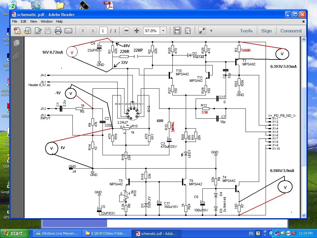

This topology is VERY sensitive to impedance/gain of the first stage.
2sa/c to BCxxx , I had to change lag comp and reduce/tweak 2nd stage gain.
Vzaichenko also had to partition and calculate each stages gain.
I also notice you use no lag comp. I could not even get this topology to
work with BJT/FET without this.
Terry mentioned " where is the LTP" ? The tube is acting as one. An analogy
to the same amp with Jfets would be plate=source/grid=gate/cathode=drain.
On this thought, 220R + 220p across the plates would be the lag network.
This gave a perfect bode/phase margin with the Jfets @ 1.1ma Id.
Confirmed - without the lag , changing the Jfet model or degenerating it (gain change)
will make the amp unstable. The changing physics of the tube would be the same.
With the lag , nothing could create a "peak" beyond where there was sufficient margin (a sign
of instability). My lead and miller comp at VAS is also very similar to this one. (as are all my currents).
The ONLY reason this amp can even work is that the second stage is CCS based.

Is this that you mean?

Yup , my highly degenerated bjt's on the Kypton V are also a "further"
analogy to what the valve is doing in this setup.
The valve is different in that it changes a lot more than a solid
state device. temp/age/microphonics.
Jfet = another , but perfect - voltage controlled "valve".
I bet this design would sound identical with the proper Jfet.
C17 and C7 are also crucial (leads).
OS

Os, is this <<different>> listening because this want 500 mv only for full power(high gain)?
That is just R12/13 = Xgain. Close to 40X ? (27X slew ips)
My stability margins still were good raising my gain 10X.
Edit - I have two fully simulated amps like this (GLA/V).
GlA + jfets is identical , I matched borys's currents. Good amp 20ppm-20Kthd.
Should be the same with the valve. Oh , C17 = 6-10p (lead comp)

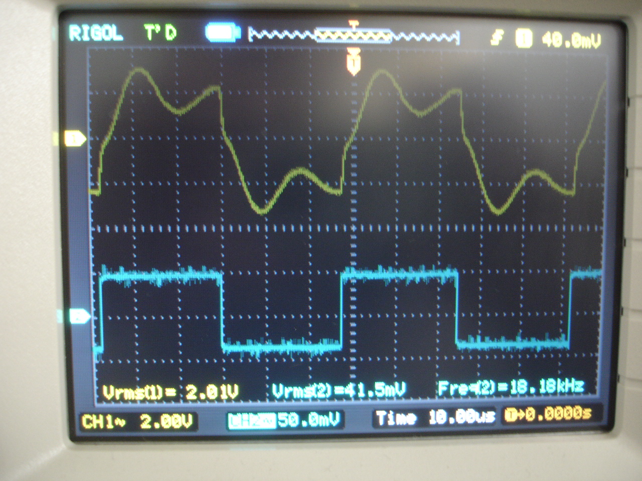

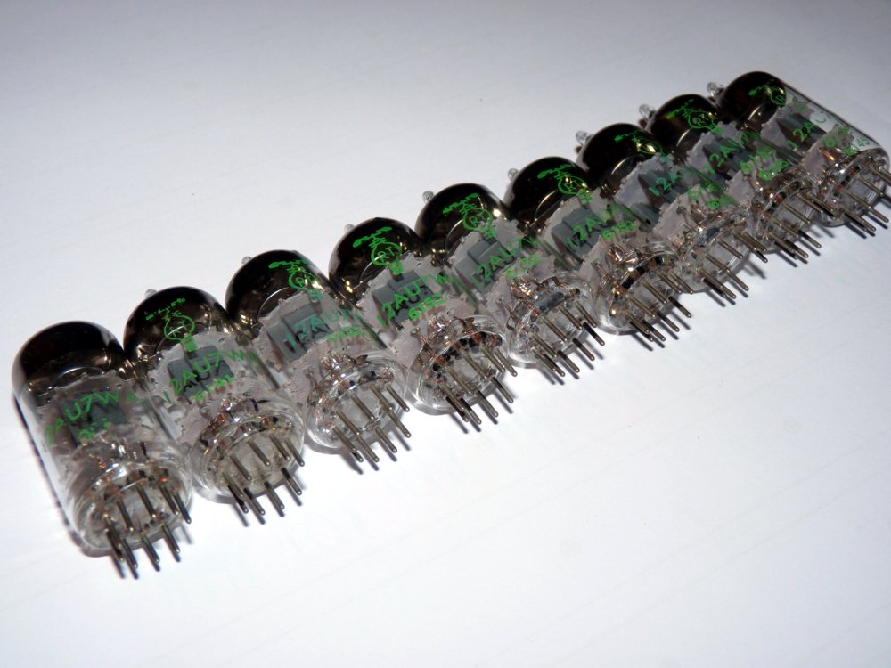

My first one with the 12au7 ran perfectly. Very stable offset and stable bias. This one with the 6n1p initially had that overshoot you saw in the scope shots. The offset is not solid. It drifts constantly especially when music is playing. With C7=33p and R3=120r, the top and bottom of the square wave look the same at 10vac but as you push the volume up the bottom of the square wave starts to flatten out and about 20vac you will start to see a slight overshoot developing. The top of the wave remains constant however. I have been running this with +-47v rails. Later today I will try running at higher rails and see if that improves things. This ips wouldn't even run at +-40v rails. I think the one with the 12au7 did. I have some ECC88 tubes coming. It will be interesting to see if those make a difference. Aside from all this, this ips sounds beautiful. If you didn't hook it up to a scope and DMM you would never suspect anything. It sounds very musical with solid bass clear mids and highs. As usual, I was too quick to build it so I missed out on the cool little led below the tube so I only get the natural glow from the plates. This was actually more fun to build than the first one because I got to play around with the values while trying to get it to work properly. The first one just played perfectly right off so it was off the bench quickly. Saying that, if I was planning to build one into a case it would be the 12au7 version because it seems more stable and I loved the sound.
Blessings, Terry

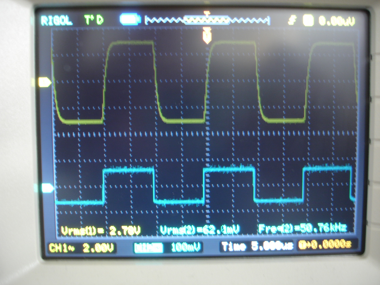

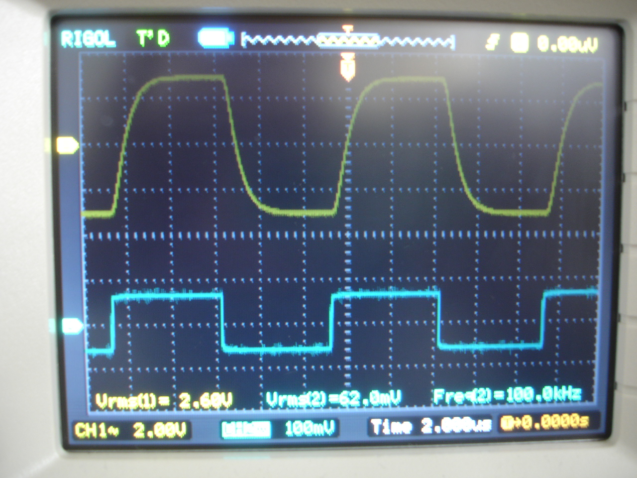

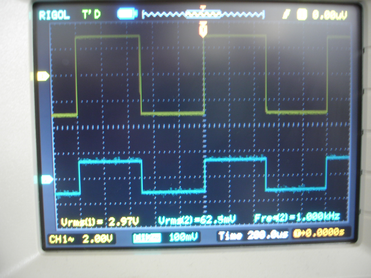

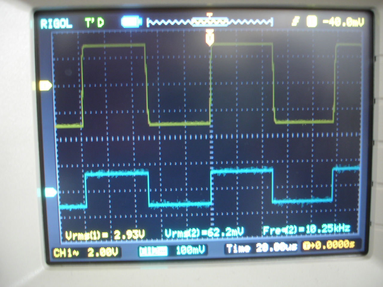

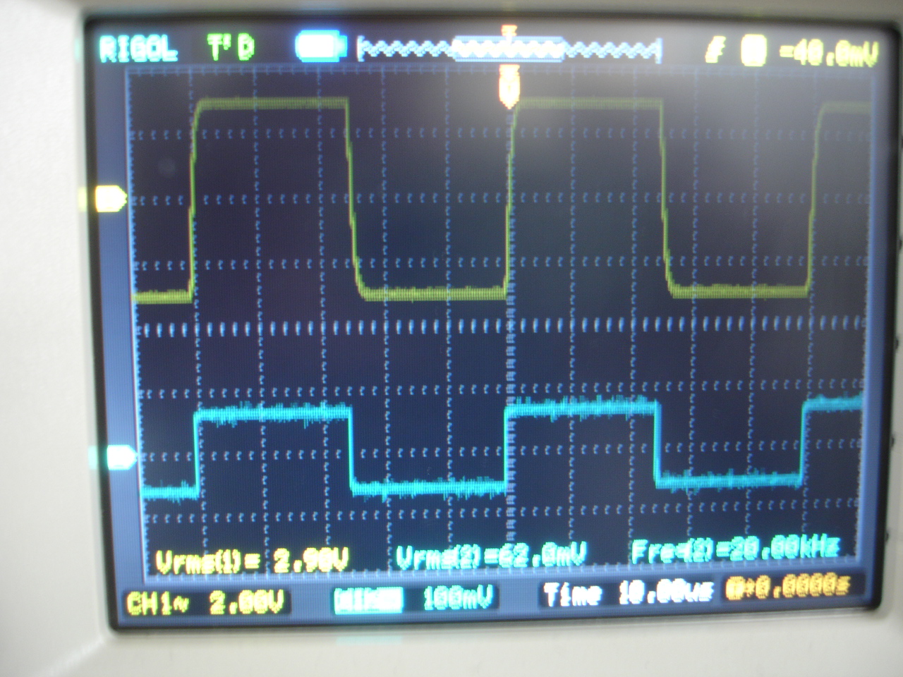

Now on the scope.
Picture No 6 6R//2.2uF DIRECT on amplifier out.
Picture No 7 6R//2.2uF AFTER LR filter out (direct on the load).
All pictures blue signal is input signal
yellow signal is out signal.

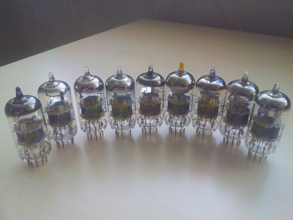

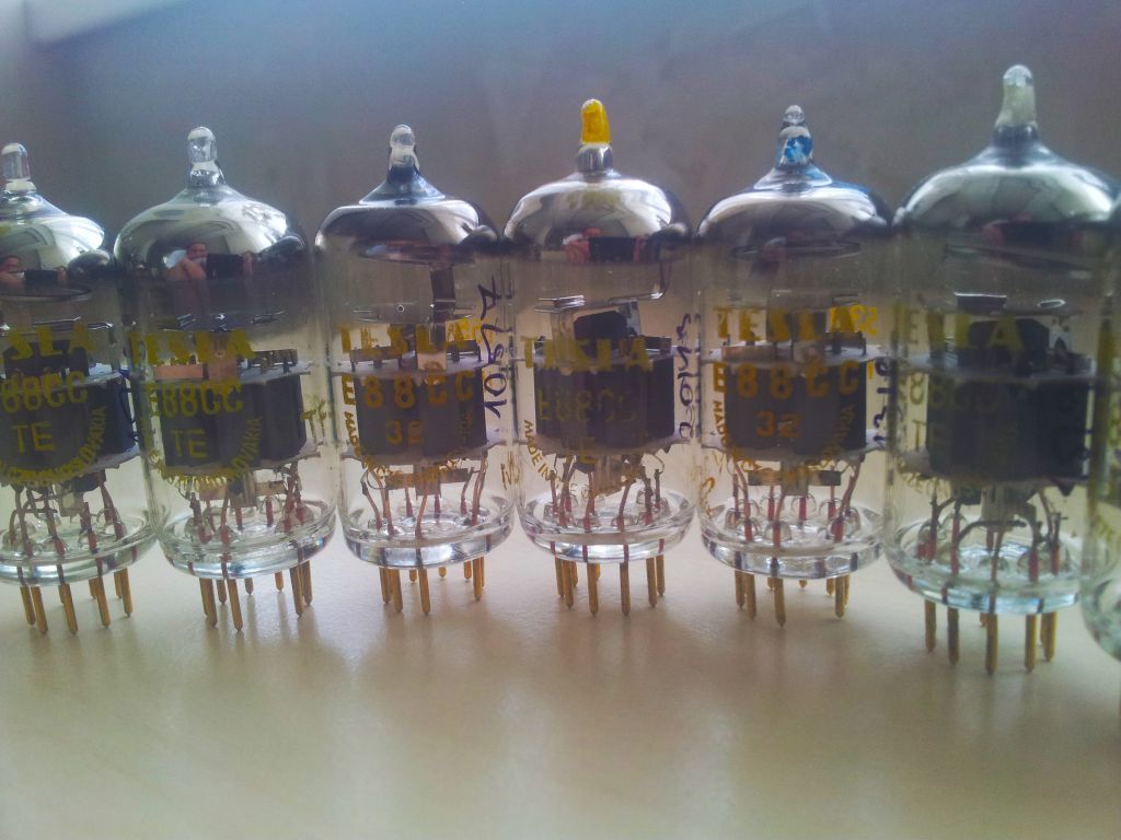

platon

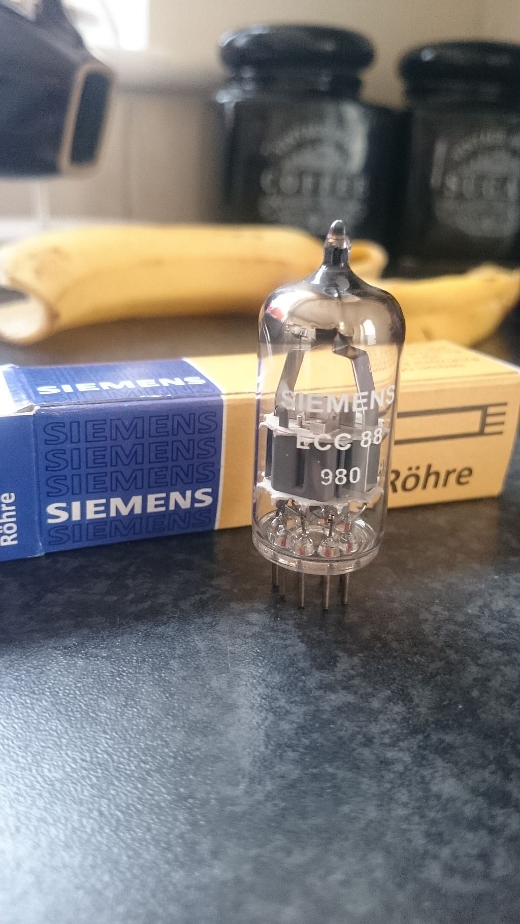

Nice army, I am not familiar with tube world a lot, tell me please if the Siemens I received today are any good ??
I am going to do some further development with ecc88 based amp and I need some decent tubes.
bimo
