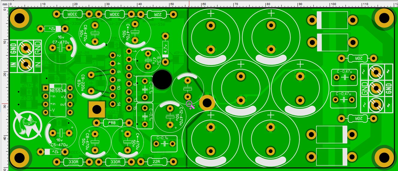

It’s definitely clearer than the original one, yes. The by-pass 0.1uF film caps mentioned should be placed on both the large 10,000uF & the subsequent 220-330uF caps or just the 10,000uF caps?

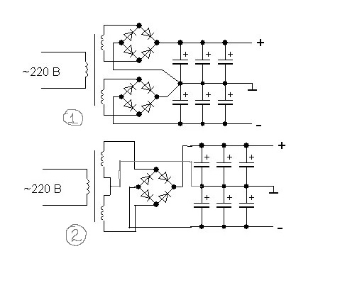

I think you should really give the builder the option to put an input blocking cap (0.47-2.2uF) on the board and not make them attach it to their input RCAs. My other preferences are 1) using two full wave bridge rectifier sets so we don’t have to use a center-tapped transformer. At least here in the USA our options for toroidal transformer choice increases greatly if we’re allowed to use a dual secondary setup and 2) just design the board w/o it’s own PS (therefore you’d only need a DC input (+, G, - )) and the builder could choose their own favorite PS arrangement...it would also give a little more room for the input dc blocking cap and the use of bigger diameter electrolytics around the board (like for Silmic IIs which always have a big diameter than their counter-parts).
its really not easy to get a center taped transformer.

1. The 0.1u bypass film caps must be placed as close to the consumer (tda7293) as possible.
2.Are you writing about the possibility of making such a power supply unit as in picture 1? And what is its superiority over picture 2 (just connect the two windings correctly)?
Yes, as in picture 1. There is nothing electronically superior about 1 vs 2. Many of us can’t find center tapped toroidals to use for projects that demand them. For instance, to power your two amp boards I needed to get a 300VA with 12+12 secondary outputs so, when connected correctly one gets ~24VAC (or 24BAC in Russian translation?) with a center tap line, so ~ +/- 34VDC with a center tap. Well a 300VA toroidal that has 12+12 secondaries is 12A. It’s huge and it’s really hard to find a smaller one with 12+12 secondaries that would be good to run the two 7293 boards with good power. Giving us a PS like #1 would let us use as smaller (and smaller amperage) toroidal. A lot of other designers have gone this direction.
