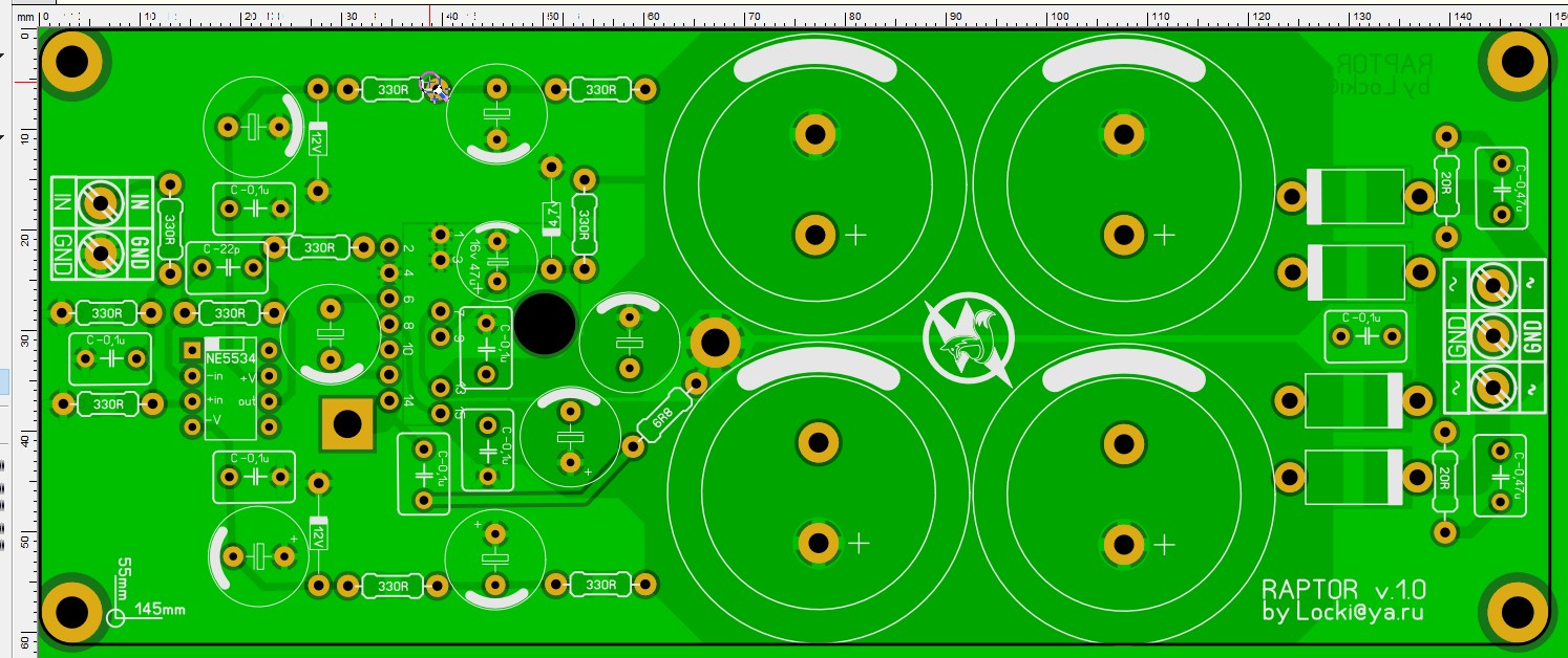

So here's a gerber for ordering the boards. If anything, Pete will help you figure it out (because he was able to figure it out with the previous version).dont forget this is still a hobby....

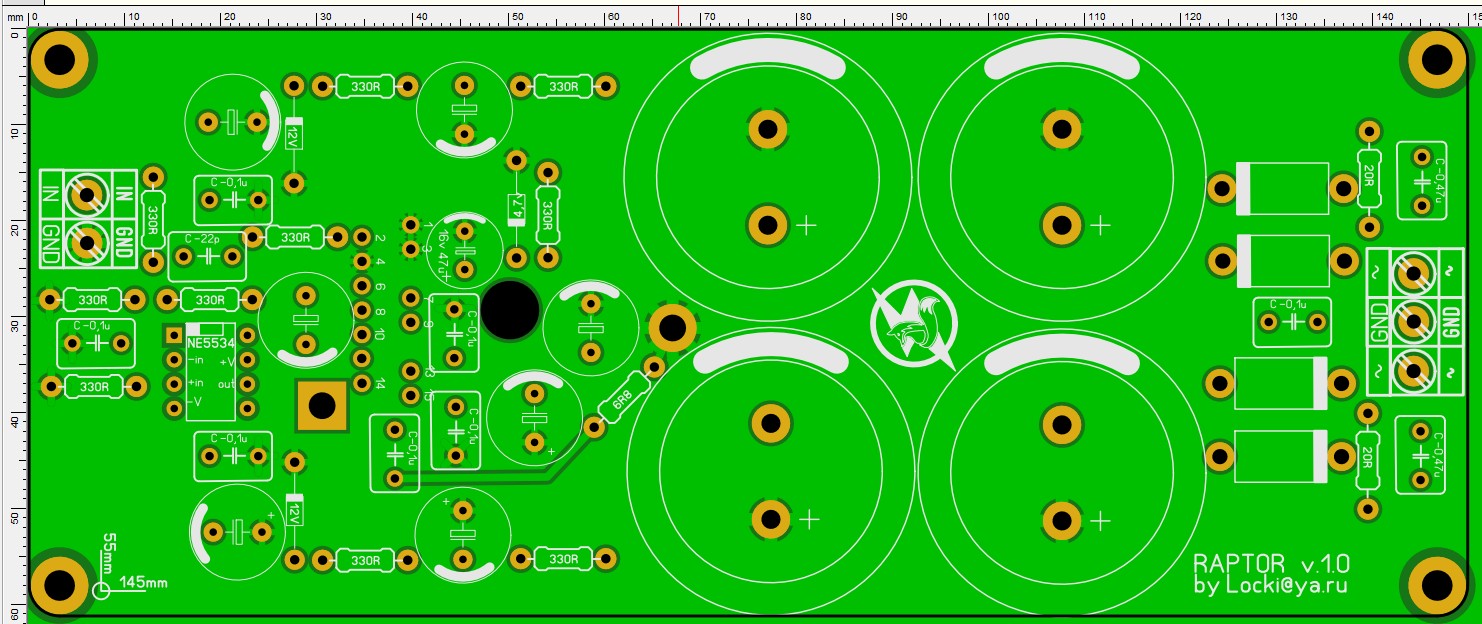

That’s the gerbers for post #34? What’s your thoughts on the re-design compared to the original? A quick glance looks like another set of caps in front of the opamp (which is also an SMD mount now?)

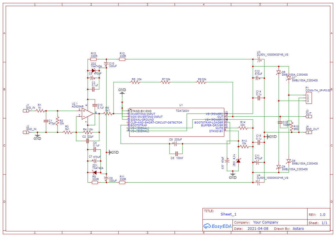

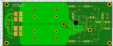

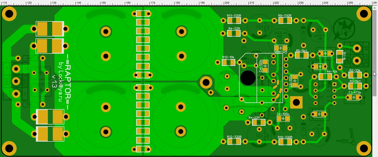

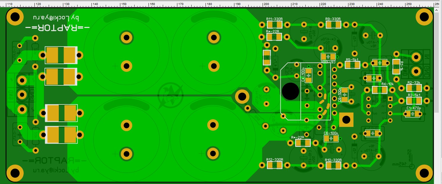

Firstly, I started to draw a circuit and noticed an error in the gerbera. There is missing one resistor to ground from the negative input of the op amp. I'll redo it and post it later. good news - drew a circuit. I'll come home from work, I'll post it. Pete felt sarcasm and yes, he was there just a little, but not even sarcasm, but self-irony, since in reality the article is not very good. I tried to embrace the immensity, in short. it was necessary to divide it into two and dwell in more detail on the parts of the amplifier circuit and draw it in more detail. I just had a remnant in my head, I thought it was simple, I thought that everything was just as simple for the others ... but in vain. I think to remake and rewrite the article on another resource, stop in more detail on some details that are not clear to many. Now that the amplifier has been repeated by as many as five people, I already understand what questions may arise.

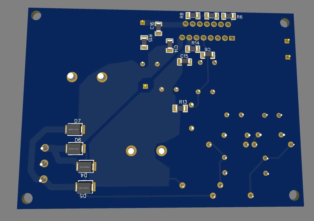

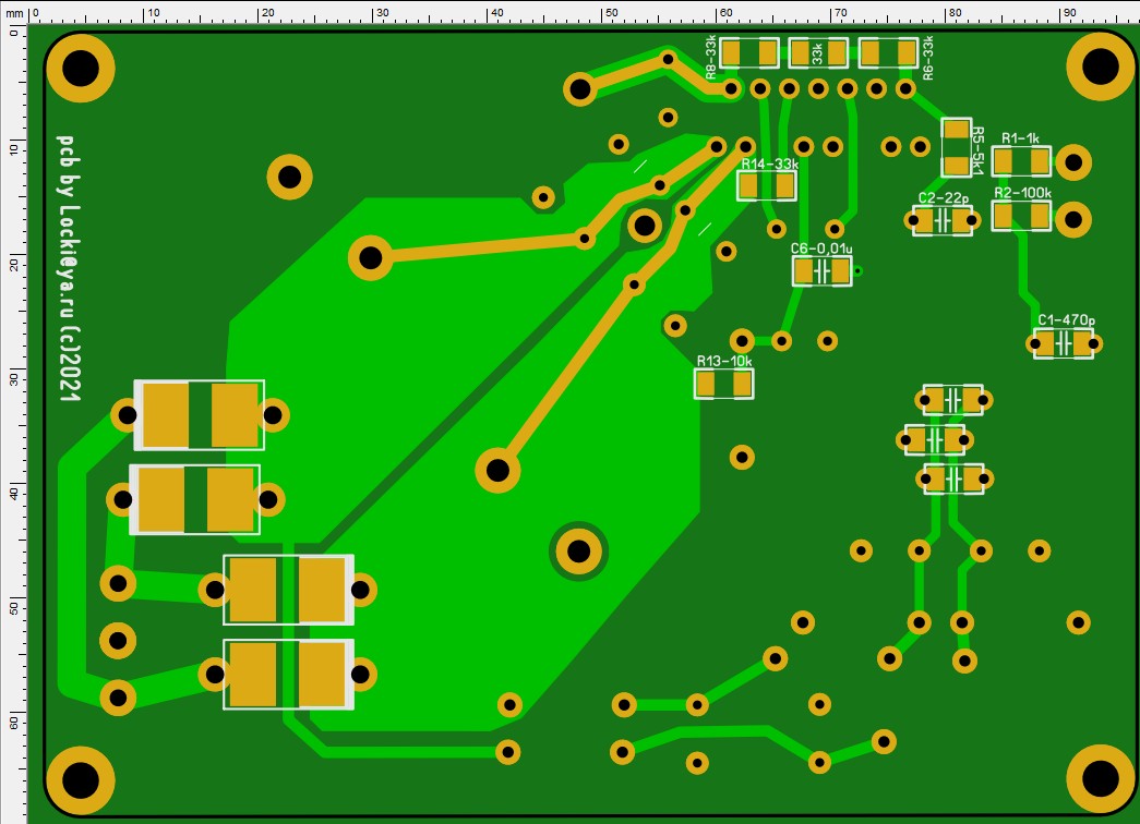

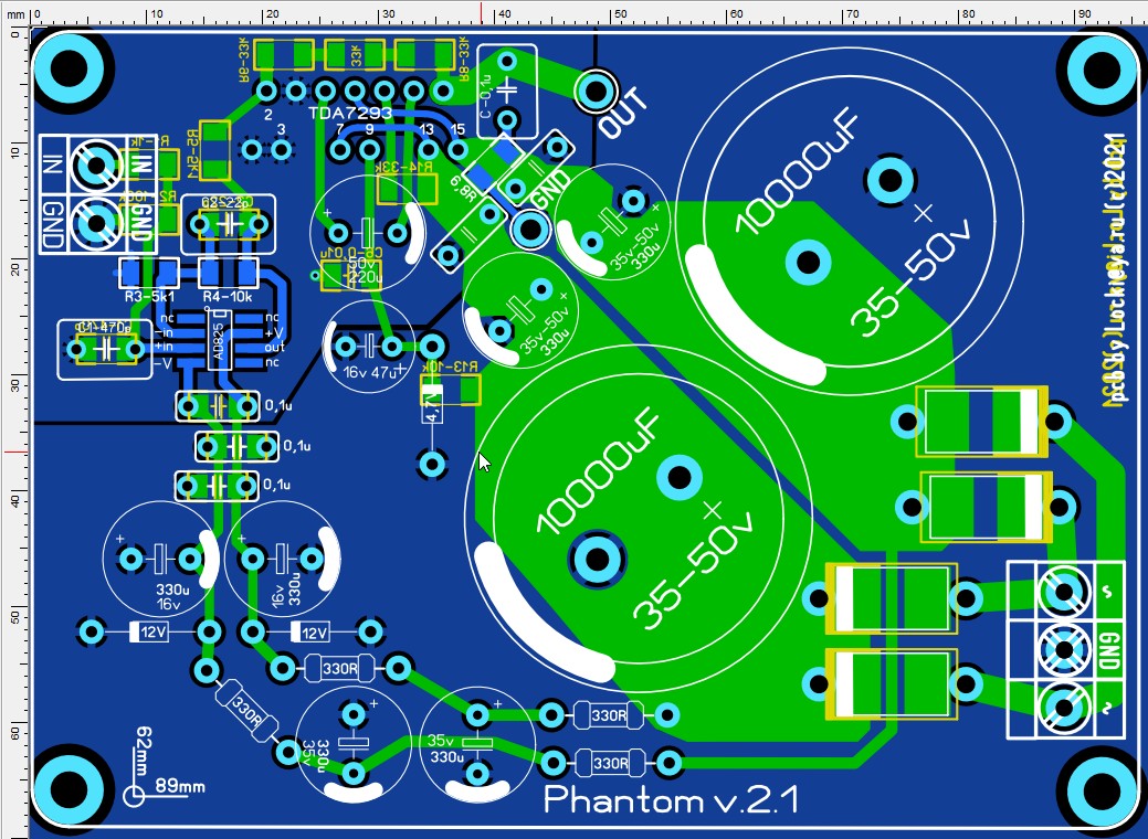

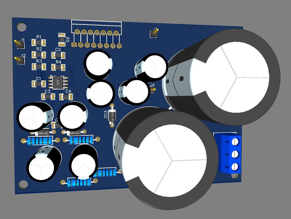

So, gerber corrected in the archive. The difference from the version that Pete made is that everything is redone on the SMD and the CRC chain is added, additionally filtering the power supply of the operational amplifier. Well, the scheme and screenshots are attached.
PS ^ the words, that seemed ironic to Pete, meant only, that I don't come here often, I can not answer at the right time. And Pete already understood my thoughts in this scheme, as he made a similar one.

Astaro: much appreciation towards the new PCB layout. I’m not sure which protection circuit you are addressing here?
Is it possible to move the 6.8R SMD to the underside of the board with the rest of them?

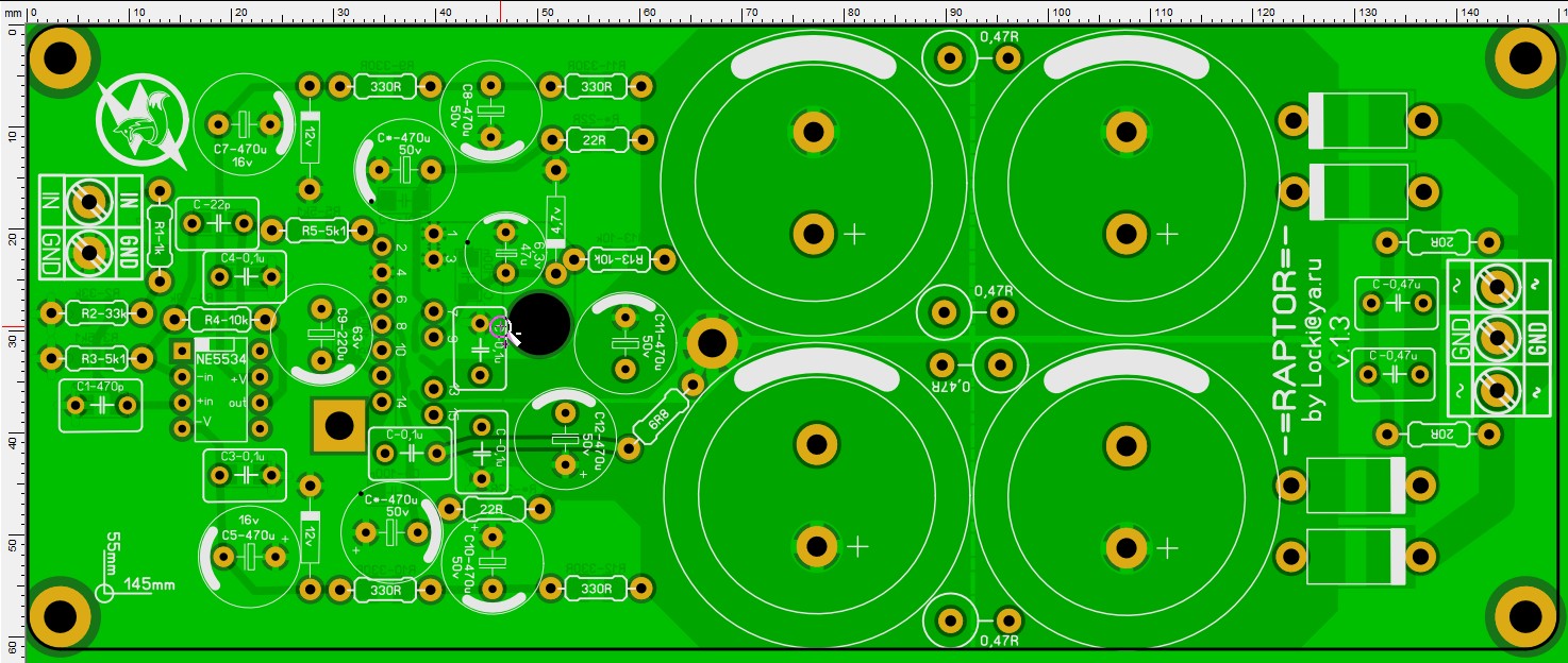

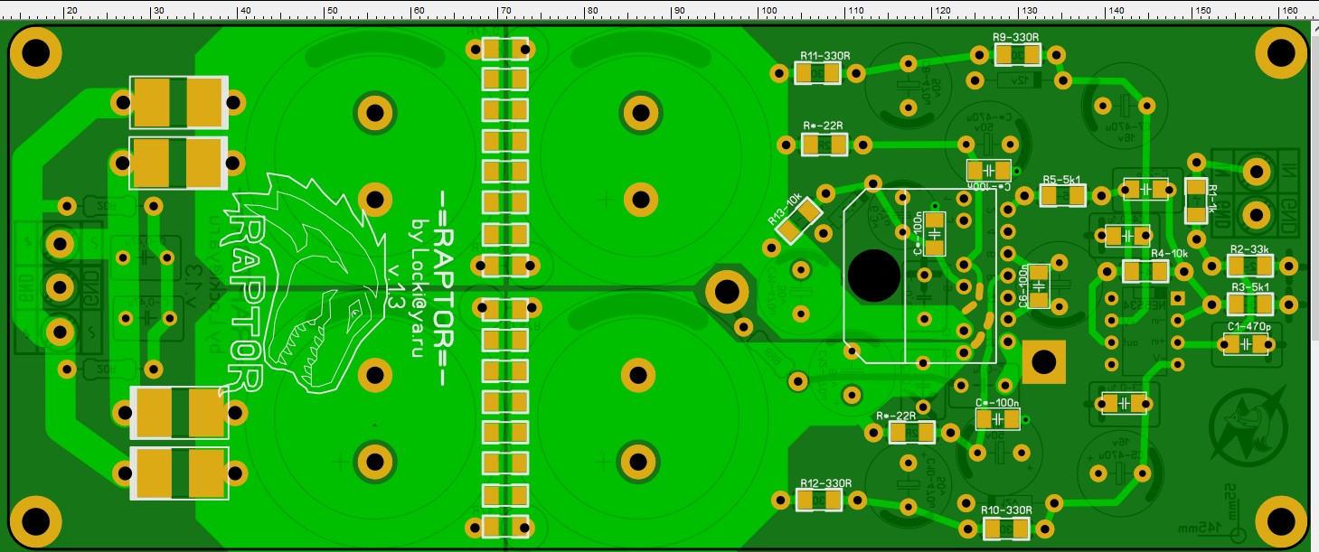

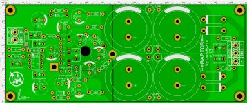

And who will say what about this option? The board is positioned parallel to the radiator. The high-end edition: more capacitors in the power supply, "blackjack and fallen women" and other things (like snubber in the power supply). I will could also power it separately by pre-filtering the legs of the pre-stage (legs 7 and 8)
Someone is ready to collect for himself and write here as a sound and with what he compared. if there are any, I can post a link to order boards

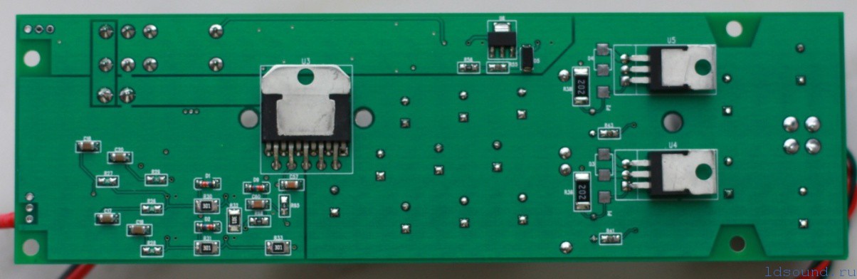

Astaro: the tda7293 is in the middle of the board. How are you going to attach it to a heat sink or am I looking at this incorrectly?
Pete
I just did not do the"H" version, but under the usual one, just she needs to bend her legs 90 degrees so that she lies on the radiator, and her legs go into the board, lying parallel to the radiator, too.
Now it's like this
Everything is filtered by CRC. It can only be cleaner with a stable power supply.

I think this is the final version.
I don't know what else can be improved here...

Hi Astaro
if i compare the input with post #33 i see that you omit the input cap(2,2µ//10nF)
Why?
