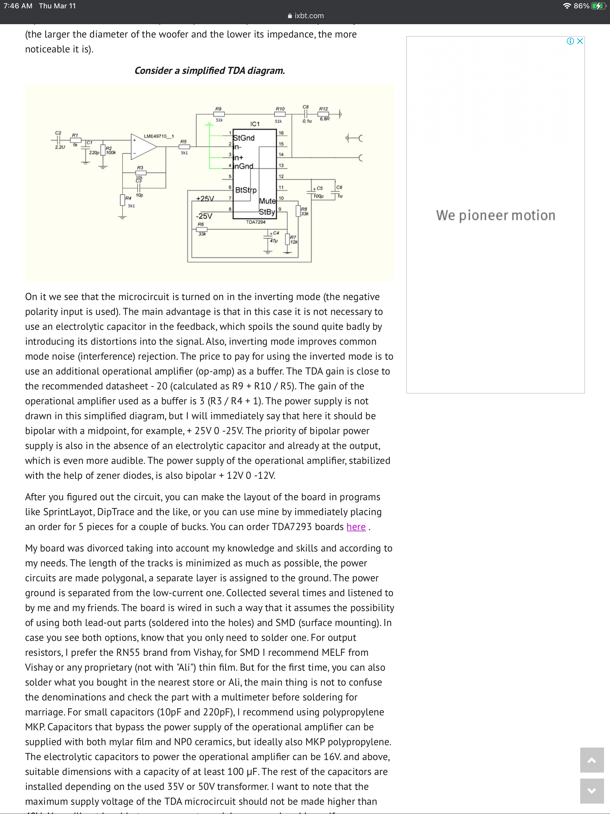

Chris: I only saw this on the translated Russian build article...
thx
YW! In his schematic, C5 is incorrectly reversed BTW. Then "+" side of the cap should attach to Pin#6 of the 7293.

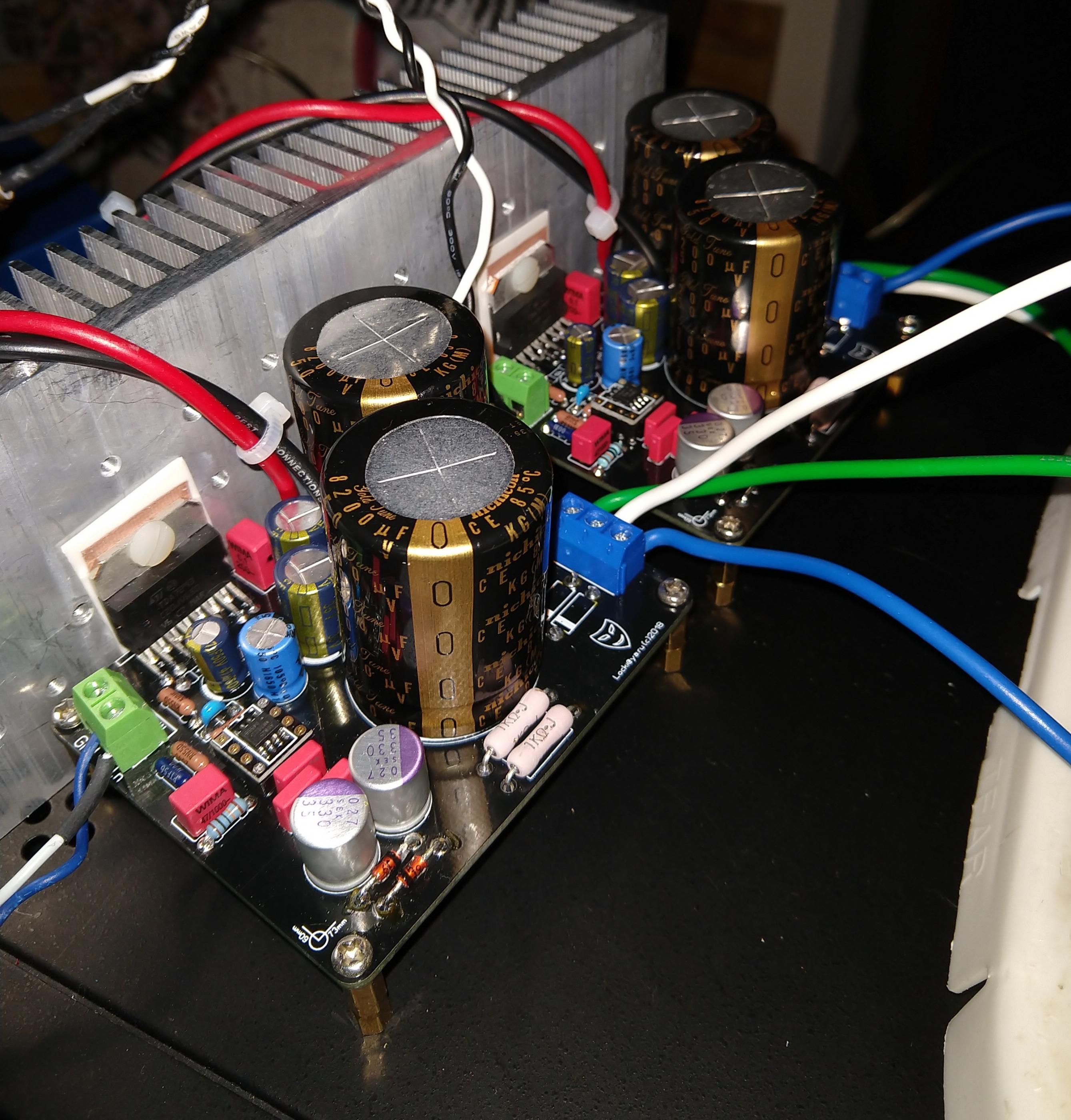

I’ve actually built up two boards that are made from this schematic. Other than having to mount C5 in the opposite direction (than how it’s stenciled on the board) AD825 was used as the opamp. Still burning it in but it sounds pretty good. Some dislikes....The board wasn’t made big enough so things crowd each other a bit and onboard PS requires a CT transformer. I also had to mount some resistors on the bottom of the board so some caps would fit correctly on top. Bass is quite good.
I’m awaiting boards from a Russian fellow (Audiokiller) for another 7293 build up. His boards have a lot more information provided along with a good amount of technical explanations of his design implementation. His design uses a unique negative feedback design. His website needs Russian-to-English translation (by the web browser) as well.
Cheers Pete

Things to keep me occupied while we here, in my country, wait for the society to be able to safely open back up. As a side note, I’m finding a prefer the sound out of many chipamp builds based around LM3886 or this TDA7293 than any of the Class D amps I’ve tried over the past two years. I also prefer the component choice control using thru-hole mounting instead of the SMD used by most Class D amps.
JMHO. 😉
Pete
The problem is, i did a side by side comparison to tda2050 on 18v rails. but! i am really disappointed by the bass tda7293 puts out on my speakers.
That was my expeience as well, compared to an LM3886 board and other amps I have on hand. I'd just accept it and move on.

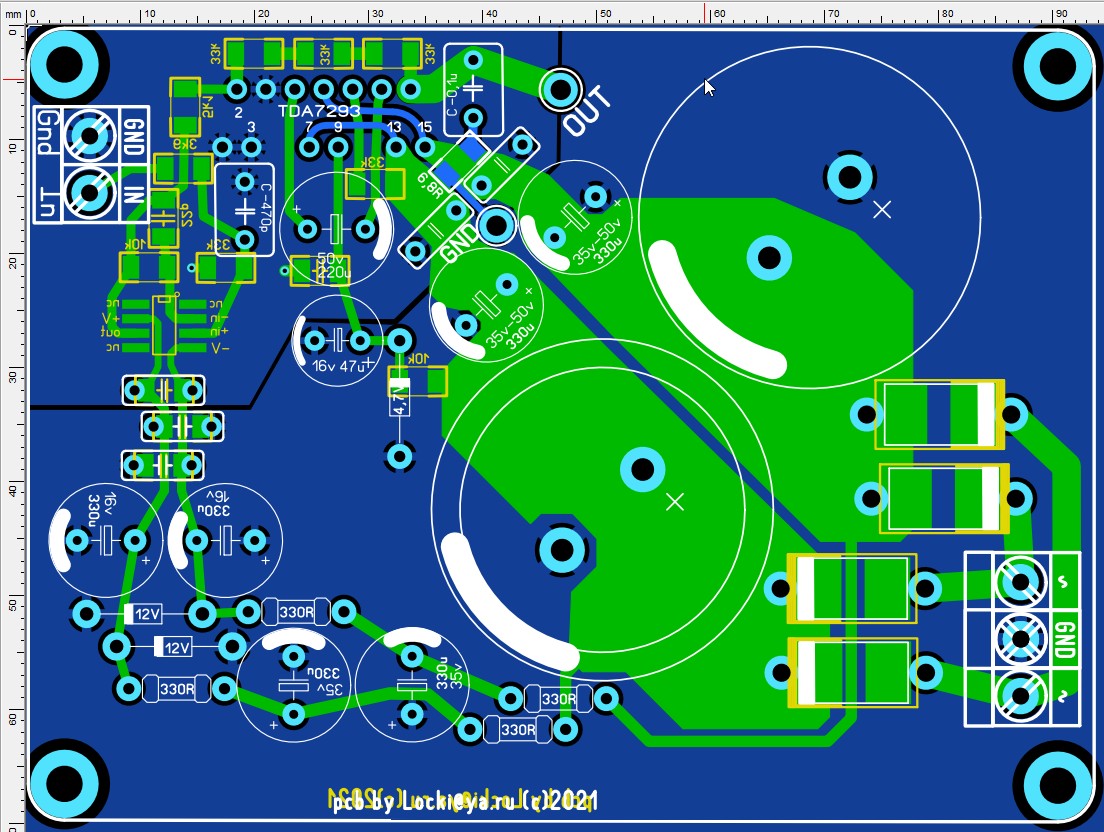

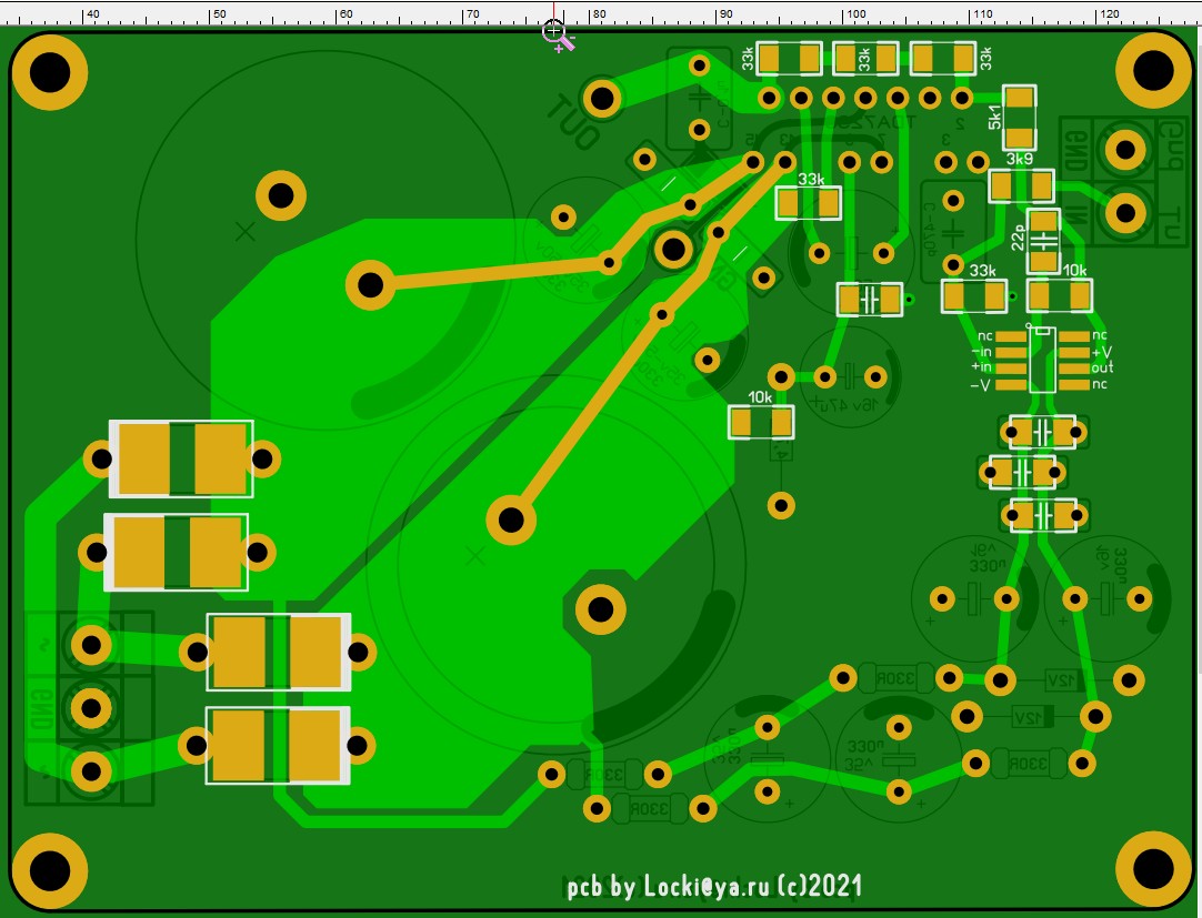

Congratulations on defeating my little "monster" and figuring out what I had already forgotten about (a capacitor with an inverted polarity). This was the second board I developed (drawn in the sprint). Please do not judge strongly biased .- ) I hope the sound is not worse than others. The unique design of the "Audiokiller" is T-shaped feedback? I didn't hear the difference with mine, but who knows, try it. About the fact that You like the details with output contacts more than the SMD I will say. Put Melf or thin-film resistors, and not the usual thick-film ones, love it then. -) And here is a really interesting circuit on the TDA with a reduced gain, which increases the depth of feedback and reduces distortion (see figure). I'm thinking of making some boards for myself...
Your comments, friends?
If I were making an amp now, I would do something similar to this

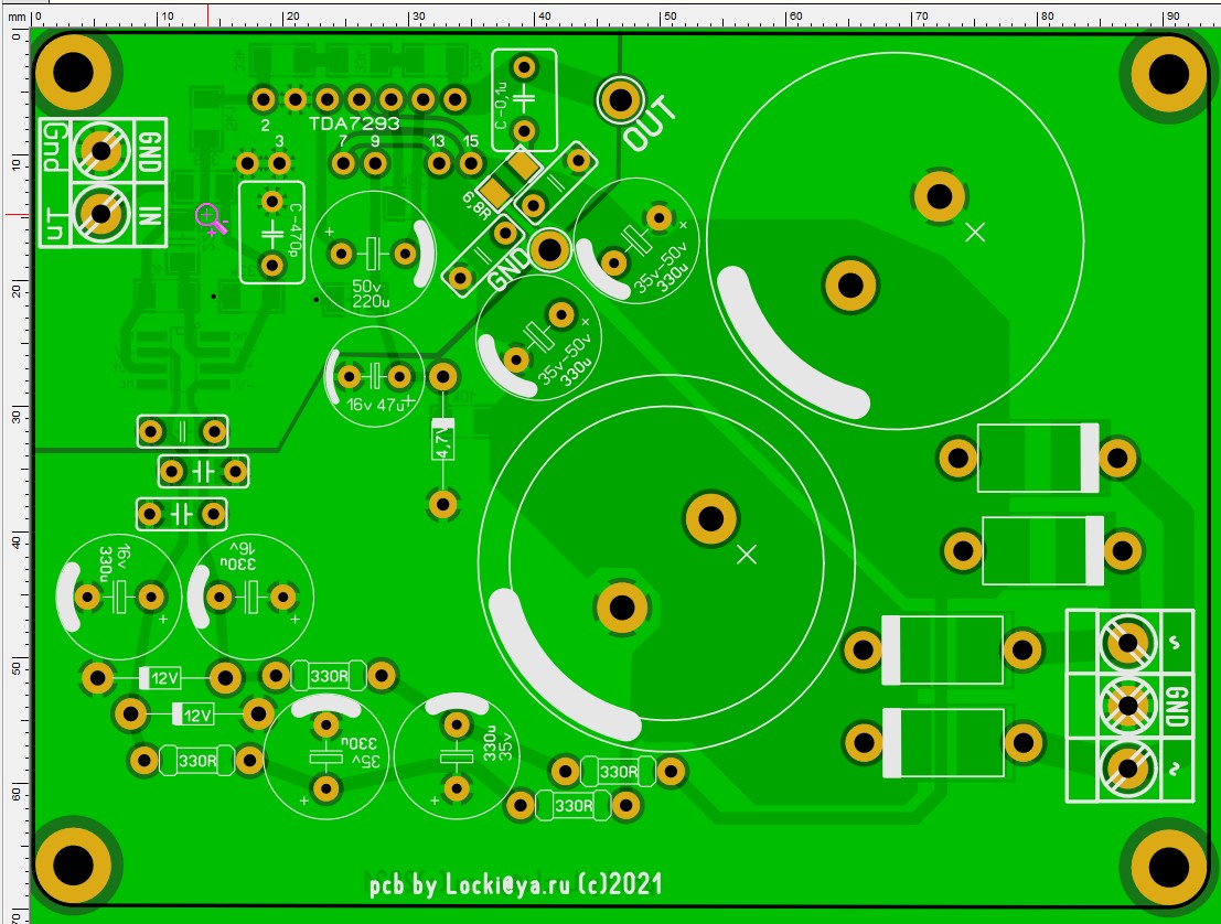

I think a board that allowed an external PS (more capacitance on each rail) might be an improvement. Would allow you more room for the amp circuitry’s components. This way folks have a choice of how to power the unit.

well, what options can be in the power supply? Put 10000uf on rail of power or 100500uf? And what will it do? If only CRC ... But is TDA7293 worth the effort (and money) spent?
It's a matter of giving builders a choice and not imposing what you feel they should do. If they want to put 20-240000uF per rail, let them

I can also argue, as it seems to me, the builder wants a choice - he already makes all himself based on his thoughts on how it should be
but I never want to say that you are wrong. of course there is logic in your words and I understand it.
