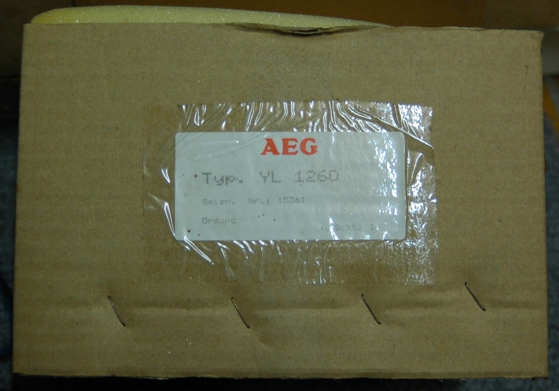

Hello ,
new YL1260 have the same number on the tube and the package .
Kind regards , Alexander .

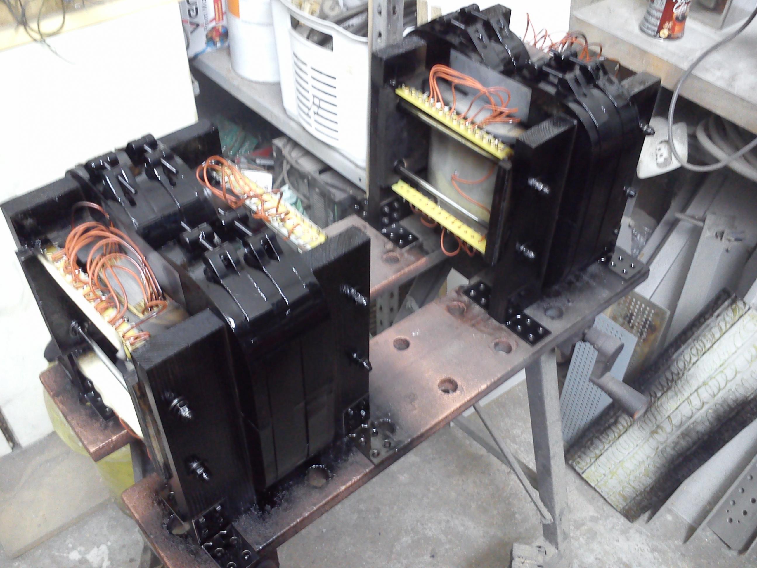

Where would one get an OT for 500 Watts though. Could almost go OTL. And then speakers.
Ehh, forget it. Probably all go up in a big fireball. Just Day-dreaming.
OT for PP and 1kW output power (~600W at 20Hz!)😉
