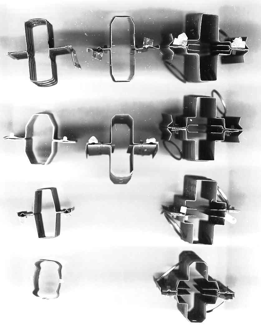

By "Cavitrap" I'm guessing you are referring to a plate design with a recessed vertical slot along the side support seams, with short "Barkhausen" plates sunk down in the slot. The idea being to keep any secondary emission (mostly via grazing incidence) trapped down in the slot, bouncing around in there till it gets re-absorbed. Most, if not all, of the later, bigger, TV Sweep tubes seem to have that construction. The earlier TV sweep tubes generally offered positive V (like +30V) on g3 to clean up "snivets" (VHF bursts). The later TV Sweeps generally advertise that the +30V is un-necessary (using Cavitrap designs).
I have occasionally heard comments about Barkhausen plates effecting the sound quality of tubes. (mainly intended to reduce VHF parasitics, but an integral part to the Cavitrap design as well) Probably just the slightly more squared up knee causing sharper clipping.

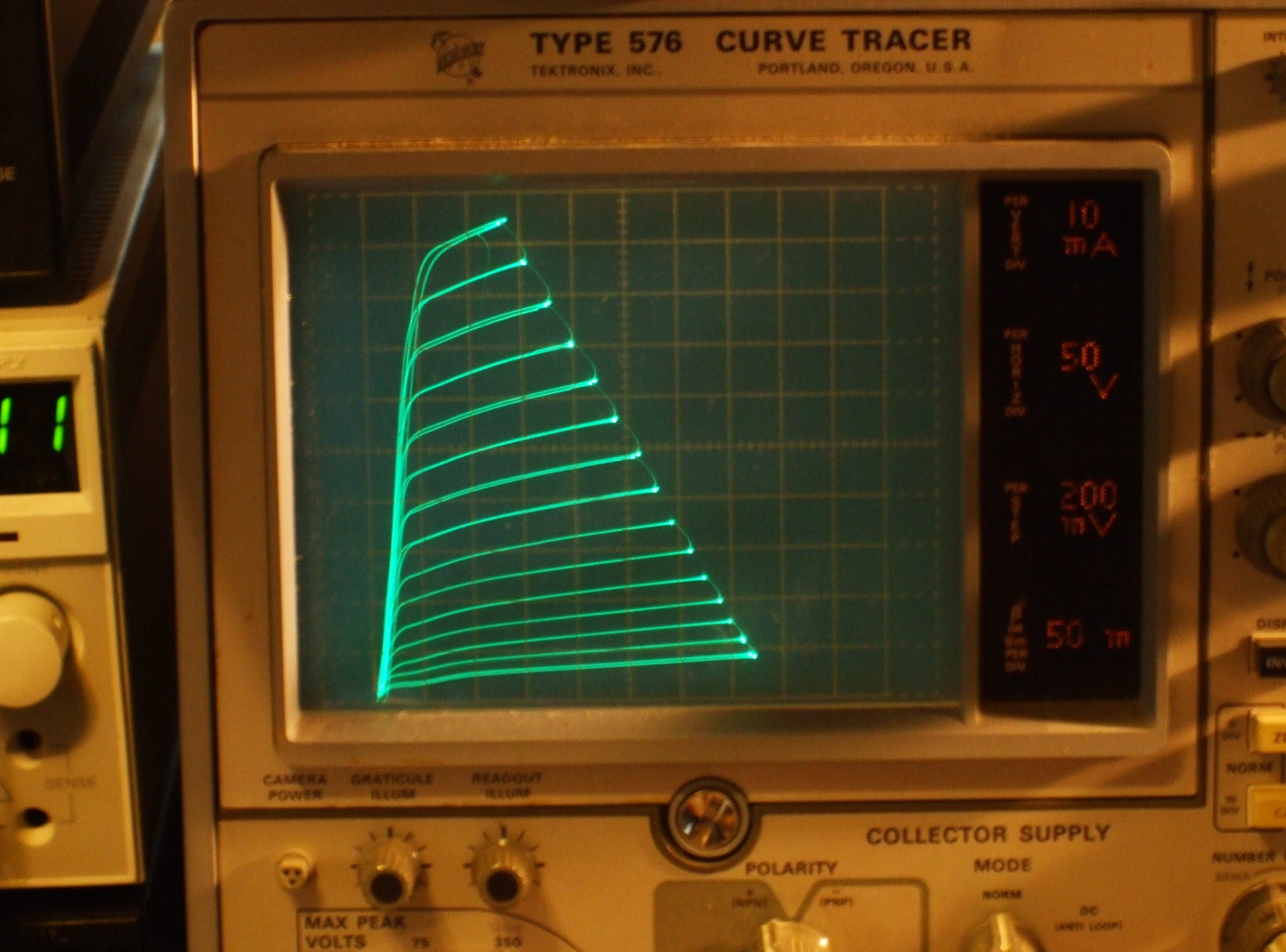

I have encountered very sharp knees in the little RF tube, 6JK6. I suspect the g3 slot is intentionally made too narrow there so as to reduce capacitive coupling between plate and grid 1. A small positive voltage on g3 greatly improves the knees (lowered knee voltage), and also removes a bad hysteresis problem around the knees. (plate curve different for increasing versus decreasing plate V) Some "made in Japan" 6JC6 RF tubes I've found have a similar problem, and can be fixed with +V on g3. The US ones generally seem to not have the problem.
The Marantz 10B used these 6JK6 tubes extensively, but biased the g3 the wrong way. Apparently preferring to ground g3 and self bias the cathode up for RF reasons I suppose, or just convenience. They probably didn't have a curve tracer to see the hysteresis damage.

Some TV Sweep tube plates:
The left column ones being plain desgn.
The middle column having Barkhausen plates.
And the right column having the Cavitrap design. The top two also having the"winglets" extension on the outside from the Barkhausen plates. Better cooling of the "Barks" .
Another odd feature I occasionally see in the TV Sweeps are "waffled" inner edges on the g3 slot. 21JV6 and 35LR6 have them for example. Not a serrated edge, just crinkled. Maybe breaks up coherence of "snivet" oscillations?
Evolution of Cavitron design for similar tube:

The positive Beam Plates (very confusing when you keep referring to them as G3 slot lol) actually makes the knee less square, source: you I looked through all the experiments you did with the different voltage on third element on that post you linked, a fricking gold mine if you ask me, in fact is it possible to share those traces on my blog? I want to do a few posts on the positive third elements, until now I never seen what effects positive beam plates actually have. Also I did not know what snivets were, I thought it referred to odd kinks in lines in some random places certain tubes experience (QQZ03-20 for example, search 8118 tube data to see the curves) but this makes more sense (also if you could explain exactly what these bursts are I'd appreciate it).

Perfectly fine to copy or share the tube tracer curves, they are intended to be public access.

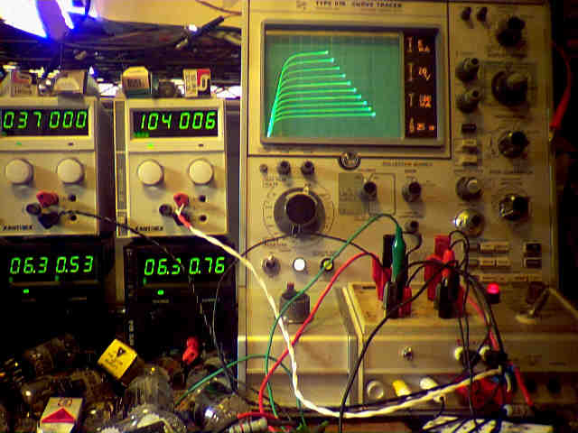

I'm using a Tektronix 576 curve tracer that has been modified for tube use. Mainly an extended (0 to 170 V ) step range, now with up to 15 step curves (was 10) and provision for automatically switching in two screen V supplies to the two tubes while under test. Very nice for matching or comparing tubes.
The high current capability of the 576 is handy for the big TV Sweep tubes. (2W, 10W, 50W, 220 Watt max selections) I'm usually using the 350 V collector sweep (50V/div). I also have a 700 V select available (100V/div, was 1500V originally, but I modded it down to 700 V, via full wave rectification, to get twice the available current on that scale)
Unfortunately it's down right now due to a bad LV power supply, and my attempts to fix it have been put off due to a bad toothache.
The "snivets" thing was explained in some now obscure article as the buildup of a charge cloud around the screen grid at high conduction, that oscillates back and forth (at VHF) thru the screen grid when the plate V suddenly drops to the knee V level or below. Apparently the neg. suppressor or beam plates prevent the charge cloud from dissipating to the plate quickly. Hence the positive V fix on g3 for this. The Barkhausen plate fix apparently helps too, maybe by making the oscillation freq. different at different beam positions.
The knee hysteresis problem I have seen mentioned in several books as an unstable buildup of the virtual-cathode charge position depending on the delta V direction when approaching the knee V. I have seen this on some very sharp knee tubes, not common. Usually some +V on supp. grid 3 will help, although beam plates have a much weaker influence.

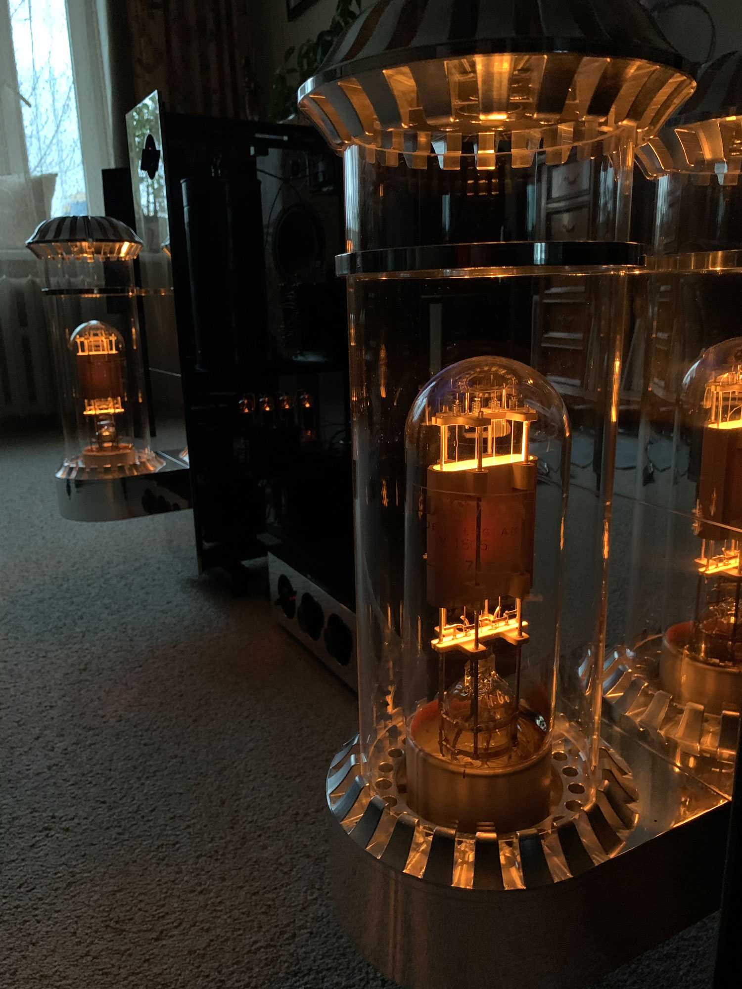

CRAZY AMP!!!

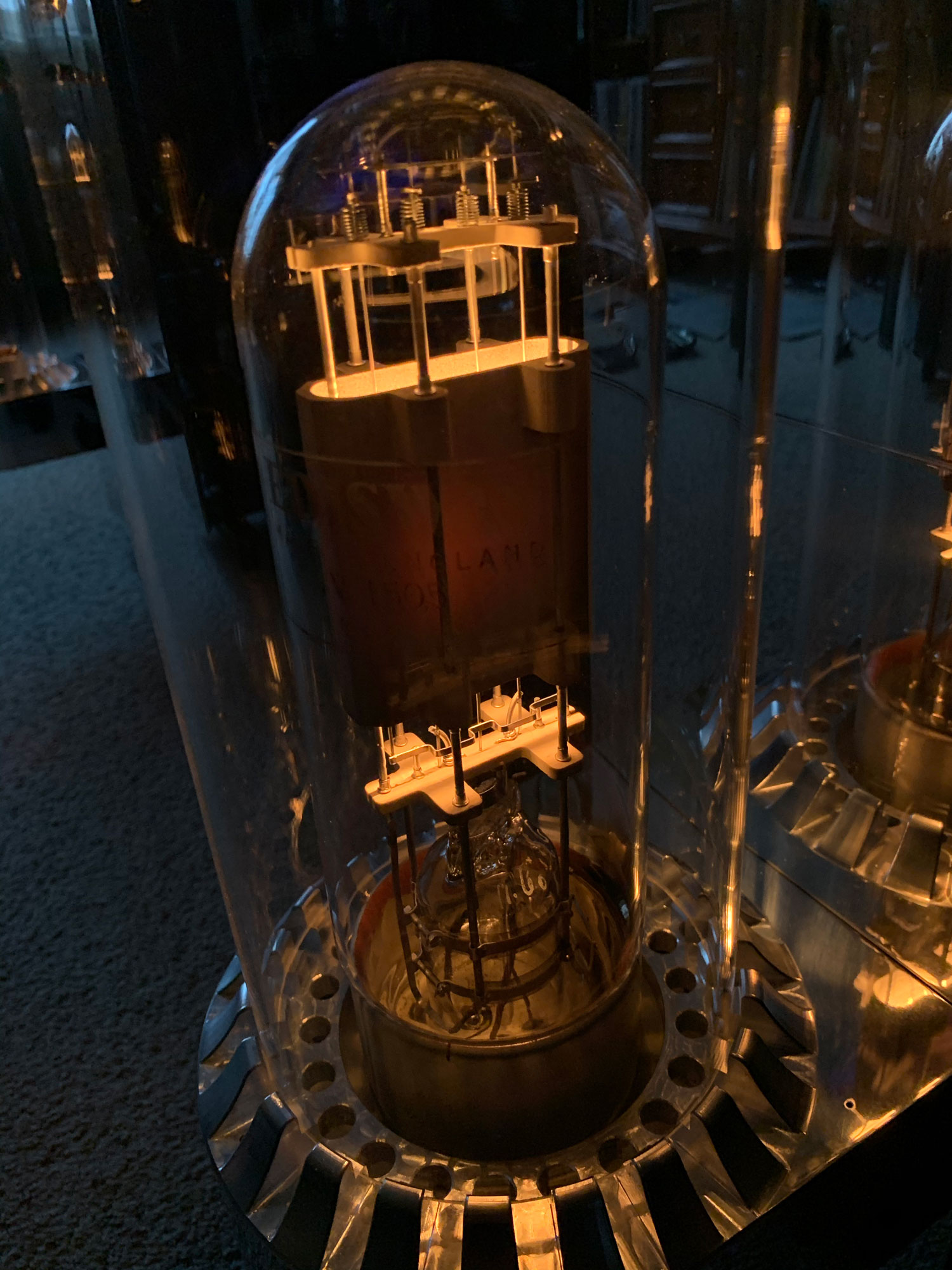

At first the images didn't show, and I saw some other huge triodes, now I see some V1505. Awesome.
Also, FWIW I believe the V1505 UHF triode has a Cavitrap serrated anode (assuming I am up to speed with the lingo), though it isn't carbonated.
I'd still like to be able to build something class A with them, but, even ignoring the kV HT required, the heater power is something else!
I got halfway through converting one into a table lamp. Even the PSU for that is large.
I have the original 1950s schematic for the Class B amp they were intended for, and 2 or 3 spare Ediswan V1505 tubes that look brand new, but I figure they dont have much resale value; untested, and no valve tester I know capable of checking them!

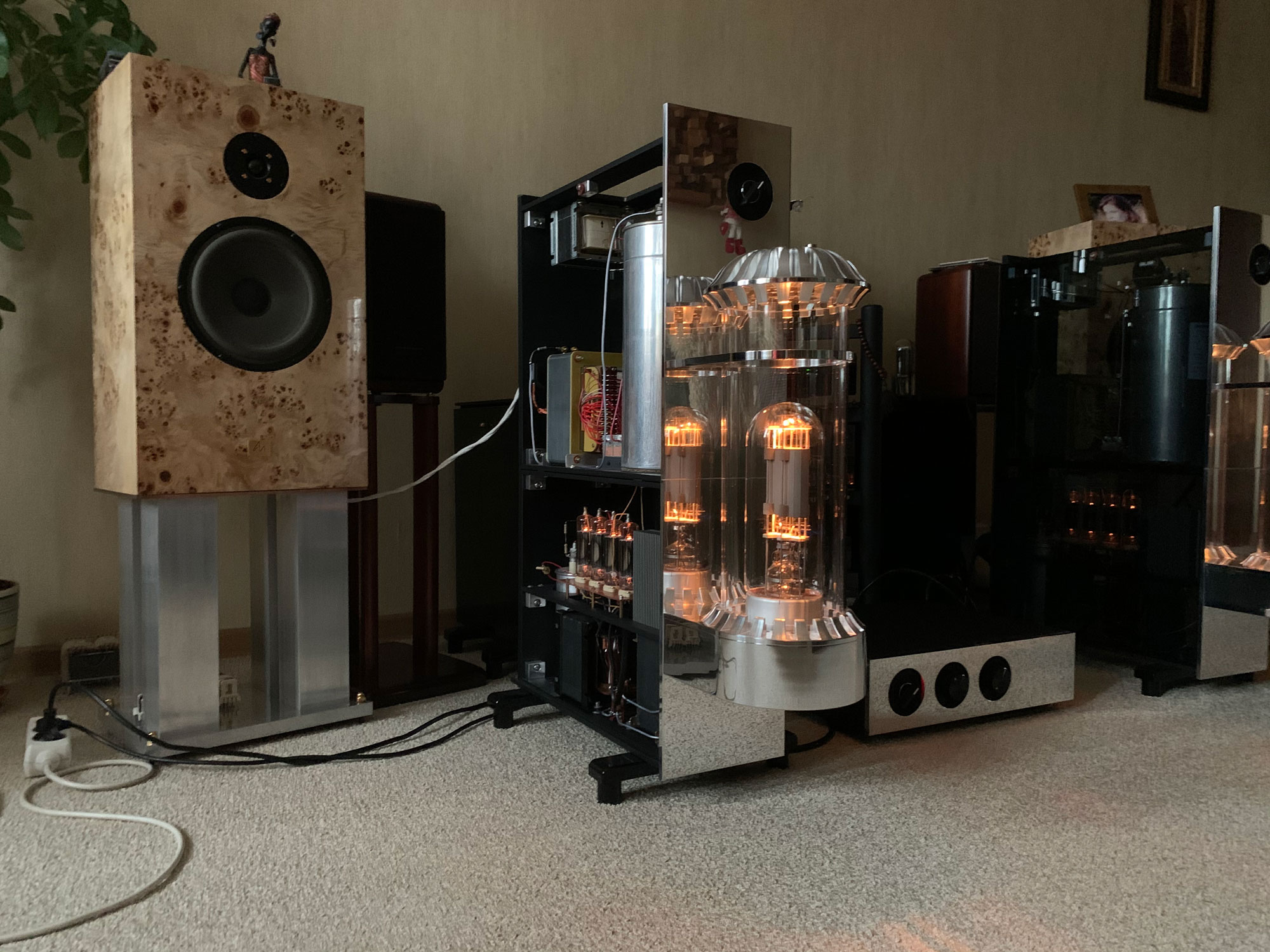

EY500х4What are the 4 smaller valves at the bottom of the photograph?
I assume the driver stage? The schematic I have shows them driven by EL37 or KT61
Preamp 12ax7 + 76
