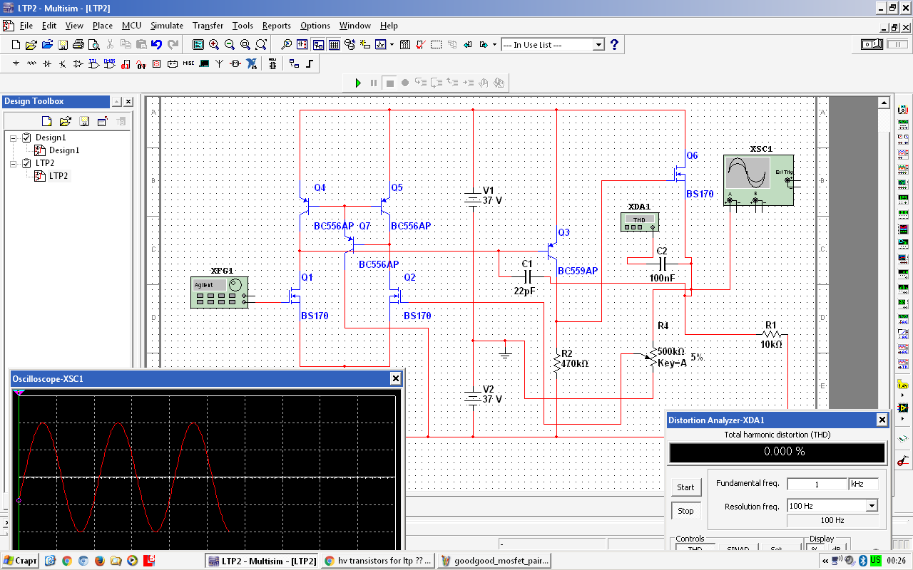

Hey this long-tailed pair is very interesting but they are many many questions and different combinations..
I think i will use two npn's with one resistor as load and current mirror as bias of both.
Maybe i need another transistor between the output stage and the pair ?
10pf compensation ?
Another question: look at the attachement, i readed this is an improvement but why then its not used in audio circuits ?
I do not want to use many transistors, so I need only 1 current mirror..

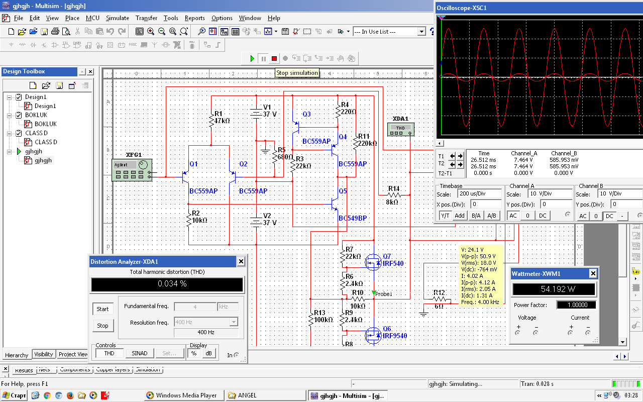

Attaching circuit that i have found and tweaked to minimize dist.
This was before my fail tries and this was the first fail. The problem wass too high bias voltage 🙂
However I never tested it and this is a big distortion 😀 0.034
I have soldered this as "module" part and need test.
However i dont want to use this circuit, i have seen better ones like in jilny's thread. ( I dont understand much but common sense 🙂 )

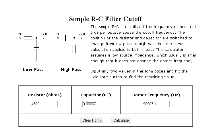

I calculated that its better to use 4.7k for gate stoppers because freq with 4.7 and 670p (input gate capacitane) is 50khz instead 1Mhz !
I think this stops more oscillations.

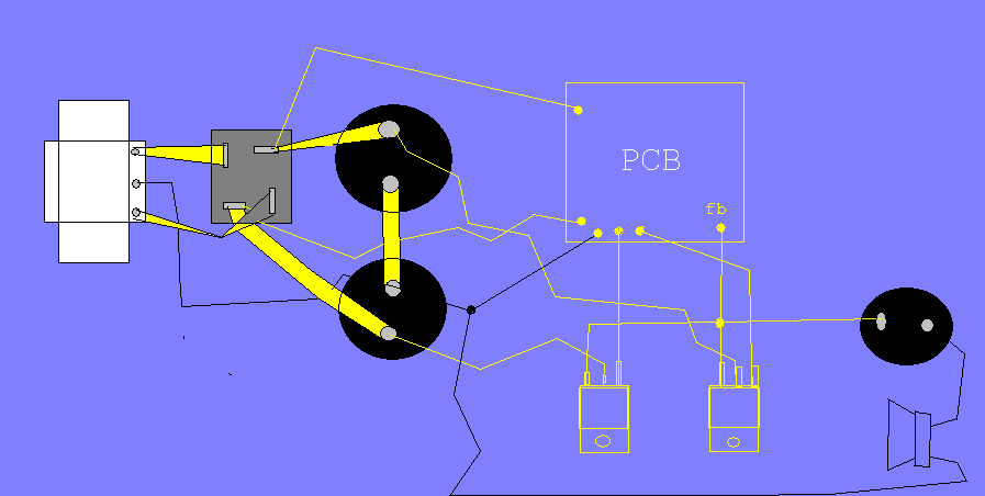

And a problem: 50hz brum. Is this from power supply capacitors ?
They are 4700uf aand I short circuited them many times unexpectedly.. They are damaged or they are too small ?

Regarding your hum problem: please draw just a brief layout in paint which shows
your components (PS, input, amplifier, Speaker, etc...) and ALL GND wires first.

Thanks! And how is the input connected?
Where the signal GND is going?
BTW: how the hum changes when the input is shorted or open?

I dont see the zeners, where they are?
So the input GND goes only to the PCB?

zeners are here look @ the attachement.
from the board (zeners) there is another wire to the common ground
Hehe, ok! 🙂
So in total how many GND wires are going to/from the PCB to main GND?
And on your video the hum changes. What caused this difference?
Also you could take a close picture from your PCB from the top.
one wire from signal to PCB and one wire from PCB(zeners and the fb) to main GROUND.
I was touching the cable with finger ? 😱

Ok, I don't see any major trouble with your ground wires.
But it's still not clear: when do you have this hum?
Regarding yout video: which wire did you touch when it increased?
And what happaned at 0:17 when the hum completely disappeared?
