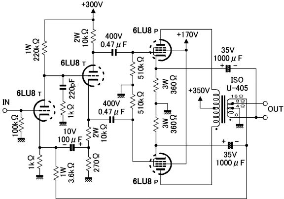

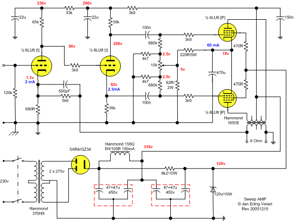

Since all of Jan's pictures and schematics for this thread have mostly disappeared, and I found some info on it for another thread using the Wayback Machine, I'll re-post what I found again here.
Jan's old site info (1st pic):
6LU8 Sweep-AMP
Tony Tecson's thread on the same or similar design to Jan's:
tony's 6LU8 push-pull power amp build
There also was a 6LU8 version of Norman Crowhurst's "Twin Coupled Amplifier" by John Stewart in AudioXpress August 2004. Apparently it was a free download at one time, but it has to be requested now from AudioXpress.

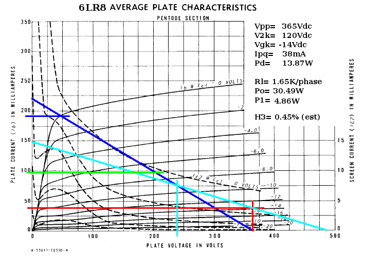

Another vertical deflection VT that looks really good is the 6LR8. I have a bunch of these with 21V heaters. The audio loadline looks pretty good here, with some decent output. The h3 estimate is under 1%, and you have nearly 5W of Class A1 power.
The type also includes a small signal triode that can serve nicely as a cathode follower grid driver. I would expect this type to make an outstanding audio amp. The 1.65K/phase translates to a primary of 6.6K -- a stock value, so no need for a custom OPT either.

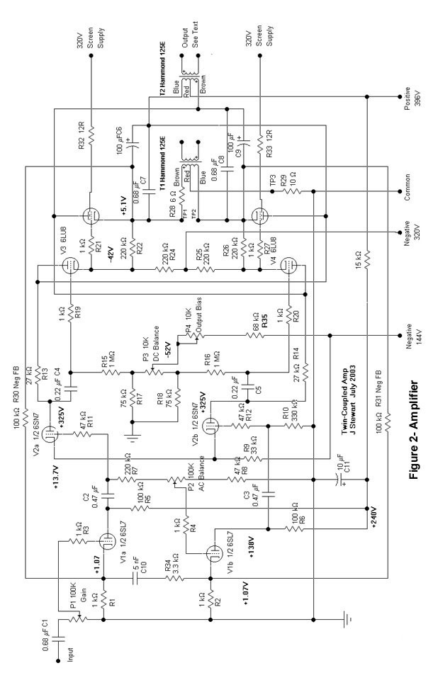

6LU8 Sweep-AMP
Another similar 6LU8 design with CFB found on the Web (2nd pic):
????? vol

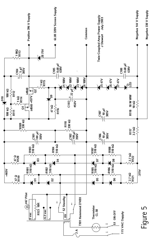

I wanted to build in some safety, the IFR840 is rated 500V max source to drain. At startup there is the possibility of exceeding that, so Q1 is slaved to Q2. Q2 is controlled by R116 & C103 for a slow HV turn on. When C103 is fully charged the HV is set by the zener string. Q2 becomes a source follower with low impedance output to the load. There are FETs now that would not require this hookup.

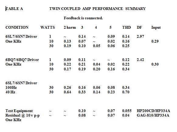

I built Crowhurst's amp out of curiosity. This one uses Crowhurst's front end but can be changed to a 2-stage differential front end, by switch on top of the chassis.
The amp manages 35 Watts at clipping. All done with 'Off The Shelf' parts, nothing Boutique in this one. And no tube selection, the test results are 'as is'.
The DF numbers would look better if I had used purpose built OPTs as Crowhurst did. The OPTs used are off the end in this cct.
For an ordinary 6LU8 PP stage running 400V plate & 300V screen the load impedance would be about 6K. UL at 300V, about 4.5K.
As usual people asked 'How Does It Sound?'. Like any properly operating amp it sounds as good as the speakers it is driving. What a surprise!!

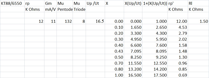

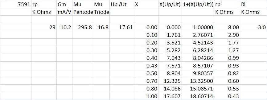

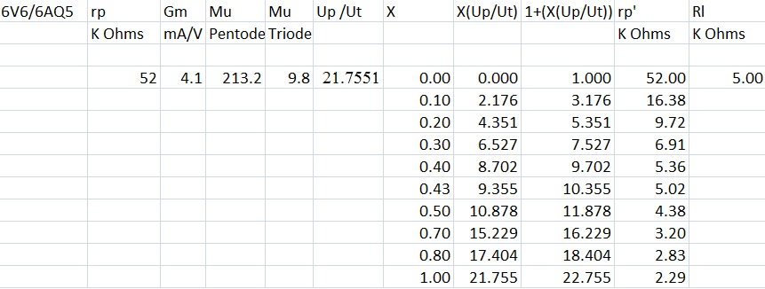

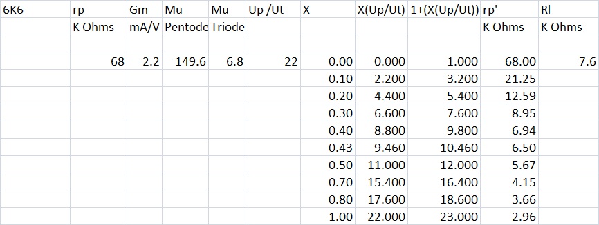

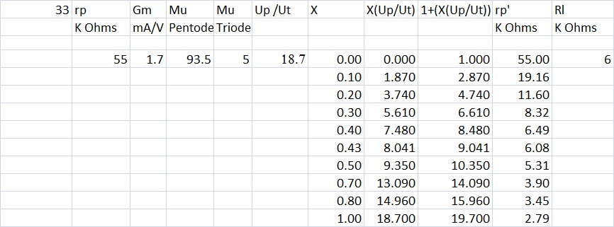

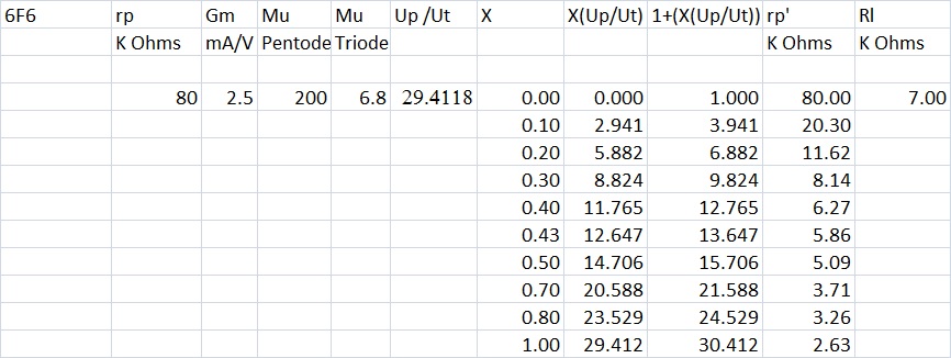

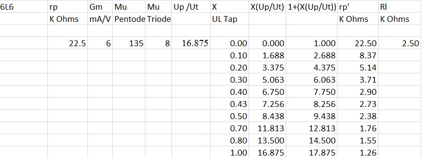

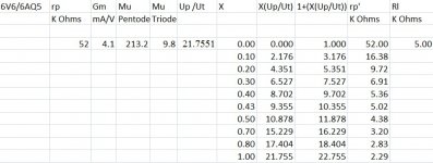

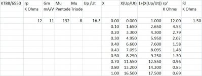

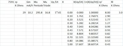

Williamson on Cathode & Screen FB
I posted these papers on the forum about a year ago, so here they are again for those who may have missed that time. Also some worked examples of screen FB results as applied to some common tubes.
Looks to be very effective, just 10% UL lowers the plate resistance by 90%.
DTN Williamson on Cathode & Screen FB

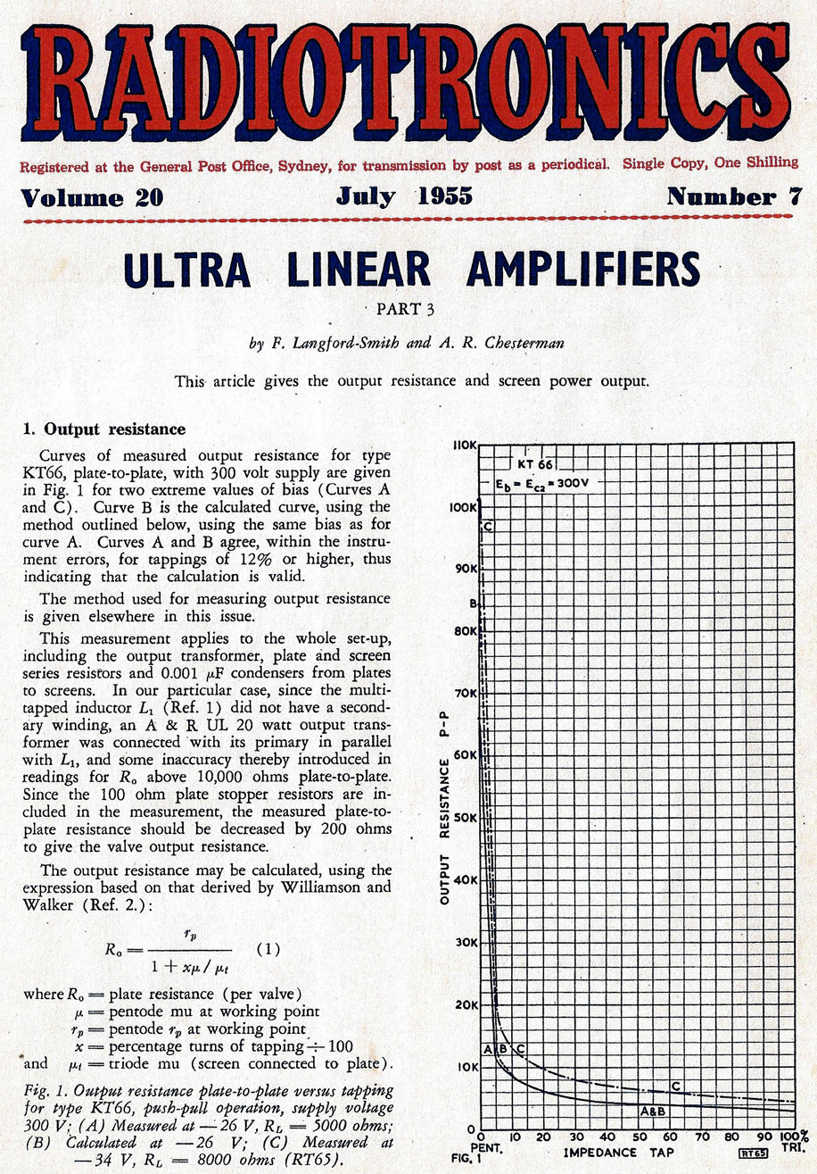

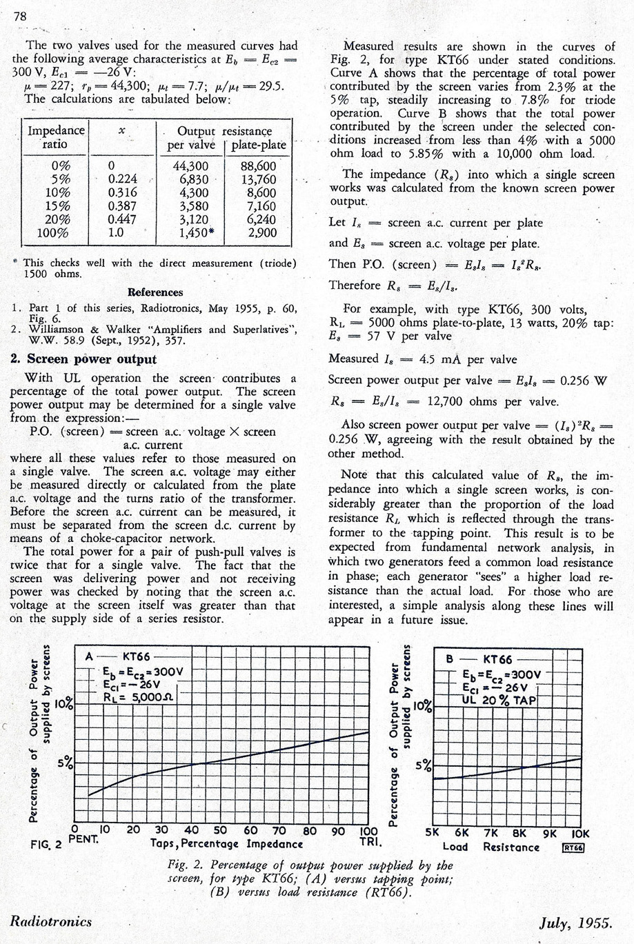

Calculation of Ultralinear Plate Resistance Radiotronics Magazine p1.jpg639.7 KB · Views: 123
Calculation of Ultralinear Plate Resistance Radiotronics Magazine p2.jpg580.6 KB · Views: 128

Thanks jhstewart9, very helpful, I will prepare an excel file like yours too.Looks to be very effective, just 10% UL lowers the plate resistance by 90%.
