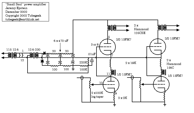

I built a single-ended 13FM7 amp, 1st triode for the voltage amp, second triode for the power amp, into Hammond 125ESE's. So two bottles for the whole amp (sand rectification.) The circuit is direct-coupled with a voltage doubler, B+ from the center for the voltage triode and B+ from the top for the power triode with a large bypassed cathode R biasing it. I'm trying to remember whether the voltage triode was choke-loaded or resitor-loaded. Anyway, the most expensive parts in the whole thing were probably the 12-pin sockets and it sounds quite good. If I dig I can find the schematic, email me at jeremyepstein AT earthlink DOT net if you are interested.
-j
Here it is, it WAS choke-loaded, with inexpensive Hammond power supply chokes. This design was meant to be VERY cheap to build and it certainly fit the bill. But it also sounds very good!
-j

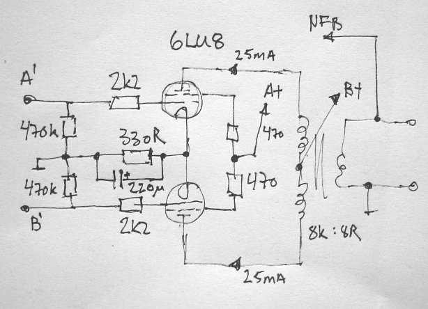

Here are my fist sketches for the 6LU8 sweep tube push pull amp.
Amplification in first stage is estimated to be 46x.
Voltage needed for the power stage is 16v peak (32v p-p).

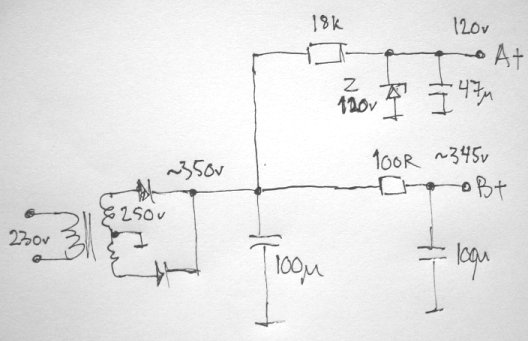

Screen voltage 120v.
20 watts at full drive I'll presume.
Any comments?

Even at the cost of two cathode bypass caps, I would split the common cathode bias resistor in the output circuit, and possibly add a means to trim idle current balance. It is after all a PP amp, why degrade performance by saturating the transformer via unbalanced idle current...
Good point!
No reason to saturate the OPT.

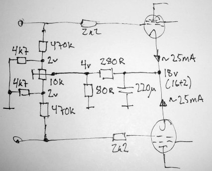

Maybe I could get away with one cap and a cheap (1/4w) trim pot if I do an implementation like this?
