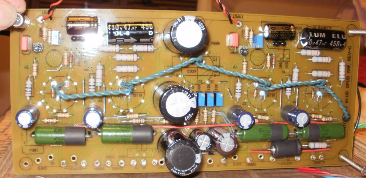

richwalters said:Interesting design......That 120V zener in the g2 supply: In a sim circuit I worked on I found them very noisy which was breaking into ajacent wiring. Perhaps I had another type but I was forced to use tube stabiliser.
Anyone using H.V zeners in circuits .. Which makes can be recommended ?
As you see in the circuit diagram, this zener is AC-shunted with 47µF, which is more than plenty (I would have used a single digit µF value) to short circuit any noise to gnd.
But I would have used 4x 30V Zeners or something in series instead, since those high voltage Zeners generally have a very bad temperature dependend behaviour (which means they drift in value while they heat up).
Voltage regulator tubes both have advantages and disadvantages. You can´t predict at which voltage they "fire" exactly (a few single volts up or down their nominal value) but they show much less voltage drift once "fired". And they produce less noise than Zeners, that is right.
Anyway, a few volts more or less, or a few micro-Volts of noise more or less, is nothing to worry about in such an app. I would turn my eye on reliability issues instead.
Tom
Tubes4e4 said:But I would have used 4x 30V Zeners or something in series instead, since those high voltage Zeners generally have a very bad temperature dependend behaviour (which means they drift in value while they heat up).
It’s actually 2x62v, most because it was hard to find 120v zeners. Noise, I can’t hear any and I can’t see any on my scope. 47uF is more than enough, but I had one side of one the 2x47u cans left, and I used that one to decouple the 120v. The 120v is not very critical, but higher voltage will give the tube more "drive".
A tube stabiliser had of course been more fancy for the eye. 😉
what i do in this case is i mount these diodes as close together as possible on the pcb and then coat them with silicon grease so they thermally track each other.😀

Hi Tony,
I tried a stack of zeners and ended up with the same positive temperature coefficient as the single 100V zener. 5W was a little better than 1W. The ambient temperature had a large effect too. So mount them in the coolest spot you can find.
Mine were used as the reference in a regulator, so I was able to use negative temperature coefficient resistors to compensate else where.
Do not use thermal grease, encourage as much cooling air flow as possible.
-Chris
-Chris
hi chris,
thanks for the tips..... i do operate my zener stack at a fraction of its rating so it does not really heat up that much.😀
May seem long-winded but one gets ideal breakdown performance. One of my favourite ones is to string loads of 5V1 zeners to the desired voltage and then epoxy the lot.. Has near zero temp drift at optimum 5V1 with brill temp cooef. A single h.v diode in soft avalanche breakdown has a dreadful spec.
