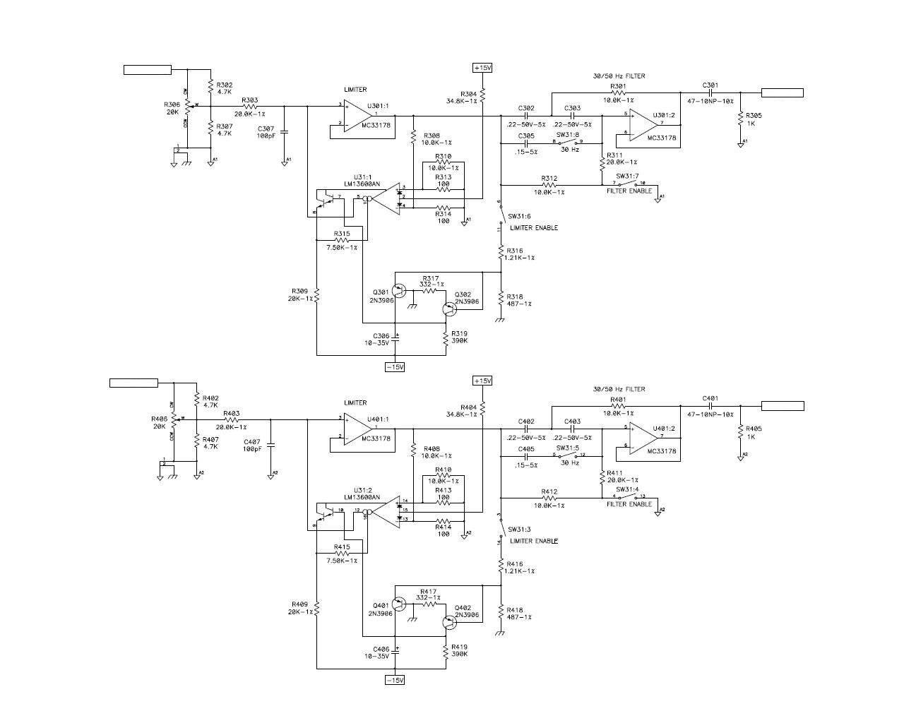

This Limiter circuit with low cut filter can be use with XLR circuit add on input.

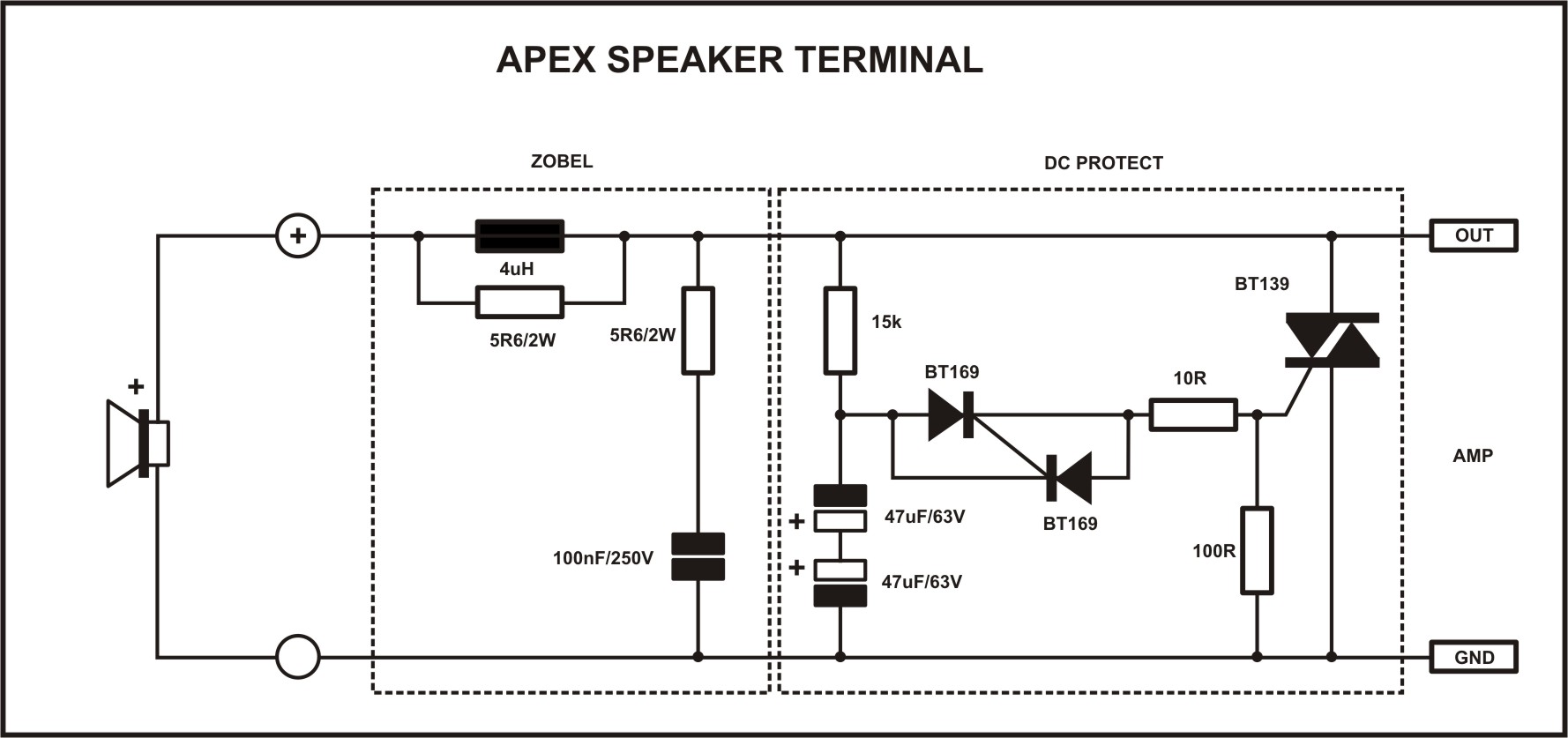

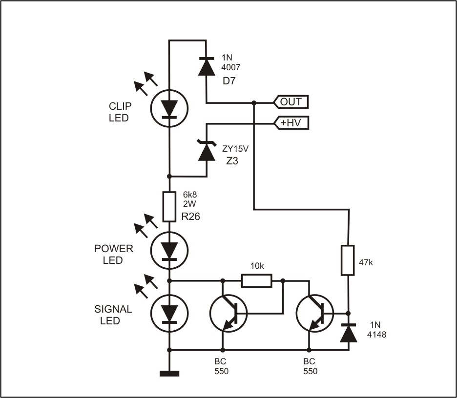

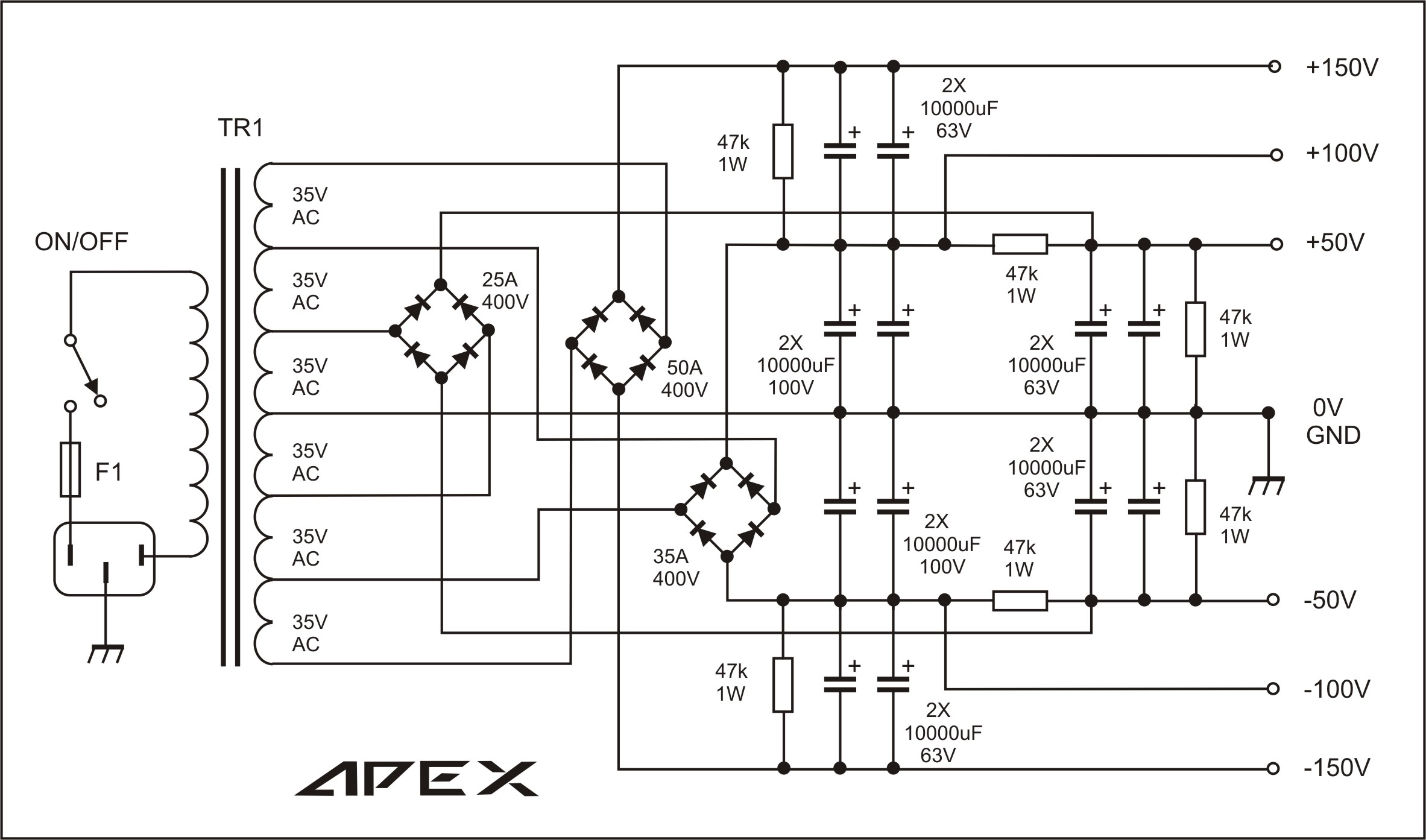

PSU for Vertex, signal+clip led and speaker terminal for double protect if relay blow up.
